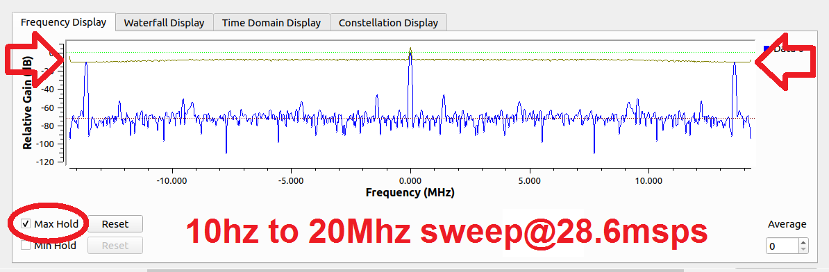

    9954tony discord did a frequency sweep test on a cx card (one of the chinese modern ones with pcie connector and pci bridge chip and bnc connectors.) if anyone is curious about that:

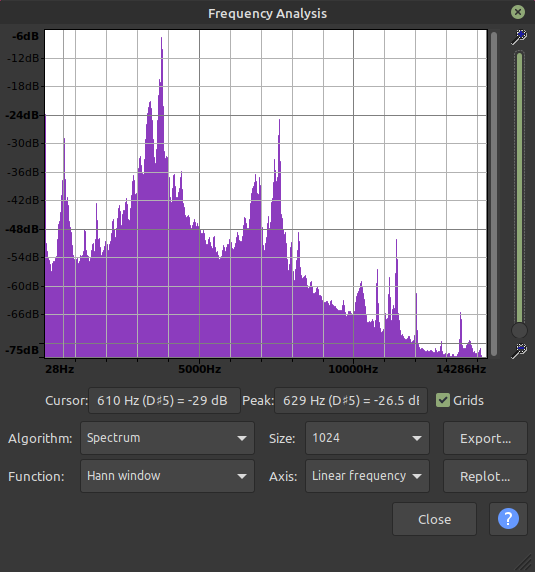

  15. Seeing these graphs, some boost is needed for the chroma band, and there are two residues of the HiFi FM track that might be causing issues.
    [ thinking about playing with the audacity EQ and expanders plugins ]
  16. Boost or calibration, need to check if the burst amplitude matches specs.

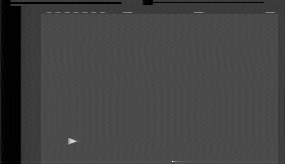

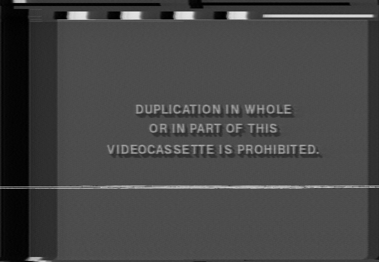

    Got two samples from retail tapes that can't decode. I assume different forms of MV are to blame.
    Galaxy Quest (US) = Unable to determine start of field - dropping field
    Small Soldiers (CA) = Unable to find any sync pulses, jumping 100 ms. On the spectrogram, I see that VSYNC rests above the normal frequency. Yesterday I read a data sheet that indicated sync in MV can be +10 IRE higher than normal, so maybe that's it.
