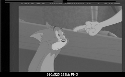

  2. Originally Posted by Brad View Post
    In general, vhs-decode seems to currently retain all detail, but adds some soft glow/smear. Not sure if different settings could help this.
    Yeah we're not quite there yet but it doesn't look too off. I think the different comes down a lot to the de-emphasis filtering, and to a lesser degree rf filters. Using
    -nld
    may help reduce the slight smeary effect on transitions a bit, that filtering still quite eyeballed still though. The main de-emphasis curve for VHS in vhs-decode currently looks reasonably close to the one in the specs, but not sure if it's entirely correct either.

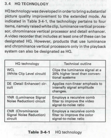

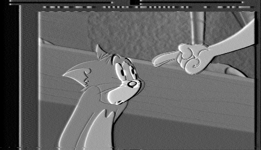

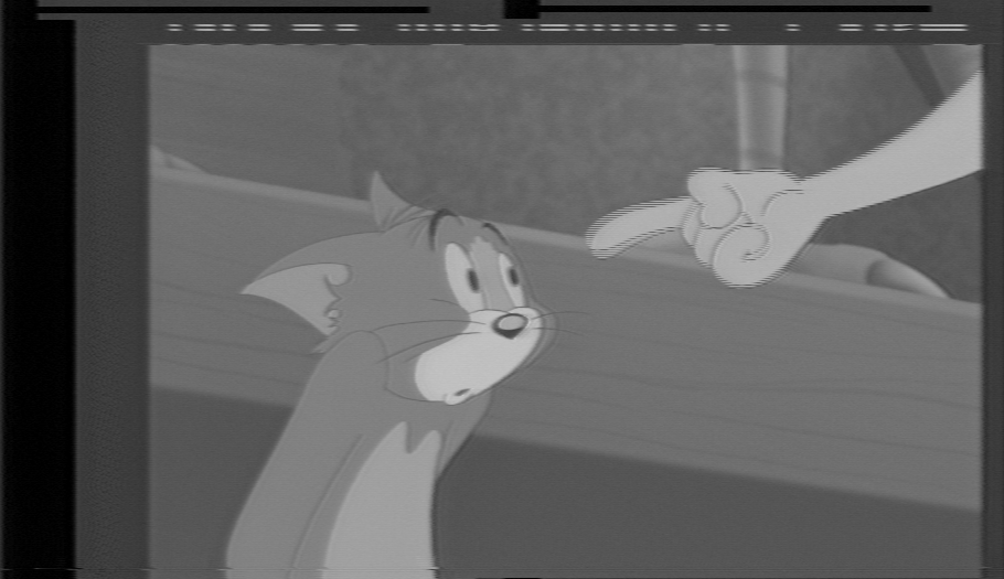

    When video is recorded on tape, the high frequencies are boosted a lot, and then reduced the same amount on playback. This helps reduce noise and retain detail, same concept was used for e.g fm radio, audio tape, broadcast tv and similar. The VHS spec started out with a standard de-emphasis curve with some minor leeway, but it seems manufacturers, including jvc themselves son started adding additional filtering including various forms of sharpening/emphasis/detail enhancement to squeeze out more "quality" from tapes. Detail enhancement is also a part of in VHS HQ. As you demonstrated in the comparison post you linked, the output ends up varying a bit between vcrs, so I don't know to what extent all this was standardized, and later decks also often had a degree of automatic adjustment of some of this on playback and recording.
    The JVC technical guide I've linked before also notes that non-linear de-emphasis was added in to make "extended mode" speeds work better, so I think those have a degree additional filtering. It's also used for SVHS and Hi8.
    Since we're software decoding here we can actually show how the raw demodulated picture looks before de-emphasis which may or may not be interesting:
    With current deemph in vhs-decode:
    With -nld option (crude non-linear de-emphasis):

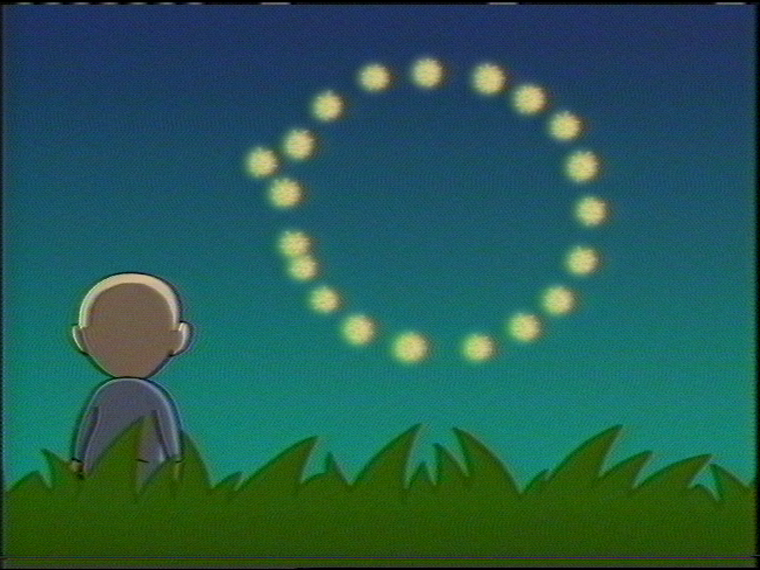

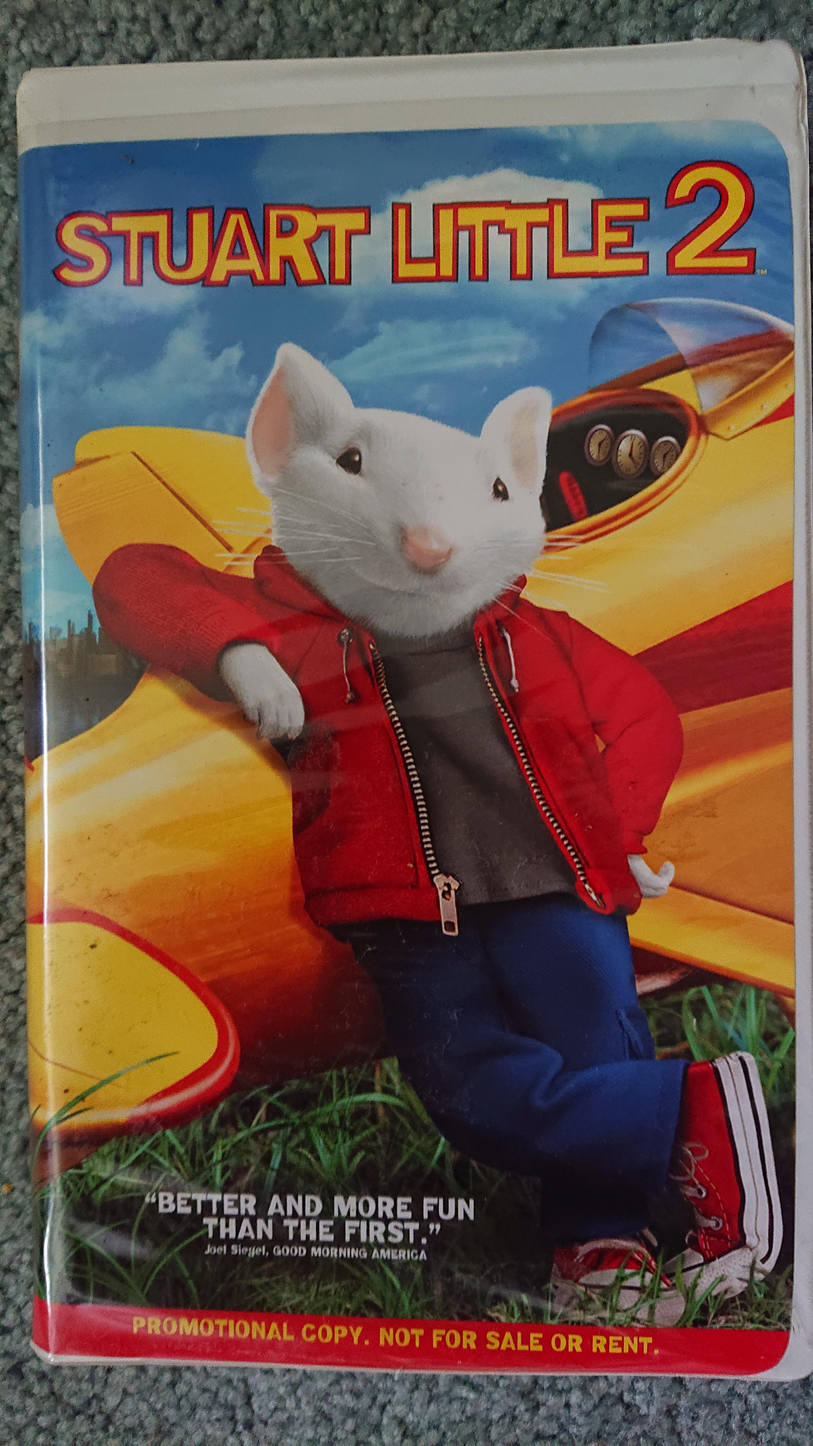

  3. Brad, that copy of SL2 I have is basically a retail release with all the same retail trailers you have. I just now verified as I had to disconnect and move my Laserdisc player from my capture PC and hook up my VCR. The only difference is a single added screen that states it's a promo copy. So yeah basically an apples to apples comparison with what you have. I can upload a capture of the trailers once decoded.
  4. Decoded. My results, with the sharpness level at 50, are pretty good but I have slightly more ghosting on the right edges. SNR averages to 36dB. And actually the SNR is slightly lower until some of the other trailers. So maybe some of these trailers were mastered in analog, reducing SNR due to analog signal losses. Same frames from two of those screenshots:
    I compressed my capture to FLAC with the below command. I'll share it if Brad uploads an example so we can compare SNR and other stuff. Other variables isolated, differences should only be due to different VCRs, different cables, my 13MHz low pass filter, and different capture cards. Amplification is at 31 as well.
    flac --best --sample-rate=48000 --sign=unsigned --channels=1 --endian=little --bps=8 -f stuart.r8 -o stuart.flac

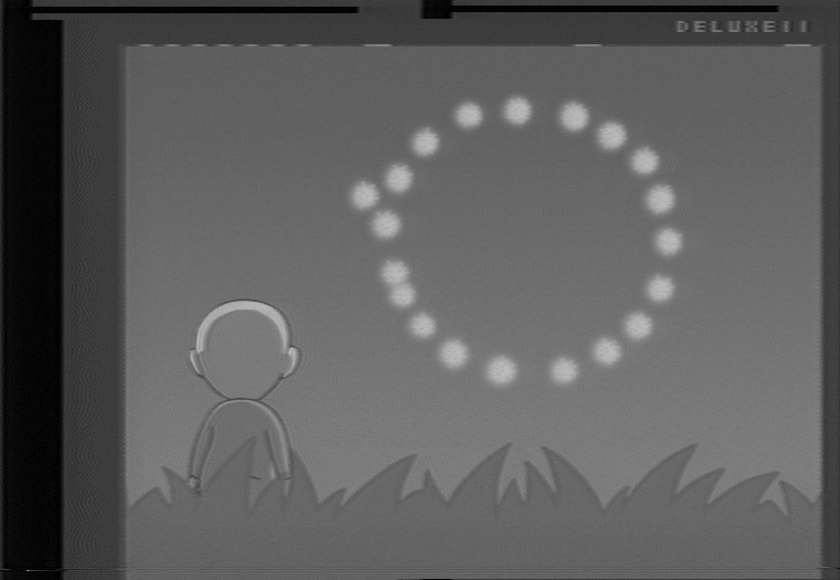

  5. Formerly 'vaporeon800' Brad's Avatar
    Apr 2001
    Vancouver, Canada

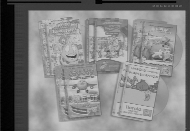

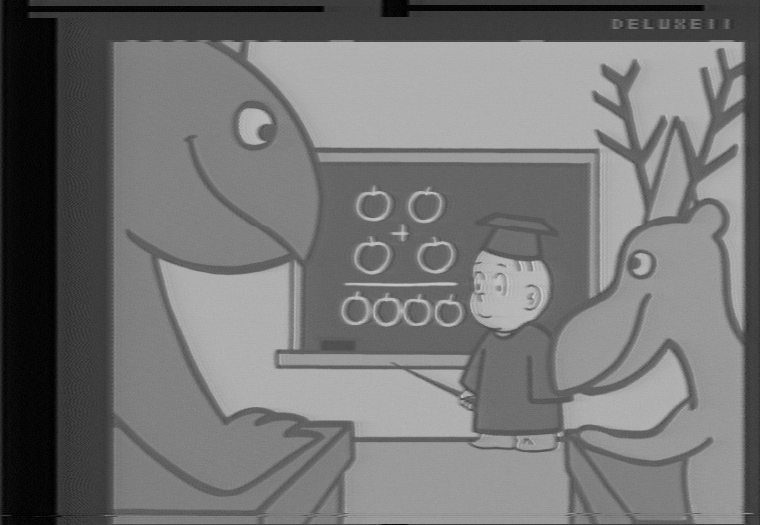

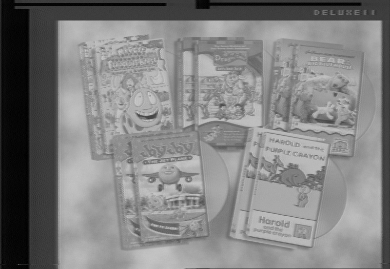

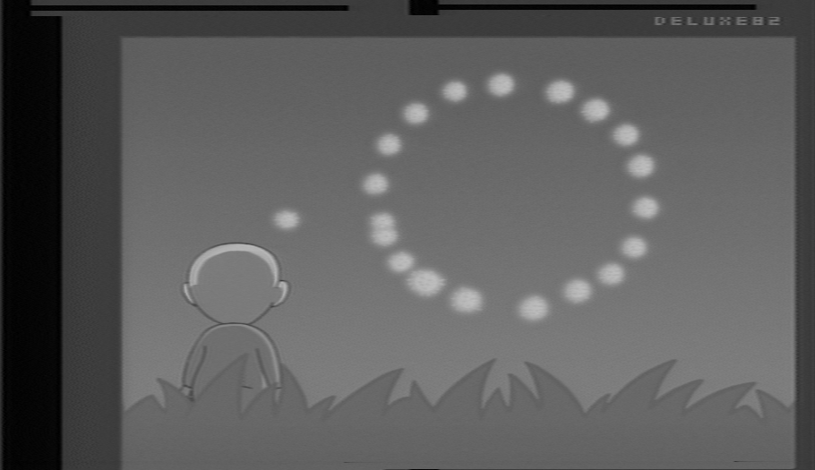

    My retail copy says DELUXE82 rather than DELUXE11 in the VBI, for whatever that's worth.
    Can't really see it in a still frame in ld-analyse, but if you decode and play back an MKV, there's high-frequency noise in this shot in my capture. Curious to see how yours compares.
    [Attachment 59439 - Click to enlarge]
    Trimmed two relevant portions to a more manageable filesize. Used ffplay as a quick double-check that I cut to the correct part, so I didn't have to do a decode.
    dd bs=28636363 skip=104 count=5 if=stuart2us_previews_1_pixelview.u8 of=sl2_pv_1.u8
    dd bs=28636363 skip=210 count=24 if=stuart2us_previews_1_pixelview.u8 of=sl2_pv_2.u8
    ffplay -hide_banner -async 1 -f rawvideo -pix_fmt gray8 -video_size 1820x525 -i sl2_pv_1.u8 -vf scale=910x525,eq=gamma=0.5:contrast=1.5
    flac --best --sample-rate=28636 --sign=unsigned --channels=1 --endian=little --bps=8 --blocksize=65535 --lax -f sl2_pv_1.u8 -o sl2_pv_1.vhs.flac

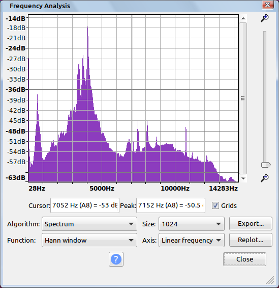

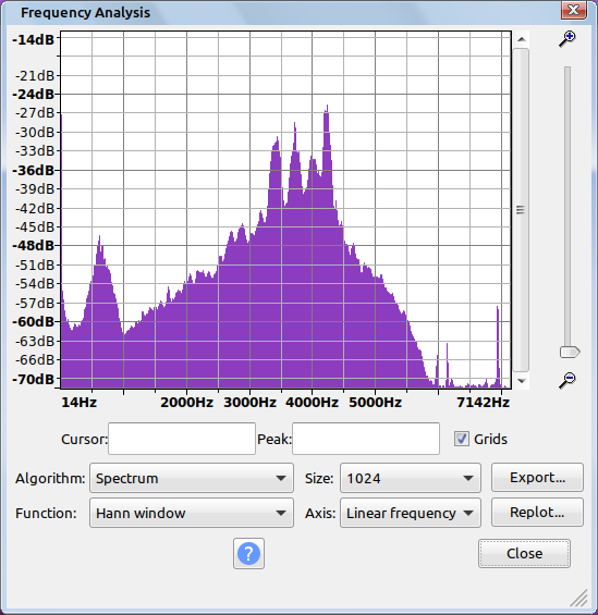

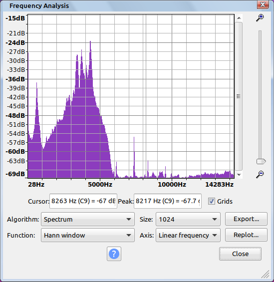

  6. Interesting. I'll compare the spectrum and decoding results for those scenes.
  7. Your results are on average 5dB higher in SNR than mine. My picture is noticeably more noisy. Comparing luma, chroma, and combined frames:
    Mine:
    Yours:
    Mine:
    Yours:

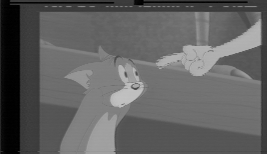

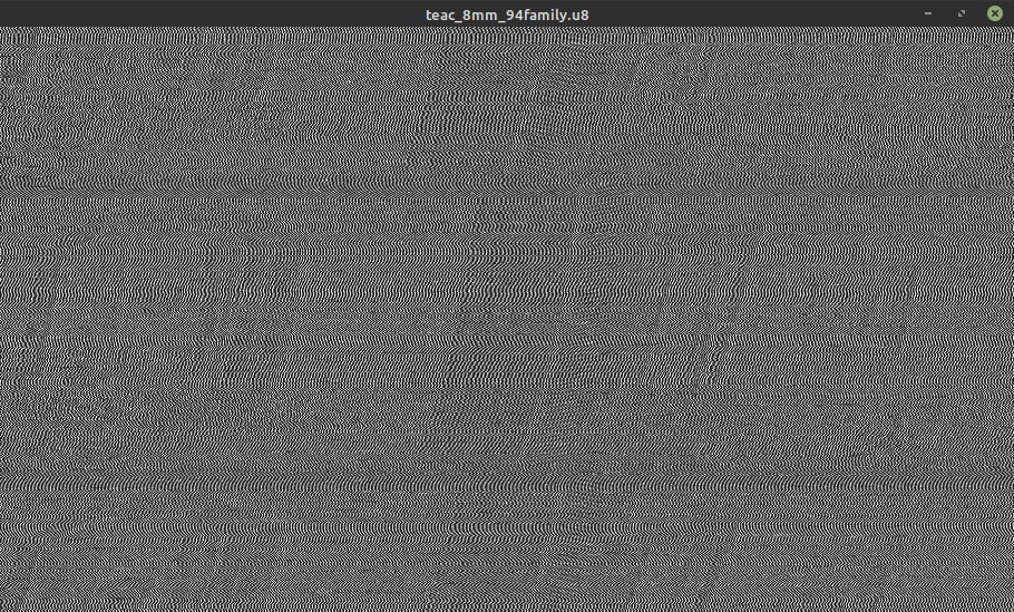

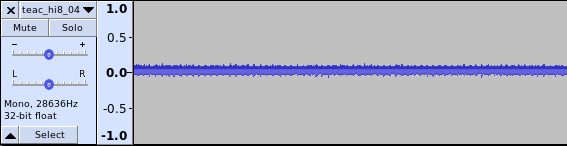

    Finally got around to trying the front test points on the TEAC V-800G-F Hi8 deck, but the output level is insanely weak. This is with level=31. Meanwhile, the SW P test point (head switch pulse) outputs a very strong signal.
    [Attachment 59450 - Click to enlarge]
    ffplay with contrast=15 (normally use 1.5)
    [Attachment 59449 - Click to enlarge]
    I'm attaching the samples anyway, in case they are of some use.

    Looking at this frame/field of video between our two captures:
    My spectrum plot:
    Your spectrum plot:
    You appear to be capturing a bit more bandwidth. That would explain the extra sharpness. The luma waveform in you capture seems fatter. And I do think it's your VCR because of the Beast Wars sample as well, which still impresses me in terms of sharpness as I have been unable to match that with my two VCRs. Yes our tapes aren't from the exact same master, but my machine is made in China and is two years newer, right when DVD was starting to take over and cost cutting measures were hitting VCRs. I've been doing these comparisons with the sl=50 flag for sharpness level 50. I'm assuming that's what you used for Beast Wars.

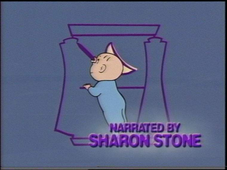

  15. Formerly 'vaporeon800' Brad's Avatar
    Apr 2001
    Vancouver, Canada

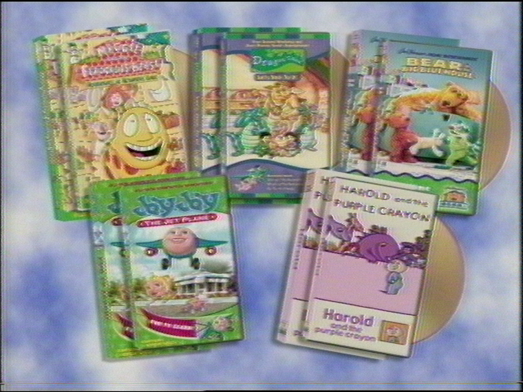

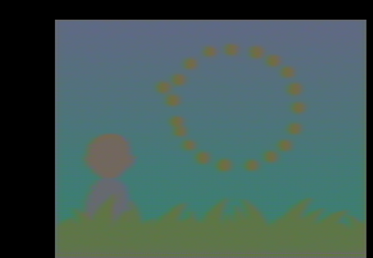

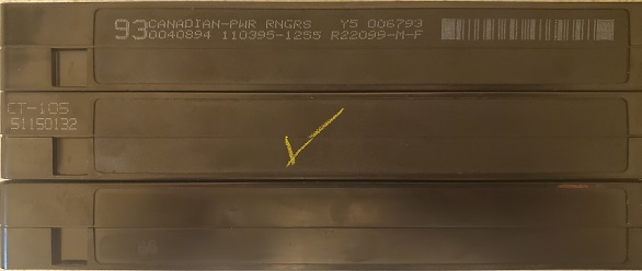

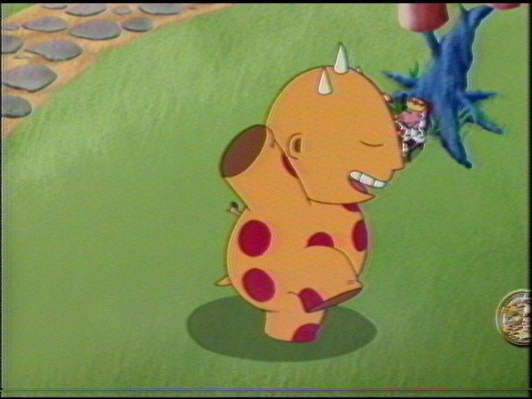

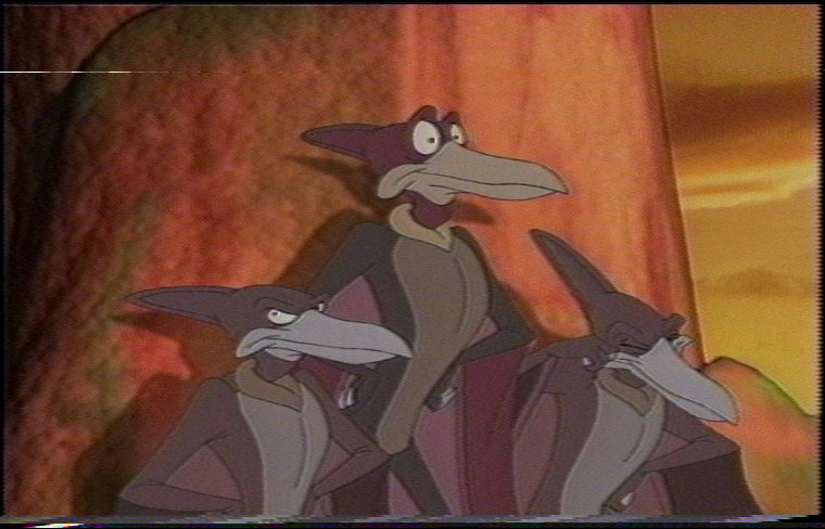

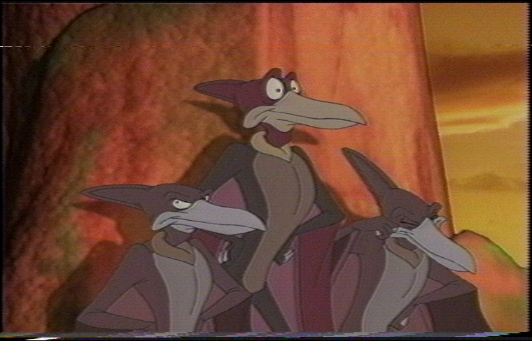

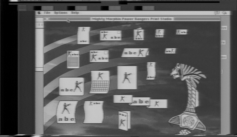

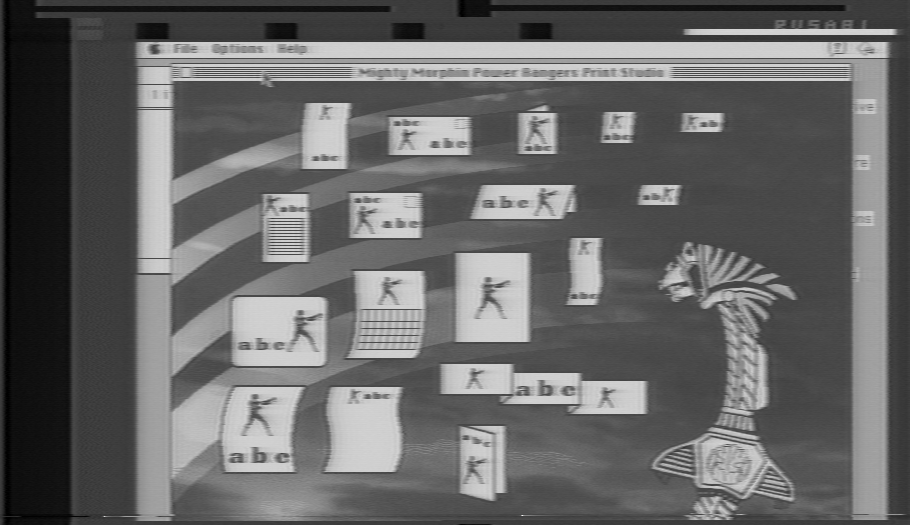

    I have three copies of one movie release: two Canadian and one US. My original plan with them was to Median them together in order to remove dropouts. (Open matte version is only on VHS and VCD.)
    Instead I've found that they're not really the same.
    A (CA)
    [Attachment 59517 - Click to enlarge]
    B (CA)
    [Attachment 59518 - Click to enlarge]
    C (US)
    [Attachment 59519 - Click to enlarge]
    Same vhs-decode options for all three:
    ~/./vhs-decode/vhs-decode -t 4 --10cxadc -n --noAGC mmpr_A_2.u16 mmpr_A_2
    More image comparisons:
    https://imgsli.com/NTg3MTU
    https://imgsli.com/NTg3MTY
    Notes:
    • "C" looks the best. "B" decodes with the most contrast for some reason, but the edges are downright ugly and I see extra noise on the "Create-A-Movie" cover.
    • Both CA's exhibit the same slight horizontal squish in comparison to the US.
    • Each tape has its own form of Macrovision. The US copy doesn't have the white HBI block. "B" has the longest white VBI line, on "C" it's shorter, and on "A" it's non-existent.
    • "B" has an extra data code above the Macrovision VBI.

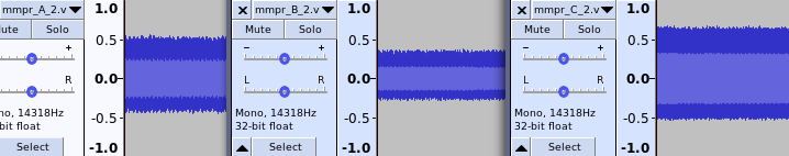

    It's sort of nutty how big of a difference there is in the RF levels. I captured them one after the other, all at level 31.
    [Attachment 59525 - Click to enlarge]
    EDIT: Attached MKVs of the three samples.

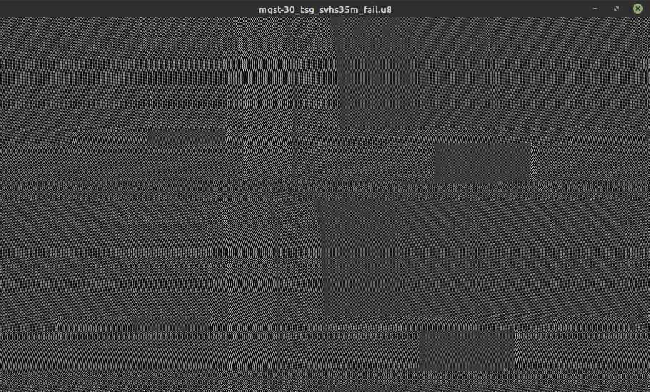

    Here's a potential NTSC S-VHS sample, which causes vhs-decode to immediately barf. I don't know if this RF is accurate, since the SLV-779HF is just a plain VCR without even SQPB. And the CX cards may not have sufficient bandwidth? But a signal is there.
    ~/./vhs-decode/vhs-decode -t 4 --cxadc3 -n --noAGC -tf "SVHS" mqst-30_tsg_sp.svhs35m_fail.flac mqst-30_tsg_sp.svhs35m_fail
    NTSC SVHS has not been tested yet!
    /usr/local/lib/python3.8/dist-packages/numpy/core/fromnumeric.py:87: RuntimeWarning: overflow encountered in reduce
      return ufunc.reduce(obj, axis, dtype, out, **passkwargs)
    /usr/local/lib/python3.8/dist-packages/numpy/core/fromnumeric.py:87: RuntimeWarning: invalid value encountered in reduce
    /usr/local/lib/python3.8/dist-packages/scipy/signal/filter_design.py:2555: RuntimeWarning: invalid value encountered in true_divide
      k_z = k * real(prod(fs2 - z) / prod(fs2 - p)

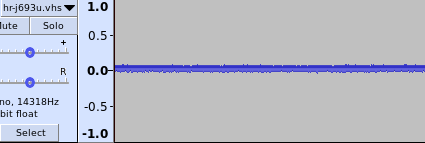

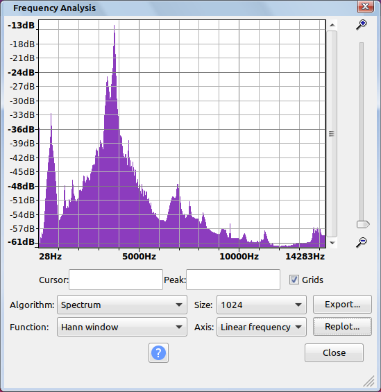

  18. It works for you? I tried a TBC file once which I believe is unsigned 16-bit. Perhaps the padded 10-bit samples are actually signed 16-bit then. Thanks, I'll have try it.
    I actually had this S-VHS idea recently myself. My VCR supports super quasi playback, but I couldn't find any reasonably priced prerecorded S-VHS material on eBay to test it with. I then came to learn it mostly sold as blank tapes with very few prerecorded titles. I also wonder what the limiting factor is with S-VHS compatibility. Is it the RF frequencies or bandwidth both being higher? Or is it the demodulation and decoding circuitry in standard VCRs? Do SQPB VCRs demodulate the higher bandwidth luma signal then band limit the output back down to 3MHz due to the VHS specification? Clearly you have something there in your capture from your VHS machine.

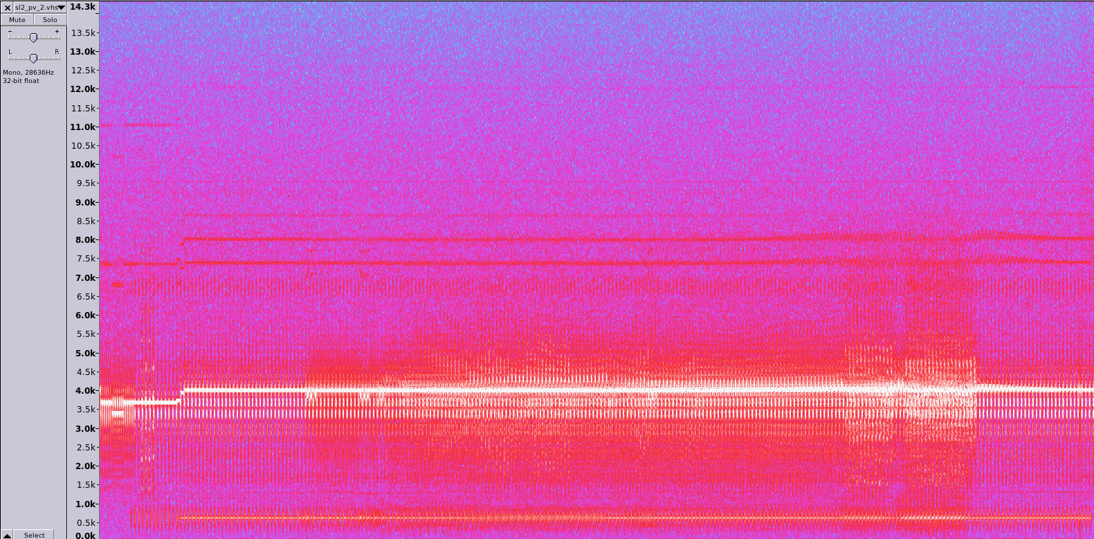

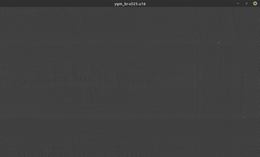

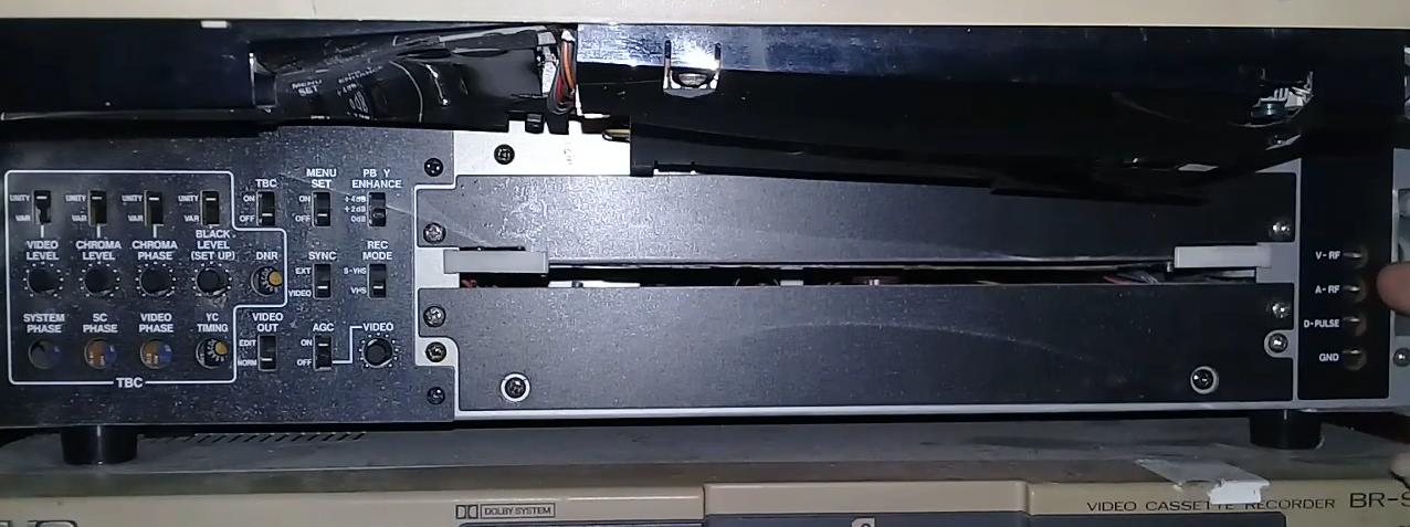

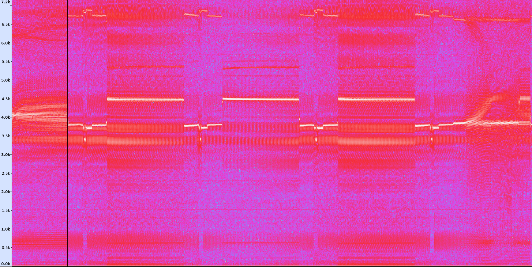

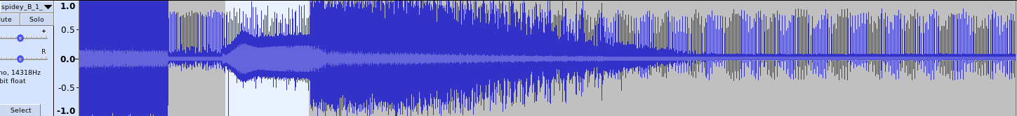

    My JVC BR-S525U has front panel test points for V-RF, A-RF, D-PULSE, and GND. A bunch of models in this range have the same feature. The layout is like this BR-S822E shown on YouTube.
    [Attachment 59581 - Click to enlarge]
    Unfortunately, my unit developed a loading problem years ago. At the start of these two Audacity screenshots we see Stand By. Then there's a brief moment of playback, before Error Code 71 showed on the front panel and the signal winds down.
    [Attachment 59577 - Click to enlarge]
    [Attachment 59578 - Click to enlarge]
    I assume the square wave near 1.5MHz is the 30Hz head-switch pulse?
    Instead of posting that clip, which was just blackness at the start of Spider-Man, I've attached a short sample of You've Got Mail briefly playing a recognizable image.
    In both cases, the captured RF is lower in amplitude than the Sony.

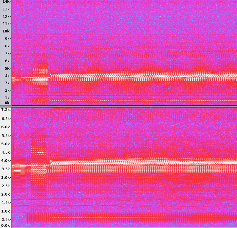

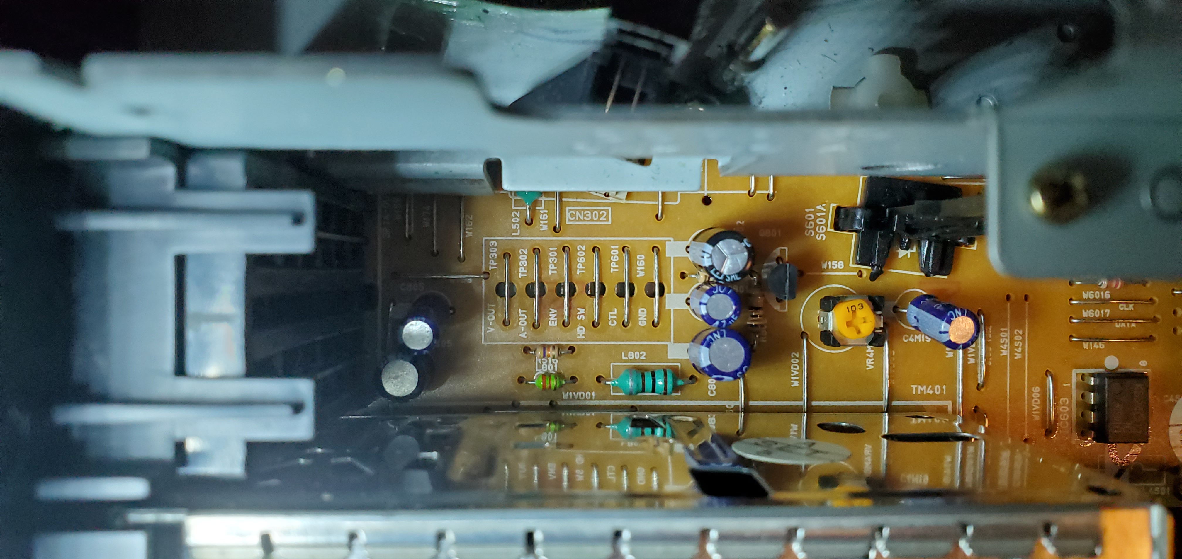

    Next VCR test. Samsung VR8419C test points are super straightforward:
    [Attachment 59593 - Click to enlarge]

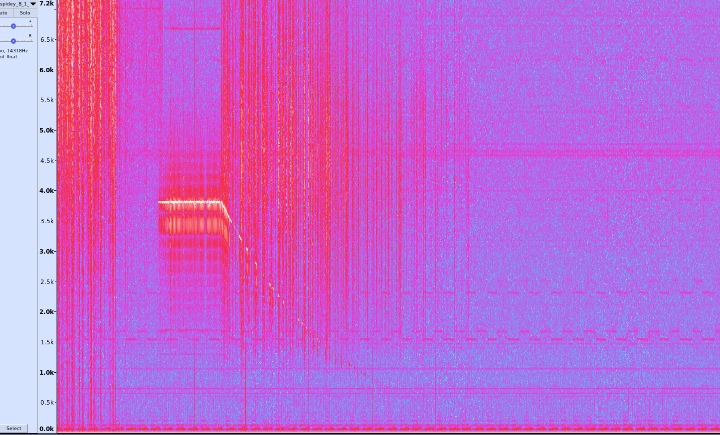

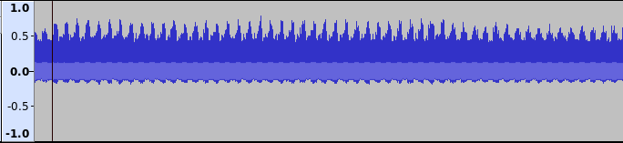

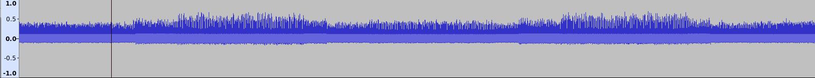

    Unfortunately, the signal I'm getting is weird. The waveform varies in intensity in a periodic manner, and it's off-centre.
    [Attachment 59594 - Click to enlarge]
    [Attachment 59595 - Click to enlarge]
    [Attachment 59596 - Click to enlarge]
    I see a literal reflection in the spectrogram; a weaker copy of the signal upside-down and above the original. Is this what people mean when they talk about signal reflections? I thought they were copies but not inverted.
    vhs-decode manages to turn it into something, but it's very chaotic.

  23. Formerly 'vaporeon800' Brad's Avatar
    Apr 2001
    Vancouver, Canada
    JVC HR-J693U. Again, nicely-labelled and arranged test points. But the RF output level is even lower than the TEAC Hi8. The audio FM isn't much higher.
    1-second samples from all test points, all at level=31.
Name:	hr-j693u test points.jpg
Name:	hr-j693u waveform.png

  24. Yeah that JVC must be crap for RF capture. Your Hi-Fi test point is extremely noisy and there are other signals aliasing (corrupting) your two audio tracks at 1.3MHz and 1.7MHz.
  25. The ~5MHz LPF came in. Using sharpness level 50, SNR for me did increase from 36dB to 42dB with the filter in place, with and without the 10-bit mode. It also eliminated some squiggly patterns, but now I've got the dreaded luma/chroma crosstalk diamond pattern. I can't explain why, as the filter should not have affected that aspect since the guard band between chroma and luma is further down the spectrum. 8-bit first and 10-bit second for all screenshots:
    Also, my 10-bit sample crashed vhs-decode so it didn't finish. This sample and and terminal output are below.
    https://www.mediafire.com/file/egbosrdk1iuj7fd/5mhzfilter10bit.flac/file

    I'm seeing squiggles, but not diamonds/crosshatch in those two images.
    My YouTube channel with little clips: vhs-decode, comparing TBC, etc.
  27. It's hard to see but noticeable when the video is actually playing. I should try and reproduce that with another tape to rule out the tape itself.
  28. Someone on discord got a similar effect crosshatch pattern (with those sharp lines, a bit different from the low-frequency one brad had) when capturing with a ddd, using --high_boost 0 reducing the boost to high rf frequencies helped. the high frequency boost can help reduce streaking, especially on bad tapes on cxadc captures, but it can also end up boosting noise a bit much. Maybe the altered frequency response from the filter results in changes that reduces the need for the high frequency boosting.
  29. Good observation. I looked very carefully at the spectrum between luma and chroma and saw nothing that looked like that soft crosstalk. But, there is that thin line/spike right above my luma cutoff using the filter. Maybe the filtering in vhs-decode is picking up that spike, causing the noise in the picture. Is there an adjustment I can make? I disabled the sharpness entirely but still see that noise a bit. The SNR improved with the filter so that's progress. That spike was previously drowned out by the luma's upper sideband. My filter is a bit aggressive too though with 50dB stop band rejection, maybe too much so. It's a metal device sealed with plumbing solder, so it may be homemade for HAM radio.
  30. Formerly 'vaporeon800' Brad's Avatar
    Apr 2001
    Vancouver, Canada
    "Crafter's Workshop". The recordings both before and after this on the same tape are normal.
    Overly-bright cartoon. The Sailor Moon clip at the end has normal levels.
