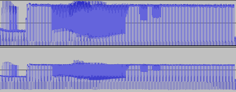

  9. I got the driver working. I ran the level adjustment tool using ./leveladj 31. I did a blank test recording connected to an unpowered s-video device. Besides the fact that my s-video cable sucks creating noise, the zero point is way off from DC center. Any suggestions?
  10. I think I've put two and two together now. I hooked up a Roku box, ran the level adjustment tool with it turned on, chose level 19 with 0 low and high closest to 255, and captured a few fields of luma video. I opened this in Audacity and it looked good, but the lines were being clipped a bit at the top. At this point I realized "clipped" has to read 0. So I then chose level 6 which doesn't have as much dynamic range, but does not clip. Here are some Audacity screenshots, the first waveform being level 19 and second being level 6. My understanding of the goal is to get as much dynamic range as possible (low being 0 and high being closest to 255) without clipping. Do I have the gist of this?
    And here are both samples loaded respectively in the RawSource AviSynth filter running in Wine:
    With either case, the picture looks REALLY clean.
