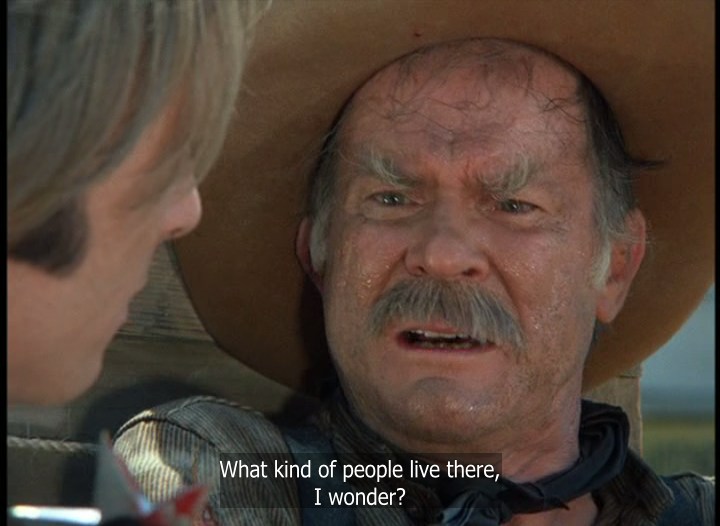

  1. Hello, dear all.

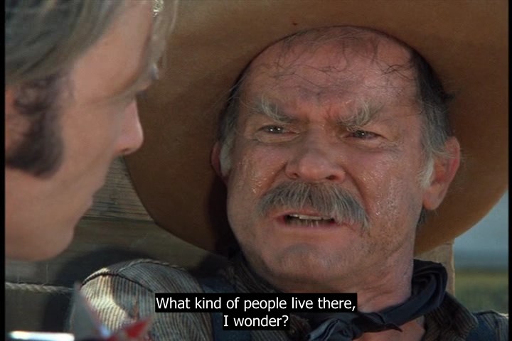

    Does it possible create subtitles like this one below?
    [Attachment 49917 - Click to enlarge]
    The letter is "surrounded" by a kind of transparent / translucent black rectangle ( or maybe even possible apply other colors too ) frame.
    Notice: such transparent / translucent rectangle black frame allow the audience see the video behind it. Only the letters are enhanced / highlighted because of the contrast of it's colors and the frame itself.
    The purpose of such frame is make the letter become very clear / sharp for reading no matter video color / movement changes.
    Such kind of subtitle is hard to be done?
    I guess ( if it is possible ) ASS format can do something like that.
    If you could point some settings and programs it will be nice.
    Thanks for your time!
    Best regards.

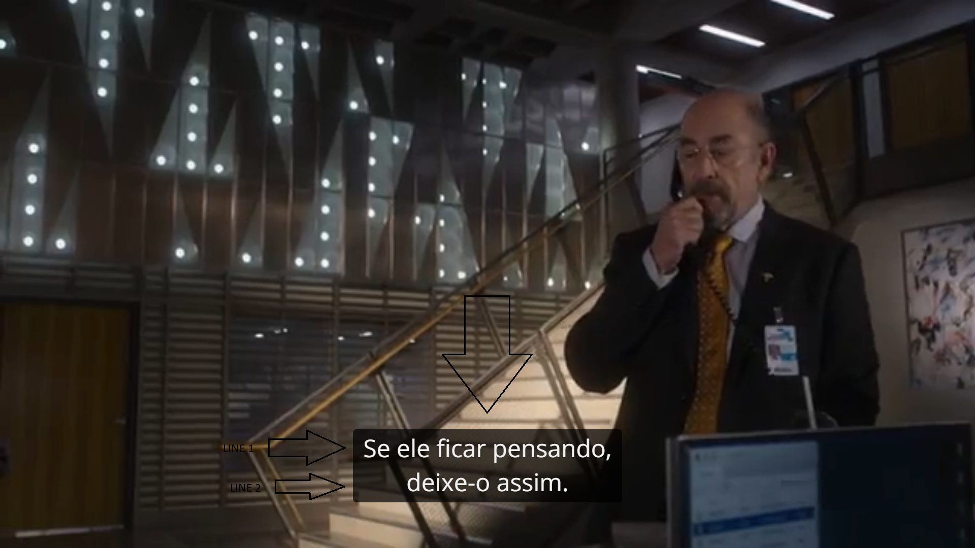

  5. Hi, dear all.
    The sample I showed before is from an online site that I bought a subscription service, just like Netflix.
    I wonder how they create such kind of subtitling "system" or "type", because we can choose the videos and turn off and turn on the subtitles. In many languages. They are on line streaming videos.
    I would like to create ( if it's possible ) subtitles similar those ones!

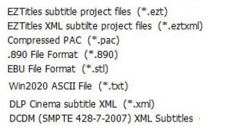

    Those subtitles are maybe graphic based subs? Or maybe are they based something like xml subtitle format?
    I know that we have professional subtitling formats, like EBU-TT-D, EBU-standard and Teletext “.stl” and others, created by tools like Cavena Tempo, Softni, EZTitles and similar ones. Maybe such professional subtitling formats can do it. Maybe not.
    [Attachment 49918 - Click to enlarge]
    ---> https://www.bbc.com/academy-guides/how-do-i-create-subtitles
    ---> https://bbc.github.io/subtitle-guidelines/

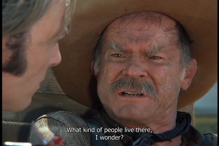

  6. Just for fun... AVS technique with SSA adapted for a semi transparent background.
    Normal SSA:
    [Attachment 49920 - Click to enlarge]
    SSA with solid background:
    [Attachment 49921 - Click to enlarge]

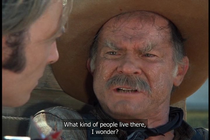

    SSA with semi transparent background via AVS:
    [Attachment 49922 - Click to enlarge]
    AviSource("video.avi")
    Black = BlankClip(last, color=$000000)
    White = BlankClip(last, color=$FFFFFF).ColorYUV(off_y=20) # force white to superwhite (Y=235 to Y=255)
    bmask = TextSub(white, "video2.ssa", 0, 0).mt_binarize(254, true).mt_expand().mt_expand().mt_expand().mt_expand(chroma="-128")
    Overlay(last, black, opacity=0.40, mask=bmask) # expanded black box
    TextSub("video.ssa") # write subs
    video.ssa is the sub with transparent backgroud.

  12. Ok. In Aegisub's Styles Manager edit the Default style of the script. Set shadow width to 0. In the Outline color selector set some Alpha for transparency. Save to .ass file. Edit .ass file with e.g. notepad or other simple text editor to set BorderStyle to 4. Then either mux with video to .mkv using MKVToolNix or leave them as external (fonts can be added as mkv attachments). Then VLC and mpv should be able to display them how you want.
  13. I can verify BorderStyle 4 along with an alpha in the BackColor works in VLC and SMPlayer. It didn't work in MPCHC, MPCBE, PotPlayer, or KMPlayer. And outside a PC almost nothing supports SSA subs.

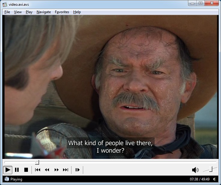

    MPCHC playing AVS script:
    [Attachment 49925 - Click to enlarge]
  16. assfiltermod adds libass rendering to MPC-HC, and possibly some other players when used with madvr (it uses the "home-brew" SubRenderIntf - few renderers use that)
    It's not like MPC-HC doesn't support ASS, it's just that BorderStyle=4 is kind of a thing only libass implemented. The author of Media Player Classic designed SSA and vsfilter IIRC.
