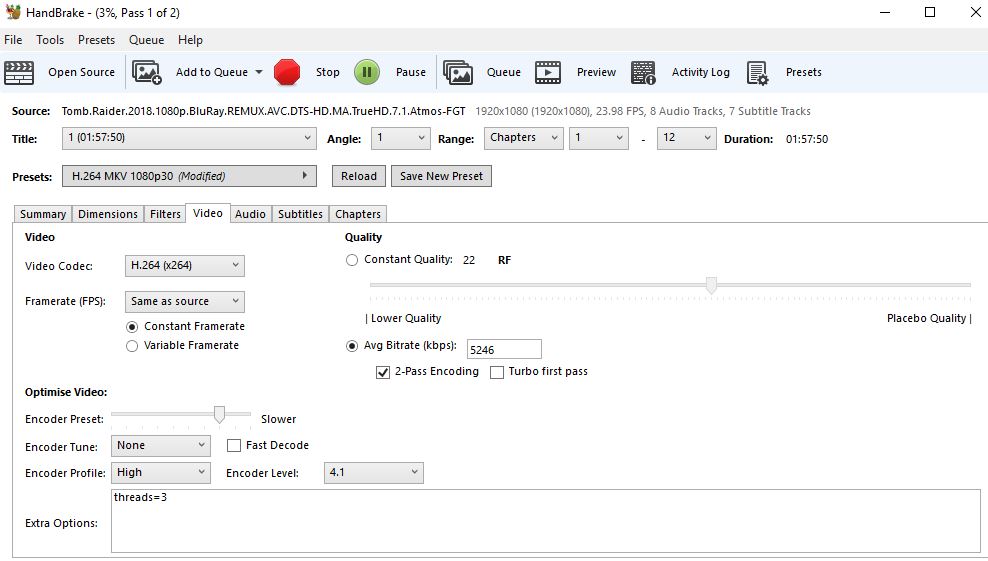

    Any number of threads is safe. But what do you mean by 68/92%? 68 percent at 2 thread, 92 percent at 3? Keep in mind that the thread limit is for x264 only. Handbrake is also using threads for decoding the source, filtering, etc. Those are usually small compared to the encoding but they can be more substantial if you are using very fast encoder settings.

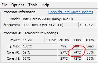

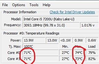

    Is it OK? that is in red I mean when I did the first three encodes the max temp was 73c without put threads 3 and full load, and now as you can see is 74c suddenly

    And I use this configuration

  4. And you're working in a temperature controlled test facility with reproducible conditions? Or maybe your office was a few degrees warmer when you tested that time. A few degrees one way or another doesn't make any difference and is within the margin of error.

    How many times do you have to be told? ~70 C is not a problem for that CPU.
