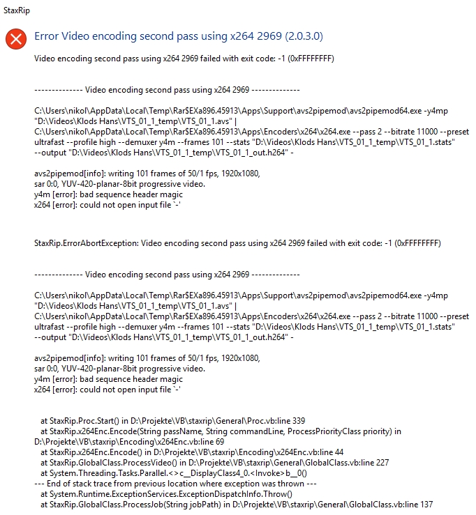

Please help. I have the latest version of Staxrip and Avisyinth+ with it. I saw a preview of my video and I personally think that mClean does a great job, but when it starts to encode the 2 pass it crashes. I don't know how to fix it. If there is a better denosing algorithm please tell, but I do prefer mClean right now.

Is there an error message?
Check the log file for messages
Are you computer temperatures ok ? overheating ?
Does it encode ok without mclean ? -
It encodes just fine without the mClean filter and no my computer doesn't get hot. Here's a screenshot of the error message. Just to clarify this was just a test so I could show you guys the error message. My actually video is 30 minutes while this was 2 seconds.
[Attachment 49911 - Click to enlarge] -
Can you post the actual log file ? There should be more information. It should be a text file somewhere
That error message is for the 2nd pass. That suggests the 1st pass completed - If that's true, then mClean isn't the problem -
It looks like the wrong log . This one uses x265, and it completes the 2nd pass

This one should be with x264 -
I'm sorry i'm really new to all of this. wait a little bit and I'll find one
https://forum.videohelp.com/attachment.php?attachmentid=49916&stc=1&d=1566681495
I cut the video to 10 seconds. This video was originally 30 minutes, but it still fails with mClean -
I don't know .
The 1st pass doesn't complete. I've never seen the "bad sequence header magic" error . There is some issue before x264 gets the data. It doesn't make sense because other encodes complete using the same tool chain
What versions of avisynth and avs2pipemod are being used? Maybe try updating themCode:avs2pipemod[info]: writing 476 frames of 50/1 fps, 1920x1080, sar 0:0, YUV-420-planar-8bit progressive video. y4m [error]: bad sequence header magic x264 [error]: could not open input file `-'
Take "D:\Videos\Klods Hans\VTS_01_1_temp\VTS_01_1.avs" , and open that in vdub2 . Scrub through the timeline and check if there are any error message
Code:MPEG2Source("D:\Videos\Klods Hans\VTS_01_1_temp\VTS_01_1.d2v") QTGMC(Preset = "Medium") mClean() nnedi3_rpow2(rfactor=2,cshift="lanczosresize",fwidth=1920,fheight=1080) Trim(0, 475) -
I don't remember having seen 'bad sequence header magic' before. For 8 bit input you can disable the piping tool in the x264 options Other tab, x264 supports 8 bit avs input, no need for piping in this case. I just recently made avs2pipemod the default in 2.0.3.0 because x264 don't support 10 bit input, it only supports 8 bit and 16 bit input. Alternatively to no piping tool and avs2pipemod you can also choose ffmpeg as piping tool, like avs2pipemod this supports both 8 bit and 10 bit input.

I just think it's weird that mClean is what is causing it. Tried it without and it works just fine -
It works ok with mclean for me, using avs+ r2772 , avs2pipemod64 1.1.1 , same script on a PAL source like yours, just using the commandline to x264 r2935
Maybe issues with that specific x264 binary -

Have you tried the script in Virtualdub2 to see if it works properly (this was already suggested by poisondeathray above)
Virtualdub2 will open the script via avifile api just like the staxrip preview, the staxrip preview adds converttorgb and convertbits 8
I tried running the script in virtualdub2 and It seemed to work fine.
But bigger news is that the mClean filter seems to work with the "Quality" preset on staxrip. I used 2 pass before
2 pass only works sometimes with the mClean filter. I'm not sure why. I'm guessing it's fine to just use the "Quality" preset as it seems it does as good as 2 pass, but I could be wrong. -
