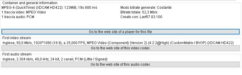

    please consider this source that have only 1 audio track (with 2 stereo channels) correctly loaded (with video) in avisynth:
    https://www.dropbox.com/s/uzuqgmlykcor2o0/input1_2.mov?dl=0
    [Attachment 49899 - Click to enlarge]
    vid=LWLibavVideoSource("C:\Users\Administrator\Desktop\Nuova cartella (7)\input1_2.mov")
    aud=LWLibavAudioSource("C:\Users\Administrator\Desktop\Nuova cartella (7)\input1_2.mov")
    left=GetChannel(aud, 1)
    right=GetChannel(aud, 2)
    both=mergechannels(left, right)
    audiodub(vid, both)
    ConvertAudioTo16Bit()
    and all is ok

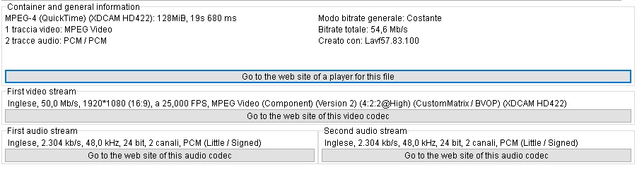

    But now I have another source: is the same but with another audio track (in total are 2 audio tracks, and each one have 2 audio channels)
    https://www.dropbox.com/s/h2x204v9csf7io2/input1_2_3_4.mov?dl=0
    [Attachment 49900 - Click to enlarge]
    How to load the second audio track in avisynth?!?
    How can I do the script so avisynth expose the 2 audio tracks?
    thanks

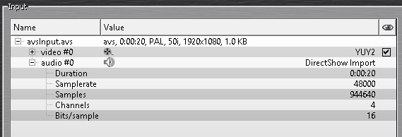

  9. Image
    [Attachment 49903 - Click to enlarge]
    audPair1=LWLibavAudioSource("spaceForInputFileNameAudio", stream_index=0)
    audPair2=LWLibavAudioSource("spaceForInputFileNameAudio", stream_index=1)
    leftPair1=GetChannel(audPair1, 1)
    rightPair1=GetChannel(audPair1, 2)
    leftPair2=GetChannel(audPair2, 1)
    rightPair2=GetChannel(audPair2, 2)
    both=mergechannels(leftPair1, rightPair1, leftPair2, rightPair2)
    audiodub(vid, both)
    slightly modified but seems works
    Originally Posted by sneaker View Post
    AviSynth doesn't support multiple audio track output.
    yes it's true, if I don't mistake output 1 track but in this case with 4 audio channels. However Mainconcept totalcode recognize as well this audio configuration
    [Attachment 49904 - Click to enlarge]
