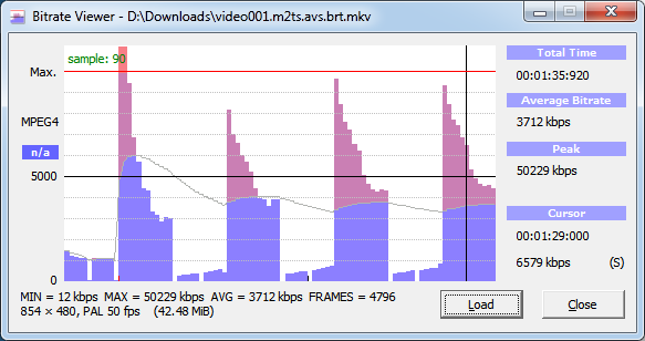

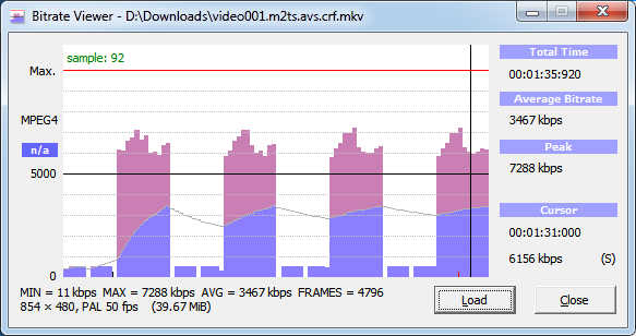

    And like I said, single pass bitrate encoding can't have as good bitrate distribution as single pass CQ encoding so encoding at the same bitrate will not deliver the same quality. Here's an extreme example with a video that has a still frame for about 600 frames, 600 frames of normal motion, still for 600 frames, motion for 600 frames, a total of four cycles. The CQ encoding looks like:
    [Attachment 49891 - Click to enlarge]
    The single pass bitrate encoding (it overshot the requested bitrate by a bit):
    [Attachment 49892 - Click to enlarge]
    That was done with x264 but you'll see the same sort of problem with nvenc. The CQ encoding has a pretty flat distribution in the full motion sections. But the single pass bitrate encoding overshoots at the start of those sections (delivering higher quality per frame) then the bitrate drops until it's delivering lower quality per frame.
