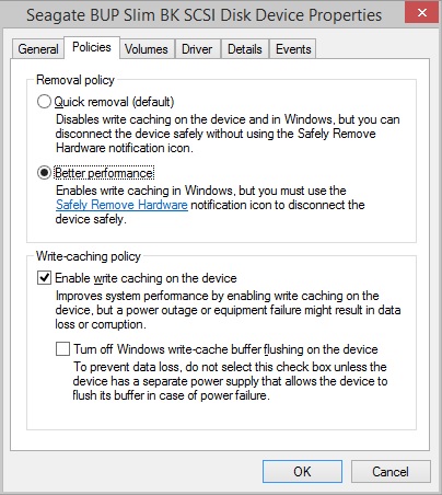

    Write cache enabled ?
    No, but should it be enabled?
  13. Originally Posted by kyrcy View Post
    If you're not disconnecting the drive frequently, yes.

    If I connect the same HDDs to a PCI Express USB 3.0 controller card I get more than 100 MB/s with the same cache properties.
