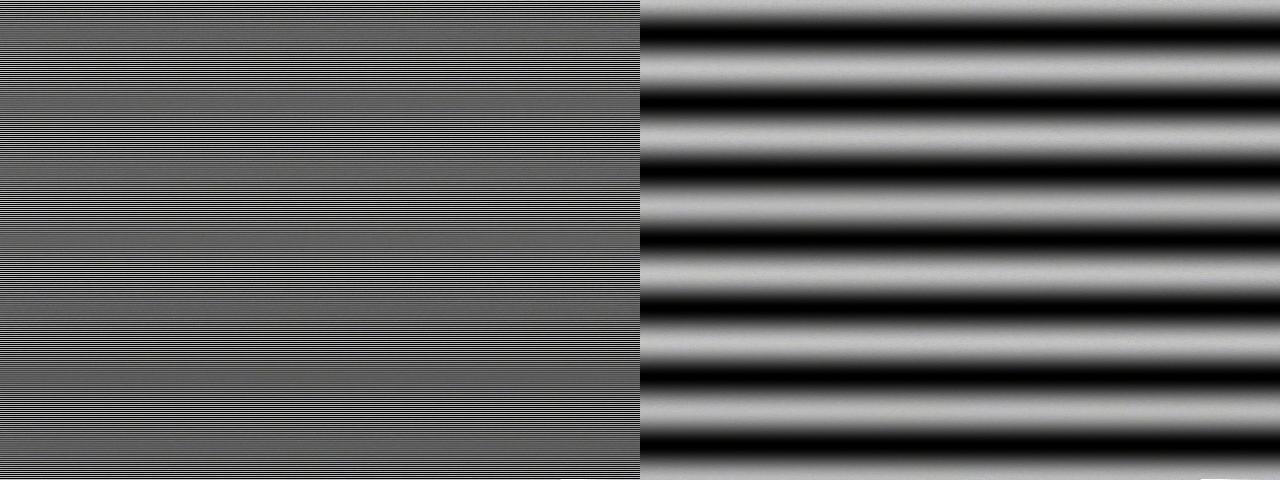

    SMDegrain isn't the only problem with this script. If AviSource had given the expected YUY2 output your crop would have failed. But it looks like you are aware of that YUY2 video can't be cropped by odd values horizontally. After cropping you are resizing horizontally and vertically. But your video is interlaced at that point. The vertical resize is causing the two fields to blend together. Here's a frame from your trimmed sample where the video is fading in from black to white:
    [Attachment 49824 - Click to enlarge]
    (Be sure to view the images full size, pixel-for-pixel.) On the left is the interlaced frame. You can see the alternating black and grey lines. On the right the two fields are stacked vertically rather than woven. You can see that the first field is black, the second field is light grey.

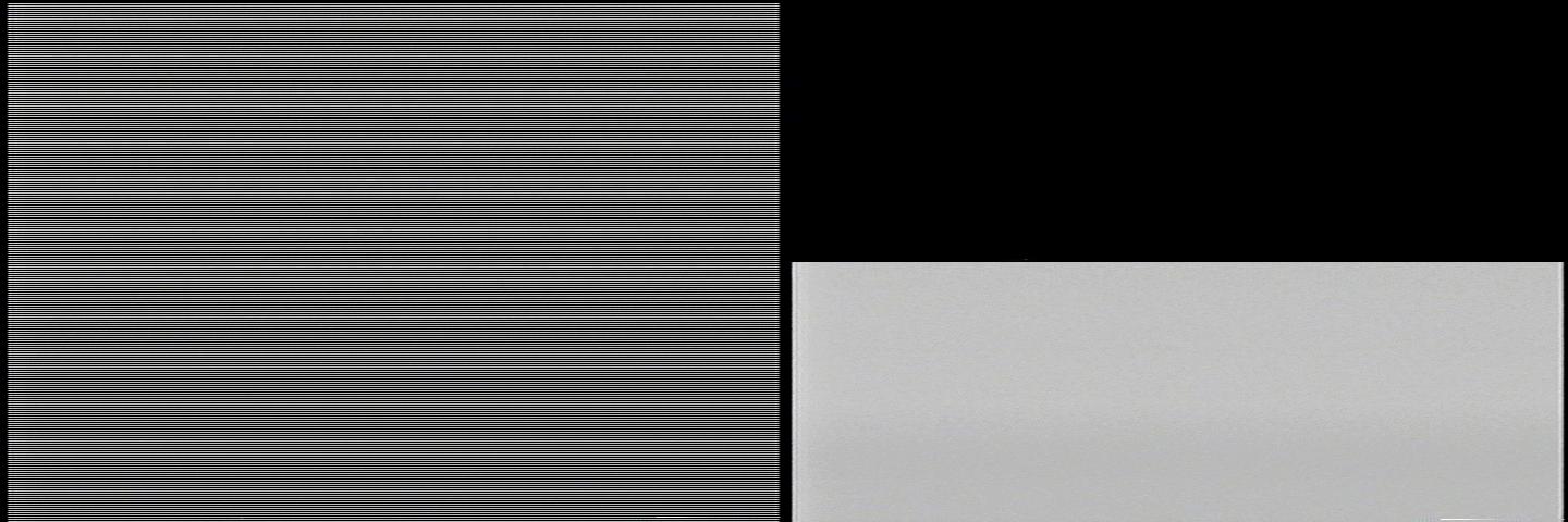

    After your crop/resize operation you get:
    [Attachment 49825 - Click to enlarge]
    The two fields have blended together. They can no longer be separated into a black field and a grey field.
    Also, cropping the top of an interlaced video by an odd number of scan lines reversed the field order. Your TFF video becomes BFF. Of course, this no longer matters because the two fields are blended together.
