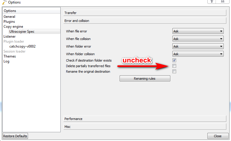

    ok. there are free bit for bit copiers that offer the option to not delete broken files when they encounter them. i've used an old one called supercopier but don't know if it runs on anything newer than win7. there's an updated version call ultracopier, but i haven't tried it.
    supercopier options
    [Attachment 49811 - Click to enlarge]
