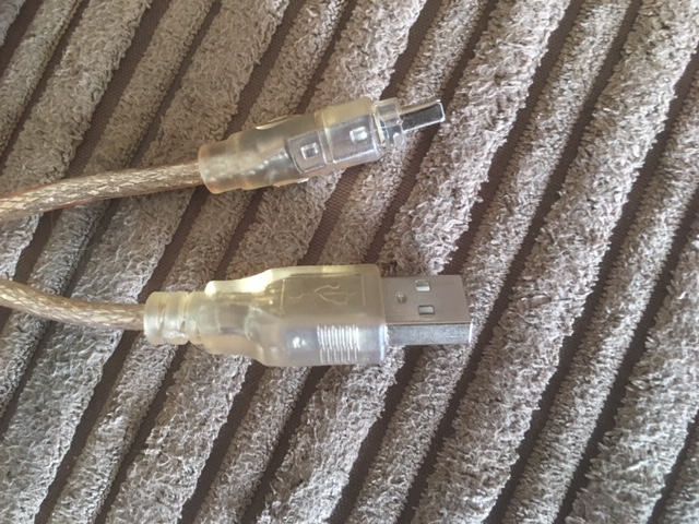

    I dug my old DV camera out of the loft today, and was surprised it still works, my camera is a Panasonic NV-DA1, it uses digital video tapes
    I want to download the tapes to my PC (I have Win7 and Win 10 ) I don't have a MAC or any apple device, apart from my phone
    I connect my camera to my PC, but it comes up with USB device not recognised
    I only have usb sockets on my PC's
    I am using the socket at the front of my camera, I think its a firewire socket with a usb plug at the end
    I don't know if there are any plugs or cables I can get to connect the camera to my PC's
    Can anyone help or give me any advice ?
    I have tried to upload pictures of the camera, the cable I am using and the socket/plug on my camera to how what I am up against

  2. If the camcorder supports USB it is only for low res video or still pictures. You won't get full DV resolution video. You need a firewire card for your PC. Be sure to get one with a Texas Instruments (TI) chip.

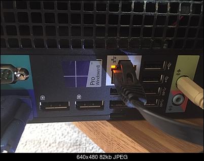

    I think I have a firewire port on there, not like the one in my photo, but a one like this (the port on the lower left, think there might be 2 of them)
  4. Those are Displayports (for connecting monitors). Note the logo: https://en.wikipedia.org/wiki/DisplayPort

    These two, I think are the right plugs
    Image Attached Images
  6. Look at the logos -- a P inside a D. Those are Displayports.

    I don't know what they are supposed to me, I haven't got any plugs like that to connect a monitor
  8. They are clearly labeled with the Displayport logo. Your computer (like most these days) can be connected to two or three monitors. You're probably only using one. Those ports have nothing to do with Firewire.

    Displayport has a diagonal bevel on one corner. Firewire has bevels on two corners.

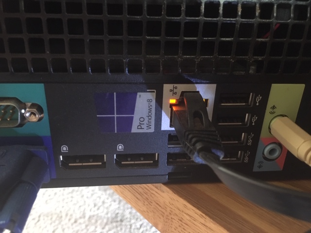

    I have just looked at the ports on my Win10 pc, I have this one, what is this ?
    What kind of plug would I need to connect my camera to this port ?

    That's an HDMI port on the other computer. Another monitor port. You cannot connect your firewire camcorder to that.
    Firewire ports were never common on Windows PCs. And they have pretty much disappeared from them in the last 10+ years.

    So the socket on my pc in the picture is just out, not in ?

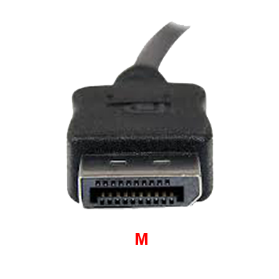

    Displayport: for monitors
    looks like this - Image
    [Attachment 49805 - Click to enlarge]

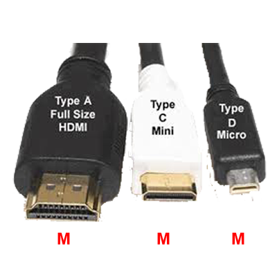

    HDMI: for monitors, TVs, projectors, amps, etc.
    [Attachment 49806 - Click to enlarge]
    (computer would almost ALWAYS have the full size)

    note: the "M" in the pictures is Male end.
