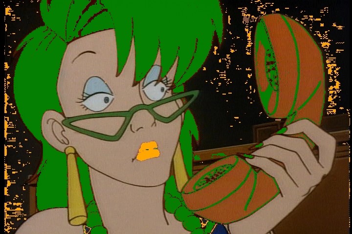

  12. Just for fun I made a function that works like MaskHS() but works with YUV:
    function MaskYUV(clip c, int "min_y", int "max_y", int "min_u", int "max_u", int "min_v", int "max_v")
        min_y = default(min_y, 0)
        max_y = default(max_y, 255)
        min_u = default(min_u, 0)
        max_u = default(max_u, 255)
        min_v = default(min_v, 0)
        max_v = default(max_v, 255)
        mask_y = Overlay(mt_binarize(c,min_y), mt_binarize(c, max_y, upper=true), mode="multiply")
        mask_u = Overlay(mt_binarize(c.UtoY(),min_u), mt_binarize(c.UtoY(), max_u, upper=true), mode="multiply").PointResize(c.width, c.height)
        mask_v = Overlay(mt_binarize(c.VtoY(),min_v), mt_binarize(c.VtoY(), max_v, upper=true), mode="multiply").PointResize(c.width, c.height)
        fullmask = Overlay(mask_v, mask_u, mode="multiply")
        fullmask = Overlay(fullmask, mask_y, mode="multiply")
        return(fullmask)
    Using it like this:
    ImageSource("image1.jpg", start=0, end=240, fps=23.976)
    ConvertToYV12()
    a=last
    b=blankclip(a, color=color_green)
    m1 = MaskYUV(min_y=50, max_y=80, min_u=90, max_u=120, min_v=150, max_v=175)
    m2 = MaskYUV(min_y=35, max_y=50, min_u=110, max_u=115, min_v=150, max_v=160)
    mask = Overlay(m1, m2, mode="add")
    Overlay(a,b,mask=mask)
    gives:
    [Attachment 53541 - Click to enlarge]
    As you can see, I built two masks, one for the lighter parts of the hair, one for the darker parts of the hair, then added them together.

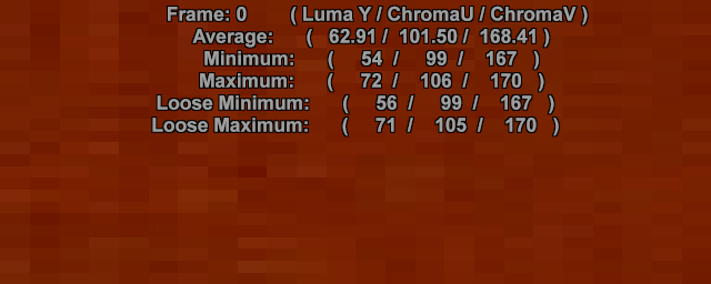

  15. Another way to get YUV values is to use ColorYUV(analyze=true):
    ImageSource("image1.jpg")
    ConvertToYV24()
    Crop(240,34, 24,24)  # look at just the brighter hair color
    PointResize(640,256) # needs to big enough to show text
    ColorYUV(analyze=true) # show YUV stats
    [Attachment 53584 - Click to enlarge]

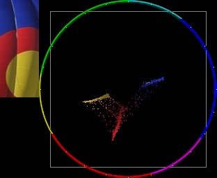

    Note that MaskHS() usually makes more sense for this type of masking. When you have an object of a solid color in light and shade it typically has the same hue in both the bright and dark areas.
    [Attachment 53591 - Click to enlarge]
    Notice how all the shades (dark to bright) of the three different hues (yellow, red, blue) of the hot air balloon fall in lines from the center (low saturation, grey-ish) toward the edges (high saturation, pure color).

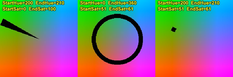

    Here's an animation that shows 10 degree wide hue wedges (across all saturations), 10 percent wide saturation rings (across all hues), and the combination of the two:
    function GreyRamp()
       black = BlankClip(color=$000000, width=1, height=256, pixel_type="RGB32")
       white = BlankClip(color=$010101, width=1, height=256, pixel_type="RGB32")
       StackHorizontal(black,white)
       StackHorizontal(last, last.RGBAdjust(rb=2, gb=2, bb=2))
       StackHorizontal(last, last.RGBAdjust(rb=4, gb=4, bb=4))
       StackHorizontal(last, last.RGBAdjust(rb=8, gb=8, bb=8))
       StackHorizontal(last, last.RGBAdjust(rb=16, gb=16, bb=16))
       StackHorizontal(last, last.RGBAdjust(rb=32, gb=32, bb=32))
       StackHorizontal(last, last.RGBAdjust(rb=64, gb=64, bb=64))
       StackHorizontal(last, last.RGBAdjust(rb=128, gb=128, bb=128))
    function AnimateHS(clip v, int StartH, int EndH, int StartS, EndS)
        black = BlankClip(v)
        hsmask = v.MaskHS(StartHue=StartH, EndHue=EndH, MinSat=StartS, MaxSat=EndS)
        Overlay(v, black, mask=hsmask)
        Subtitle("StartHue="+String(StartH)+"  EndHue="+String(EndH))
        Subtitle("StartSat="+String(StartS)+"  EndSat="+String(EndS), y=20)
    GreyRamp()
    ConvertToYV24()
    YtoUV(last, TurnRight(last), ColorYUV(cont_y=-256))
    black = BlankClip(last)
    ah = Animate(0, 180, "AnimateHS", last,0,10,0,100,  last,350,360,0,100)
    as = Animate(0, 180, "AnimateHS", last,0,360,0,10, last,0,360,90,100)
    ab = Animate(0, 180, "AnimateHS", last,0,10,0,10, last,350,360,90,100)
    StackHorizontal(ah, as, ab)
    [Attachment 53592 - Click to enlarge]

  23. None of this is tangential to what you want to do. It's an attempt to help you understand what MaskHS is doing.
  24. It's ok....in reality I'm just doing some noise filtering and only used the colors (in my initial post) to show where I was applying which denoiser. Thanks though, Mr. Brittanica
  25. You don't need to understand how the script in post #50 works. Just look at what it does. Note how the masking changes as the numbers change.
