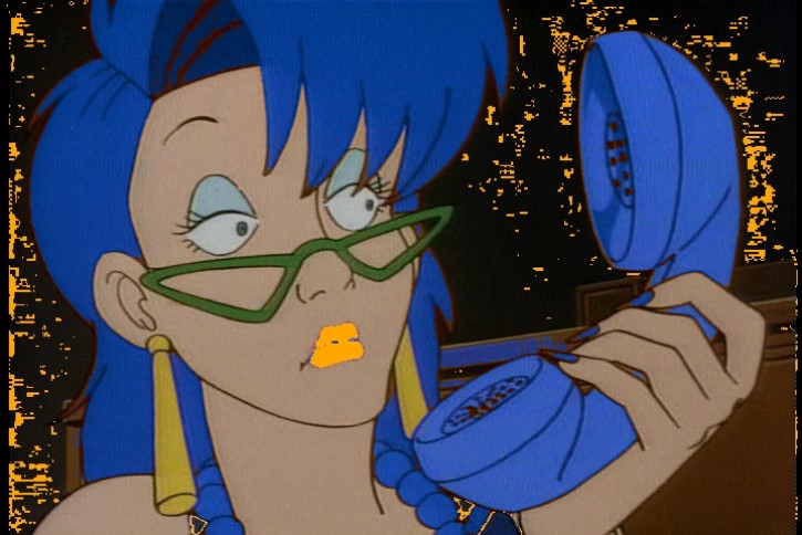

  10. Ok, I see what you mean....I converted to YV24(). I'm testing it using the color yellow to see where my actual degrainer would be applied to, but it looks like a splotchy mess! Take a look. No red being filtered here that's for sure.
    [Attachment 49786 - Click to enlarge]
  11. MaskHS is not very accurate in general. If your goal was the lips (only) , you probably need to soften and expand the mask . You also need to exclude the BG elements, possibly by increasing minsat and adjusting the hue range
    RGB keyers (in composting software, such as after effects, nuke) are a lot more accurate for this type of mask/isolation work by color/hue

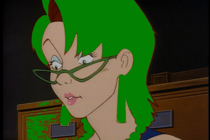

  12. Take a look at this one, I used levels from 0-200 and aaaah! she exploded into a yellow mess of post-flu mucus!Image
    [Attachment 49787 - Click to enlarge]

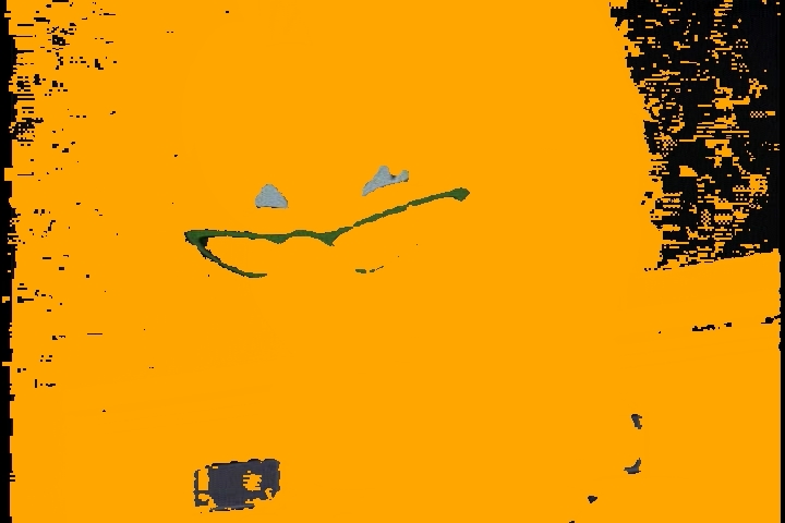

  21. Wait a sec, look at this---I'm using starthue=50 and endhue=130 and I'm getting an improvement in coverage! (yes, I changed the color to green, but remember, this is just so I can see where my degrainer would go. I'm not trying to change any colors here). Ok, so can you show me a script where I can tweak this?
    [Attachment 49788 - Click to enlarge]
  22. Just play with the parameters until you get something that you think is acceptable. Also play with minsat, maxsat
    It's unlikely that you will get an accurate mask with this method of the hair only. It will include the necklace/beads, parts of the phone, nails, possibly the lips - because of the shared hues/colors

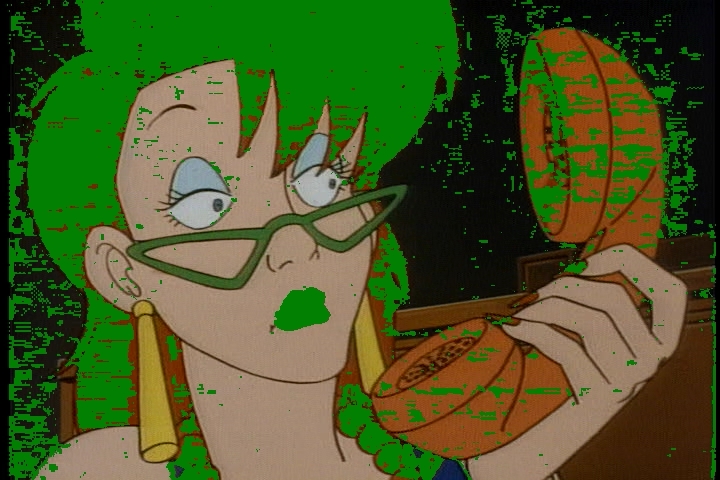

  27. Woohoo, look at me go!! This is actually pretty damn good. Thanks Poison!
    [Attachment 49789 - Click to enlarge]
