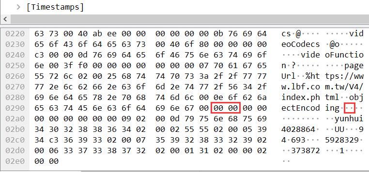

Original connect packet:
[Attachment 49781 - Click to enlarge]

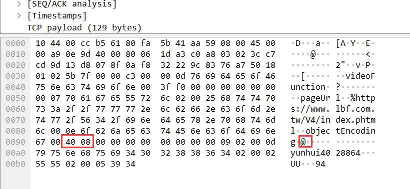

rtmpdump connect packet:
[Attachment 49782 - Click to enlarge]
I compare original connect packet to rtmpdump connect packet.
I think this is the problem, 2 bytes after objectEncoding.
rtmpdump sends 0x40 0x08
original sends 0x00 0x00
rtmpdump sends AMF3 objectEncoding, orignal sends AMF0 objectEncoding.
So my best try is to make rtmpdump send AMF0 packet, and then server should response with correct AMF0 packet, just like original packet.
