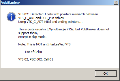

  1. I want to add a new audio item to the main movie of a chapter series, the problem I have identified is when it's time to replace the main movie pgc in vobblanker, because when I open the DVD in vobblanker this message pops up "this is quite usual in ILV/multiangle VTSs, but vobBlanker does not support them, except in skip mode" >>>> https://forum.videohelp.com/images/imgfiles/NK6hbko.jpg
    from what I've read has to do with multiangle or something

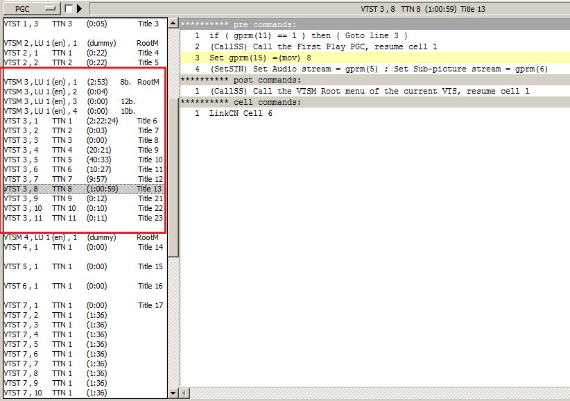

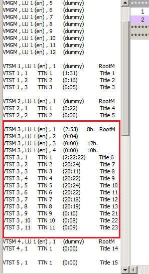

    Before replacing normal >>>> https://forum.videohelp.com/images/imgfiles/Plyifnl.jpg
    After replacing with vobblanker got a dick >>>> https://forum.videohelp.com/images/imgfiles/Q8Fuvvs.jpg

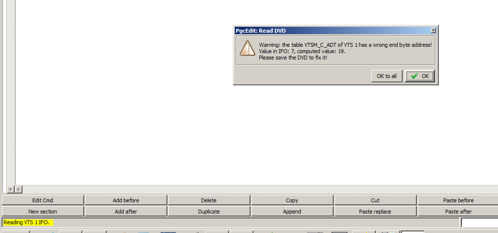

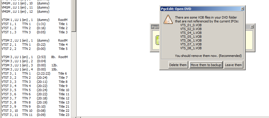

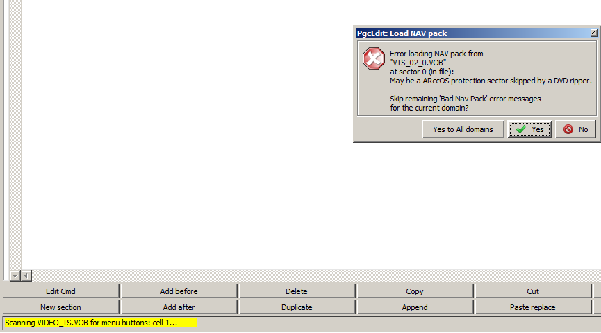

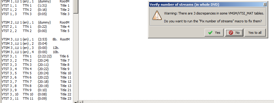

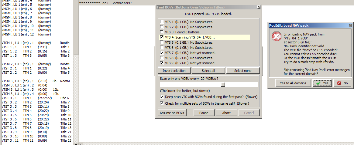

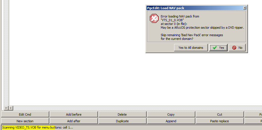

    And when I open the dvd in pgcedit without replacing vobblanker these messages appear
    https://forum.videohelp.com/images/imgfiles/xW6OgtC.jpg
    https://forum.videohelp.com/images/imgfiles/qg0rFcQ.jpg
    https://forum.videohelp.com/images/imgfiles/tdZB7L6.jpg
    https://forum.videohelp.com/images/imgfiles/Pg77YQY.jpg
    https://forum.videohelp.com/images/imgfiles/MOWNq4c.jpg
    https://forum.videohelp.com/images/imgfiles/UN4YaCs.jpg

    You'll have to remove the extra angle(s) first.

    You're the one that mentioned, "this is quite usual in ILV/multiangle VTSs" from VobBlanker.
    There are a number of reasons why you might have ILV/multiangles in a DVD. For example, one reason might be if the theatrical release and director's cut are on the same DVD. The director's or extended cut might have extra scenes not seen in the theatrical version.
    Or, signs might be in different languages, depending on the version you choose. So, there will 4 or 5 different sets of signs (different angles), depending on if English, German, French, Italian, etc versions are chosen. Lots more reasons.
    The upshot is you won't be adding any extra audio unless you get only a single angle and add it to that. But once you do that, the menus will no longer work properly unless you know how to fix them which can be difficult if you've never done it before. That's why I suggested making a new menu. Of course, you don't really need a menu at all. Just stick your new-and-improved version in the DVD player and it'll start playing automatically. If there's more than one audio, you can choose the one you want with the remote control.

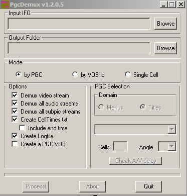

    How to remove angles? Do you have the whole DVD on the hard drive already? Then open the IFO for the movie in PGCDemux and if there are multiple angles, choose one, demux the audio, video, subs, celltimes.txt. Then reauthor them together with your new audio using Muxman.

  5. I never had this problem, and if it is appearing in this, I will try to solve...... the dvd I'm talking about has no extras, no two director's version, it's just a seemingly simple dvd of a 7 chapter show

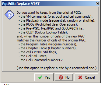

  6. Then try doing the replace using PGCEdit. Open the DVD, highlight the movie and then go File->Replace VSTS Title. Something like that. I'm not on that computer at the moment.

    https://forum.videohelp.com/images/imgfiles/RnRjpTf.jpg >>> what to select here?
    https://forum.videohelp.com/images/imgfiles/VMxkg1p.jpg >>> and here?
    https://forum.videohelp.com/images/imgfiles/sDJOwnL.jpg >>> and here?

  9. I just checked the pictures from the first post and the PGCEdit method only works when there's only a single title in the VTS. Again, you'll have to get rid of all the other angles if you want to use the original DVD menus. And then you'll have to 'fix' the menus. Either keep the DVD you have now with the new audio or create new menus for it. You can even extract and use the menu backgrounds you have now. I apologize for not looking at those pictures earlier.
