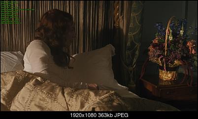

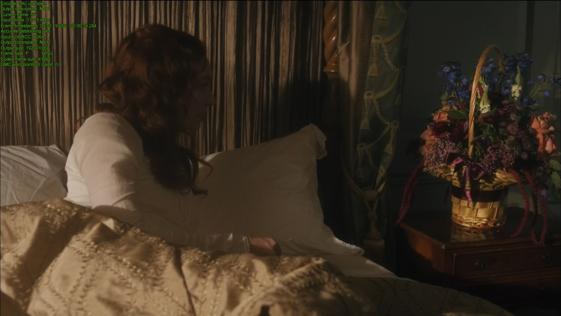

  5. Dinosaur Supervisor KarMa's Avatar
    Jul 2015
    US
    This is what it looks like with FFDShow, by enabling OSD settings.

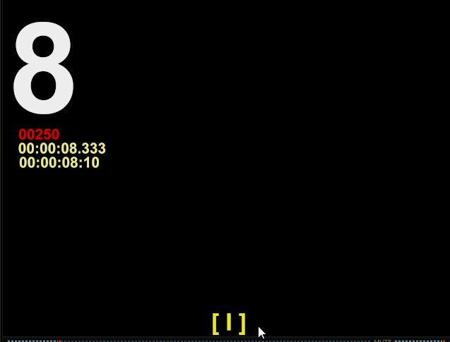

  7. Member Budman1's Avatar
    Jul 2012
    NORTHWEST ILLINOIS, USA
    If you like Avisynth and just want to see the frame number, timer, and type you can use be code below and just play the AVS file in a media player that supports AVS. (Most do)
    I used -atrack -2 because that video has no audio.
    FFmpegSource2("C:\Users\Bud\Desktop\trimnmerge\250.mp4", atrack=-2).Crop(0,0,-0,-0)
    ScriptClip(Last, """Subtitle("[ "+Chr(FFPICT_TYPE)+" ]", size=(Height*56.0/720), align=2)""", after_frame=true)
    #Subtitle("C:\Users\Bud\Desktop\Test Pattern 2.mp4", x=720, y=560, font="Arial", size=24, text_color=$ff0000, align=3)
    ShowFrameNumber(scroll=true, x=22, y=200, font="Arial", size=24, text_color=$ff0000)
    ShowTime(x=84, y=220, font="Arial", size=24, text_color=$ffff80)
    ShowSMPTE(fps=29.97, x=80, y=240, font="Arial", size=24, text_color=$ffff80)
    I produces an image each frame such as the below which is a 250 GOP file, 30 FPS file of a timer 0-60.
    [Attachment 49749 - Click to enlarge]
