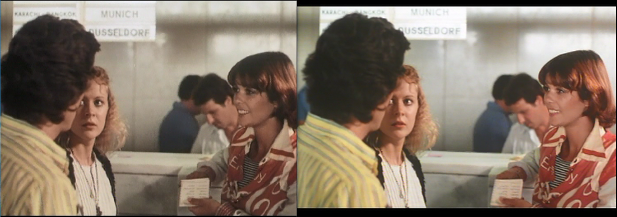

    @DB83 Btw this is the version I was referring to earlier that has a fuller picture vertically (but as it turns out, the picture is cropped on the sides). The one on the left is sold in Eastern European countries (maybe a VHS capture?), the one on the right is the German DVD.
    [Attachment 49753 - Click to enlarge]
    just create the 16/9 DVD and allow a small pillarbox as manono suggested.
    That's not what he's suggesting. He's suggesting creating a 4:3 DVD, which would result in both letterbox and pillar bars.
    But my point still stands, you know what need to be done, what are you waiting for. Why don't you encode the 16/9
    DVD and try it out

    You may well frequent a certain forum that has posted several versions. Trouble is that non of these, if one is to believe the quoted specs, agrees with the published AR of the film.
    I am not a restorer and need a collar and lead as far as avisynth is concerned. Neither does it bother me to see pillar-boxing+letter-boxing since that was the norm before ws tvs came about. Only when a new scan of film elements is done does one typically get 'the full picture' yet even that is not always the case when certain companies insist in creating ws when it was never there in the first place.
    But apart from actually wanting to see this film again after all these years - I do not have any of the versions from that forum - I am equally curious about how the 'official' dvd is presented since, unless my maths is totally screwed neither of the above show the full picture.

    ...since, unless my maths is totally screwed neither of the above show the full picture.
    But, assuming the 2 versions are otherwise the same (same framecount of the movie video), it wouldn't be difficult at all to create a version incorporating the extra height of the one and the added width of the other. That would leave just the 4 corners with some black which could be dealt with in other ways.
    You can see what I'm talking about by imagining overlaying the picture on the left on the one on the right. There are some minor brightness and contrast issues to be worked out, it looks like, but nothing all that difficult, I don't think. Again, though, this assumes the 2 versions are otherwise identical. If they aren't, it can still be done but might require a whole lot more work.
    It may be, as Knocks mentioned earlier, that the 'widescreen' version (the one with the black bars) was the one intended for release, with the top and bottom removed. It's just too bad a real 16:9 version wasn't created and released.

    I'm not really sure that 1.66:1 as quoted in imdb is correct. The wiki article (not always to be taken with total accuracy) states that the common format was 1.6:1 or 16:10 that the OP was thinking of.
    The extra height on one and the extra width on the other is frustrating but that is the way that the cookie often crumbles. Seen many a write up that discusses 'open-matte'.
