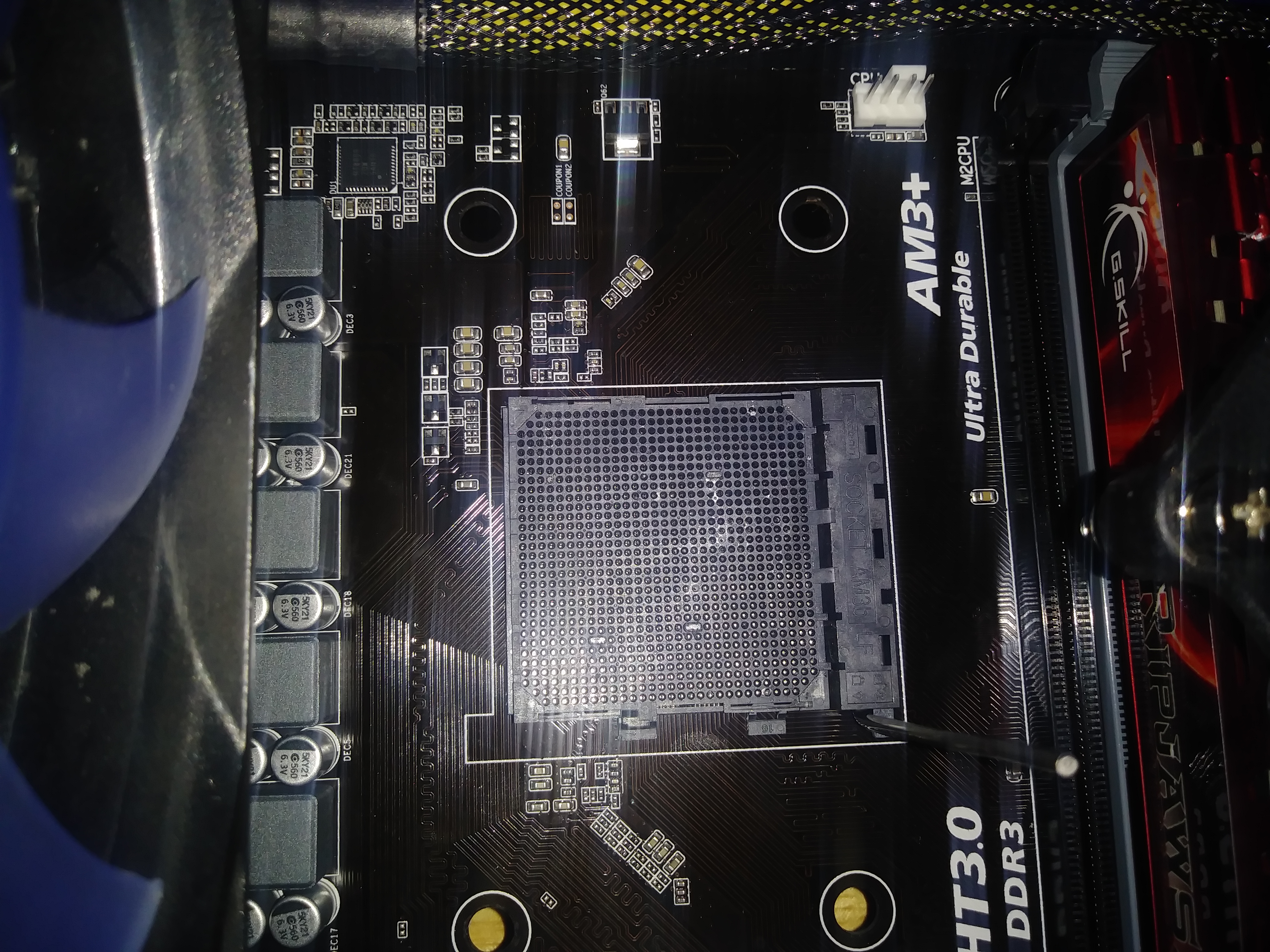

Im not sure if anyone is still looking at my thread. Sorry for the delay i been rebuilding my computer after taking it apart the guy who did the repair before me did some much damage like to much paste on the cpu for the linquid cooler or no back plate on my case etc. But i do have one question before i put in my cpu after i cleaned off the cpu so much case some of the paste was under on the cpu bottom it got onto the motherboard cpu slot.
[Attachment 49779 - Click to enlarge] I pasted a picture is that paste going to do any damage to my motherboard? -
You should create a new thread for this.
That said, since thermal paste is designed to conduct heat, it's not a good thing to have it there. Also, some pastes are electrically conductive, potentially leading to a short between the pins. Use an electrical contact cleaner (ideal) or 90%+ isopropyl alcohol (don't use regular rubbing alcohol as it may contain additives) and a fine natural hair paint brush (make sure to pull on it to remove loose hairs). Allow the socket to thoroughly dry a several minutes before installing the CPU.
