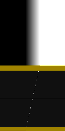

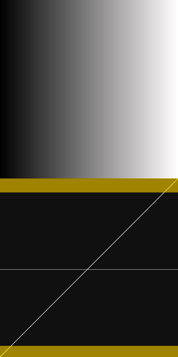

Will build a mask based on the Y channel. Y values below min become 0, Y values above max become 255, Y values in between are proportionally spaced between those extremes. For example, a greyscale ramp:Code:function YMask(clip v, int min, int max) { Levels(v, min, 1, max, 0, 255, coring=false).GreyScale() }
[Attachment 49727 - Click to enlarge]
after YMask(min=100, max=156)
becomes:
[Attachment 49728 - Click to enlarge]
