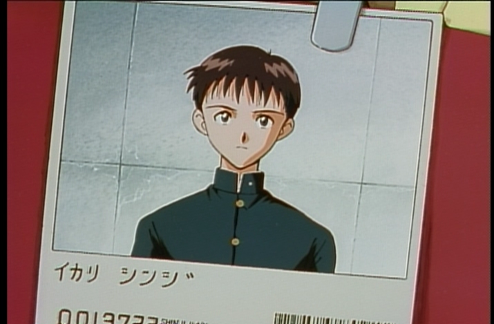

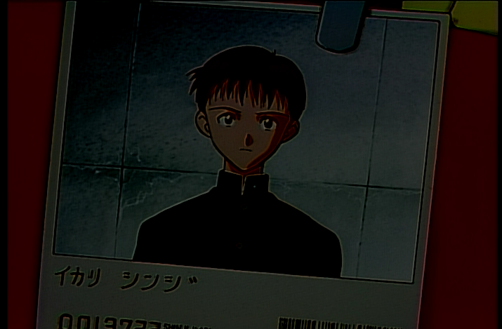

    Hi! This is my second post about a project I've been having issues with lately. I've been working on sprucing up the Archival of Evangelion DVD release, which is the original aired episodes unaltered for those who didn't know. I just set AVISynth back up again and I have been having issues with QTGMC. On the placebo preset everything is literally dark.
    [Attachment 49718 - Click to enlarge]
    This is what it is supposed to look like:
    [Attachment 49719 - Click to enlarge]
    On that note, the other issue I am having with AVISynth is encoding. I cannot for the life of me figure out how to export my scripts! At a very basic level I'd like to export to an uncompressed AVI and encode it using VirtualDub or Premiere. But the other half of me would like to be able to have my encodes and if I ever needed to re-encode it for some reason I'll have the AVSs and the AVIs laying around ready for me to do so. If anyone has some insight to help me that would be phenomenal!
  2. There is some kind of problem (maybe 10bit/8bit conversion errors) in the noise processing at "very slow" and "placebo" (this may be limited to the 64 bit version, and may be a compatibility issue with one of the support filters). If you set NoiseProcess=0 you won't get the dark picture. Conversely, if you enable NoiseProcess with faster presets you will get a dark picture.

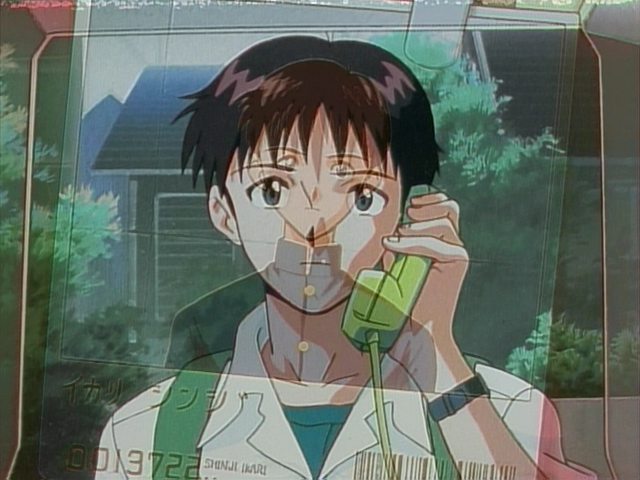

    Thank you very much kind stranger! That fixed the dark video. But I've been noticing some issues with ghosting like this:
    [Attachment 49722 - Click to enlarge]
    My current script is as follows:

  4. Are you sure that's not in the original video? Use Bob() instead of QTGMC() and see if it shows the same blending. Upload a sample of your source (not filtered or reencoded).
    Aug 2019
    Michigan
    I'm fairly certain that its a ghost and not a fade. I tried bob, same issue still. I'm comparing to the blu-ray version but the blu-ray is from a different master so it could've been changed. But there are plenty of other times in the video ghosting still occurs. My method for ripping the DVD was to use MakeMKV on the ISOs I downloaded. MakeMKV just removes the DVD restrictions and makes the DVD title into an MKV without any data loss. I then went to virtualdub and trimmed each title down to individual episodes and exported those as uncompressed AVI.

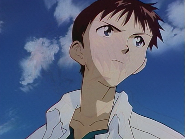

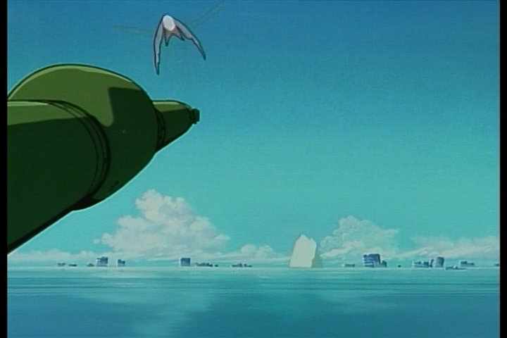

    I'm using yadifmod2, is there any significant difference? What is the proper terminology for the "ghosting" of the residual frame?
    Like this one:
    [Attachment 49734 - Click to enlarge]
    Is this as good as it can ever look with those 'residual' frames? What do you mean by 'scene change'? Like a jump cut?
  18. Originally Posted by Fraugster View Post
    What are you talking about? The 'color outside the lines'? The color shifted to the left 2 pixels or so? If so, that's a different issue entirely and can be fixed, more or less.
    The archive is the originally aired masters. I think they've been rescanned for this release.
    If you bought these expecting some sort of a restoration, you were sadly mistaken. It looks to me they were made from an analog and probably VHS source. They are pure garbage.

    Look around the bird in the image I sent. See whats left? The wings spread is the frame before its pretty faint but its almost like a yellowish greenish look. I wasn't gonna 'restore' it so to say but spruce it up. Deinterlace, crop and resize, then mux the original VHS subs over it. I was hoping for better quality from QTGMC. If I reduce the SrchClipPP to 0 theres not so many blended frames.
  20. I don't see any residual from the previous frame. Maybe someone else will, but an unblender won't remove it. Maybe something else will. QTGMC isn't always the best bobber to use on field-blended anime. You asked about YadifMod earlier, and I use that quite a lot. Something like:
    yadifmod(mode=1, edeint=nnedi3(field=-2))
    Srestore(frate=23.976)
    Unless that's already how you use it, you'll need Nnedi3.
  21. QTGMC isn't creating those blends. They are in your source. Run SeparateFields(), which simply separates the two fields and you'll see the same blending. And that blending is visible in the luma for at least four consecutive fields, at least eight fields in the chroma! That is why I suggested earlier that someone ran a very strong temporal noise reduction filter on the video in the past (before the DVDs were made).
    This video is just terribly produced. There's film bounce at most shot changes (splices in the film caused the film to bounce in the projector as the film passed through). Often the film was still moving as the frame was digitized, leading to rolling shutter distortions. There are the field blends from a frame rate conversion and further blending from a temporal noise reducer. At shot changes the bottom half of the field blends in first, then the top half of the next field (this might be intentional).
