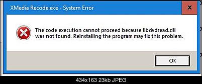

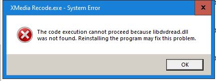

    I tried installing it and reinstalling it and get this error. Any idea why?
    Thank youClick image for larger version
  16. Newbie Enthusiast PixelHunter's Avatar
    Aug 2019
    A secret base underneath Antartica.
    Oh, I haven't had that problem. Try using the opposite version ie portable instead of installed or vce versa. Maybe try the 32bit version instead of x64 as well. Other than that I am out of ideas. Normally, I use XMR for some aspects of colour correction and colour curves but use Filmora 9 for cropping but that is a paid program.
