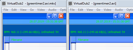

  4. You have a playback problem. They're both the same colors when loaded into VirtaulDub2 (which uses rec.601 to convert YUV to RGB):
    [Attachment 49675 - Click to enlarge]
    For HD material you should use rec.709 to convert from RGB to YUV. You should also flag the video as rec.709.

  5. Interesting, regular virtualdub via ffvideosource had false colors but virtualdub2 opened it correctly. How do I flag the video as rec.709 in Avisynth? ConvertToRGB(matrix="Rec.709") failed but I assume because virtualdub already opened it as 601 beforehand?

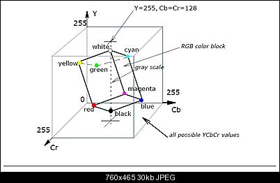

    The RGB colorspace is a subset of the YUV (more properly YCbCr) colorspace. RGB is rotated, transformed, and scaled to fit within a fairly small portion of YUV:
Name:	0EF01A88-F874-4ECB-B2B6-3ADC38636CD4-imageId=FE9BEAD5-12E5-4244-80E1-E61EB8211A76.jpg
    That's from "RGB Colors Cube in the YCbCr Space" at https://software.intel.com/en-us/node/503873.
    Originally Posted by Aludin View Post
    What further details does the color matrix give us?
    The colormatrix specifies the rotation, translation, and scaling.

  14. I've seen that cube before but it's always been greek to me. I don't get it. How do I interpret it?
    The idea that RGB is a subset of YCbCr is also news to me. You're telling me that in the same bitspace, YUV offers more shades/colors than RGB? Isn't RGB the building block for all digital display?
    Meaning what? What's being rotated?
    But it's more than just the subsampling, it's the location of the U and V samples relative to the Y samples (though this is often ignored):
    That I do know.
  15. Originally Posted by Aludin View Post
    When color TV was first invented they needed a way to transmit a signal that was compatible with all the existing black and white TVs. The solution was to rotate the RGB colorspace so that all the greys fell on one axis (Y) and the other two axis (Pb and Pr) represented colors that were added or subtracted from that greyscale value. Black and white TVs would show the greyscale image but ignore the chroma channels. Color TVs would use all three channels to reconstruct the full RGB picture. This was all done with analog components, of course.
    The rest of this description relates to the digital representation of that analog signal -- the limited range rec.601 or rec.709 schemes, YCbCr.
    Since both RGB and YUV are three dimensional color spaces they can be represented by a three dimensional graph. Sice they are bounded (0 to 255) they can be represented by finite cubes. The image I posted shows the full RGB colorspace within the full YCbCr colorspace. All valid RGB colors (with values of 0 to 255) are represented by the inner cube. All possible YCbCr values are represented by the outer cube.
    A straight line from the black corner of the RGB cube (0,0,0) to the white corner (255,255,255) represents all pure grey values. You can see that the RGB cube is rotated within the YUV cube so that the black corner is at its bottom and the white corner is at its top. It is shifted (translated) within the YCbCr cube so that the greyscale axis isn't at Cb=Cr=0 but rather Cb=Cr=128. And it is scaled so that the RGB 0 to 255 range fits within 16 to 235 on the Y axis. Values outside the inner cube represent RGB values that don't fall within the specified RGB range of 0 to 255. So the YUV cube represents a wider gamut of colors than that inner RGB cube. For example, Y=0 Cb=Cr=128 would require negative values for R, G and B (about -18) -- your monitor would have to suck photons out of your eyes for you to "see" it.
    Since the RGB cube is shrunken within the YCbCr cube, and both cubes represent 16 million possible combinations (as 8 bit values), multiple RGB values end up mapping to the same YCbCr value. In fact, on average, each YUV value maps to about 6 nearby RGB colors. This is why banding is much more of a problem with digital YUV.
