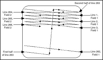

    I don't know if this answers the OP's question, but this image confirms what I recall reading decades ago. Line 1 is the first full scan line and line 263 is the other half of line 262, as stated, starting in the middle of the top of the screen.
    [Attachment 49672 - Click to enlarge]
    Source: http://www.ni.com/en-us/innovations/white-papers/06/anatomy-of-a-camera.html
    Okay...I'm out, that's the limit of what I know about scanlines.

    Okay, back in.
    I may be missing something here (not the first time and won't the last), but what do you mean by 'image'? 262 1/2 lines comprise the field, but X number of them while visible on a monitor set to overscan or when captured by certain hardware [are unseen, and as aedipuss stated, used for "housekeeping" purposes], there's no visible 'image' information there.
    *Jumps back out*
