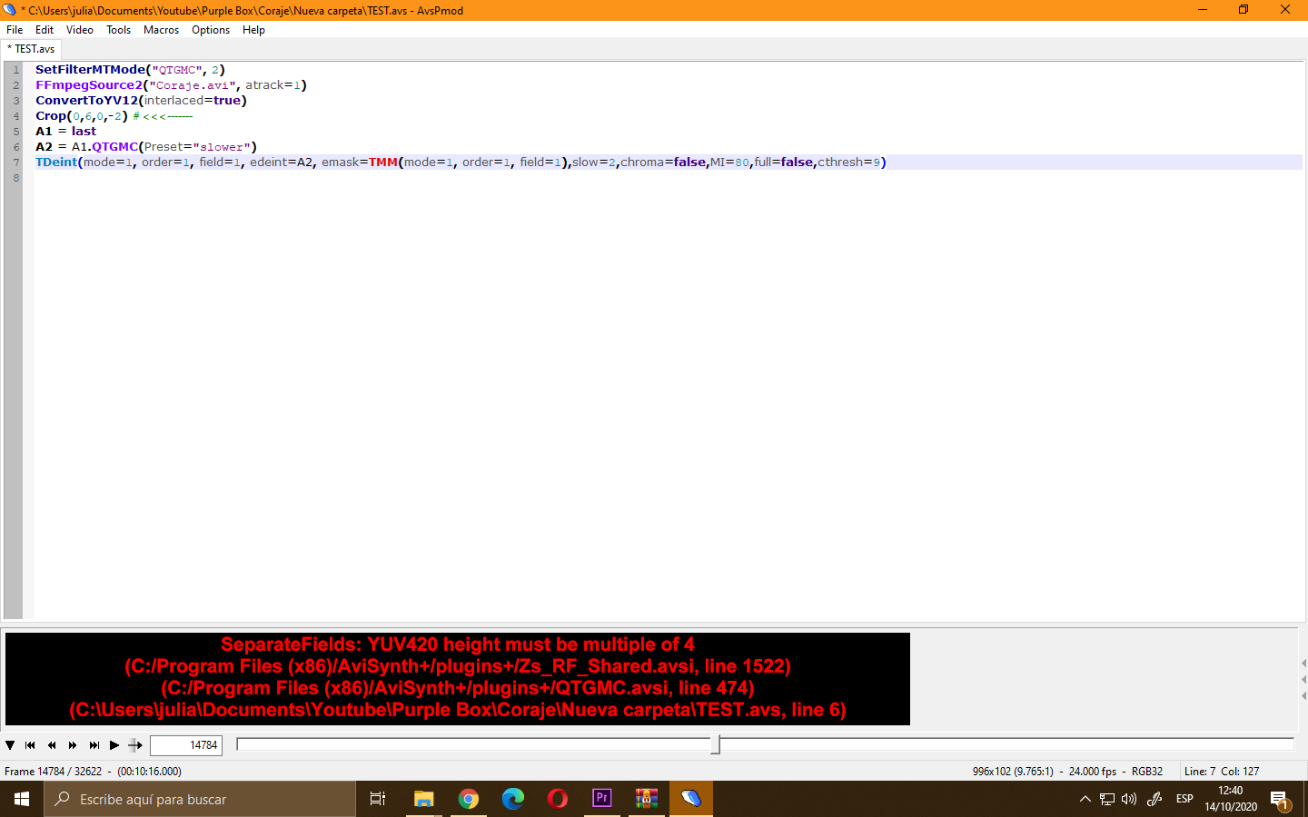

  28. Hi, im new in this world, today i try to upscaled a video but this was the errorImage
    [Attachment 55493 - Click to enlarge]
    how can i fix?
  29. Try removing the crop(). Does it work? What is the frame size of your source?
