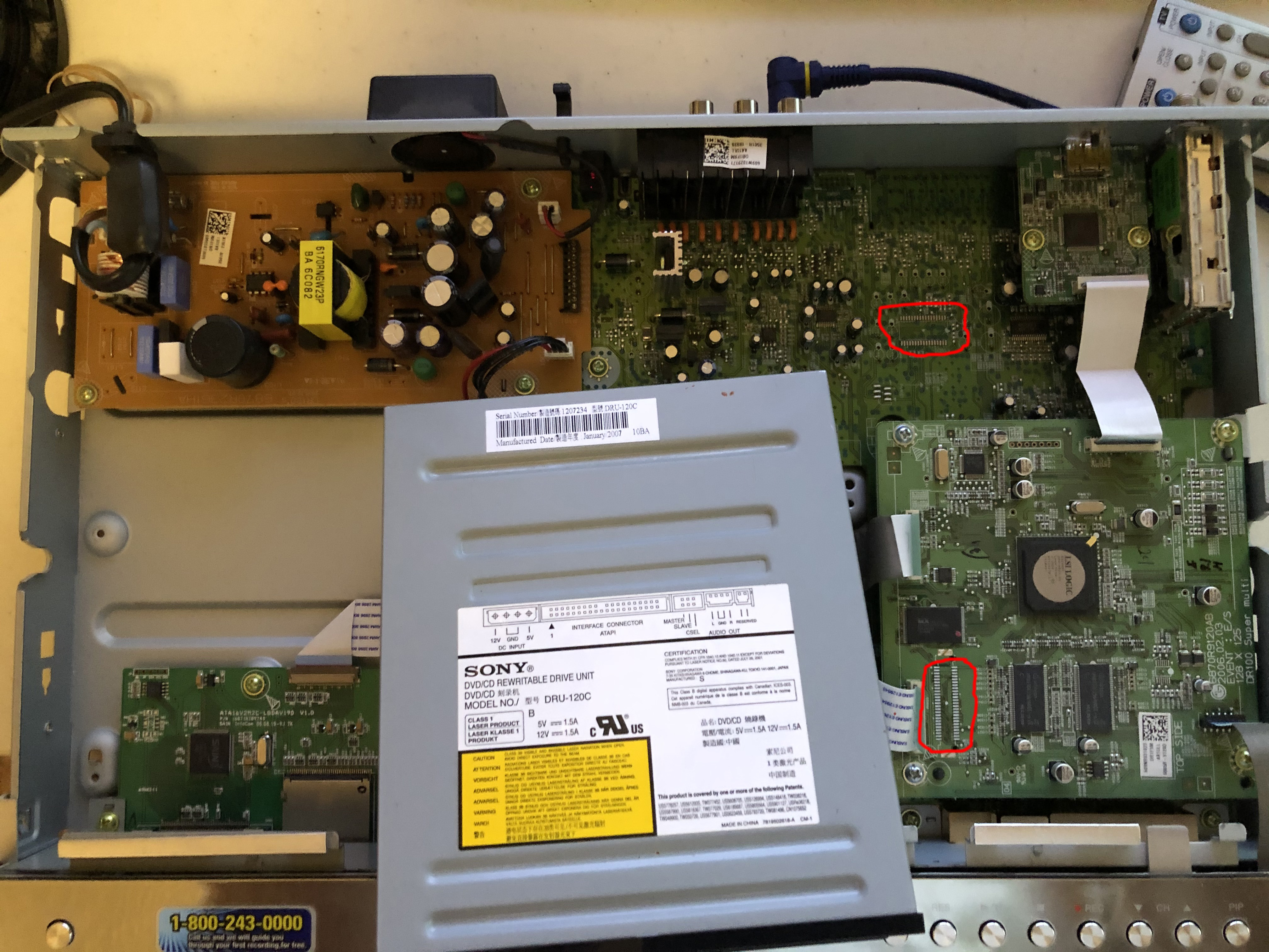

  14. Bummer same problem with SONY DRU-120C, says TY, Verbatim DVD-R as defective disc but works with Verbatim DVD+R DL and Memorex DVD-RW. Is the board missing some chips?
    Feb 2006
    the board may have to have what we call "married to the drive" it has the key/firmware to make the drive work properly.
    see this thread - https://forum.videohelp.com/threads/383000-Can-I-replace-a-TV-DVD-with-a-DVD-drive-from-PC
  16. Thanks for the link. Now it's confirmed the only suitable replacement is an actual GDA-4164L.
