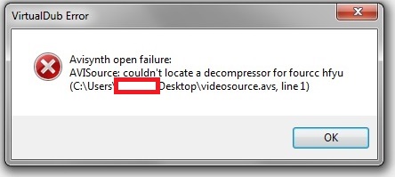

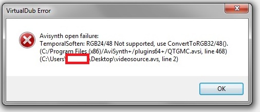

    I put QTGMC in the plugin folder I'm still getting error messages, I tried one Huffyuv file and a non compressed file and got the following messages, The first message I think it's due to lacking Huffyuv which was working fine before and now it disappeared, I tried installing it it installs with no errors but never shows up on vdub, The second message I have no clue, I think I should just give up on this complicated processes.
  28. Capturing Memories dellsam34's Avatar
    Jan 2016
    I managed to fix Huffyuv installation and now for the huffyuv compressed file I'm getting error message "there is no function named 'nonyuy2clipin'" very frustrating.
    By the way I run the version and it shows I'm running Avisynth+, I went to uninstall programs and I don't see avisynth only avisynth+ so I'm assuming by default it installs both versions.

  30. What colorspace are your AVIs? You don't want RGB. If you're stuck with that then add:
    ConvertToYV12(Interlaced=True) ###Interlaced=True if interlaced, otherwise ConvertToYV12()
    right below the AviSource line and before anything else. And you solved the HuffYUY problem, right? Or, maybe changing the colorspace will solve it.
