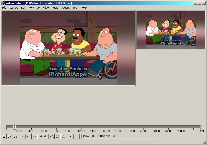

    And.... I just remembered a function I have so it's attached below. It's called FFMS3 so it doesn't have the same name as FFMS2, but I'm pretty sure the only difference is the audio is enabled by default. Being disabled by default used to annoy me no end.
    So
    FFMS3("E:\Some Folder\Some Video.mkv")
    should work.
    And... now I've been typing long enough for my brain to start contributing, you probably can't go too far wrong with VirtualDub2.
    A quick test.....
    CropResize(832,468, CropDAR=1.3, Frosty=true)
    I clicked play and there was definitely audio. You could even edit before you encode. I don't think it'll be hard to find your way around it for just encoding a script.
    [Attachment 61920 - Click to enlarge]

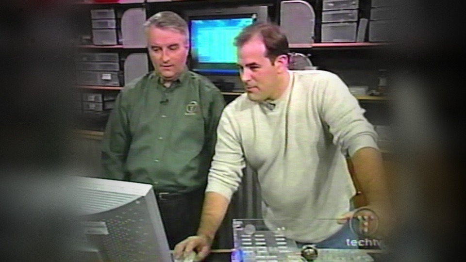

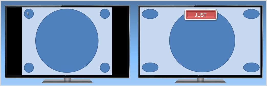

  8. Today I came up with another idea. I'm not sure if you would run into the same limitations or issues that you experienced with the other suggestion that I came up with. What I had in mind was being able to apply a vignette effect to Frostyboarders. For reference, I've attached two screenshots below. A before and after of how Frostyboarders acts now and what I want the effect to look like.

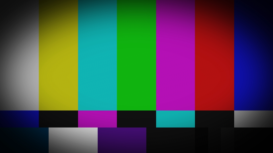

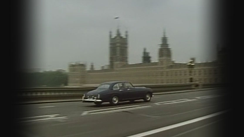

  9. The problem is still a gradient one though, and I don't think I could get it to look right with the clone borders because it's possible for stuff to the very left/right of the borders to be brighter than what's close to the picture edge, so even with the mask it didn't produce a consistent gradient type look. A similar thing has happened with your screenshot where the monitor is.
    The original frosty borders would be a different story as they're just a small number of pixels stretched out to fill the border, so they're consistent from edge to picture (more or less) which means the mask can produce a gradient effect. I assume it'd need a much darker version of the borders, under the normal borders, with a gradient mask.
    This is a simulation as I'm using a black to white gradient over the normal borders, but even though they're a bit dull as a result, the gradient look is there. Aside from the dullness, the gradient stays gradient-like when the picture is changing too.
    A = FrostyBorders(704,396)
    B = FrostyBorders(704,396, FrostyGradient=true, BColor=color_white)
    Overlay(A, B, mask=B.Invert().ColorYUV(Levels="TV->PC"))
    [Attachment 62257 - Click to enlarge]
    Thinking about it, last time it was the blurring we were trying to make gradual. I can't remember if I tried the same with clone borders for a dark to light gradient. When I get a chance to play around with this properly I can try it with the clone borders too.
    Edit: I played around some more and did it properly (although just from a fresh script, not in the function at all), but I don't think the gradient look works. Even for frosty borders the gradient appears to move around according to how bright the picture is. For a still shot it's okay.
    [Attachment 62264 - Click to enlarge]
    But have a look at the first sample. I find the way the gradient appears to change pretty distracting. Clone borders with less blurring and more picture are worse.
    I think the only way it might look sensible is to blur the borders so much they're virtually a single color, and blend them together. I'm not crazy about the way that looks either but the gradient is more stable. See the second sample. It's extremely blurred clone borders blended together.
    I haven't tried either with feathering as that's a whole other thing, but I can't imaging why they'd look any different feathered.... aside from the feathering.
    Edit: Another thought. If you don't want a gradient as such, and just darker borders, you can darken them using the Bright argument. You can also adjust the contrast and saturation.

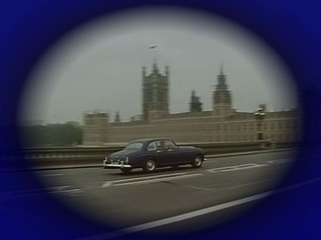

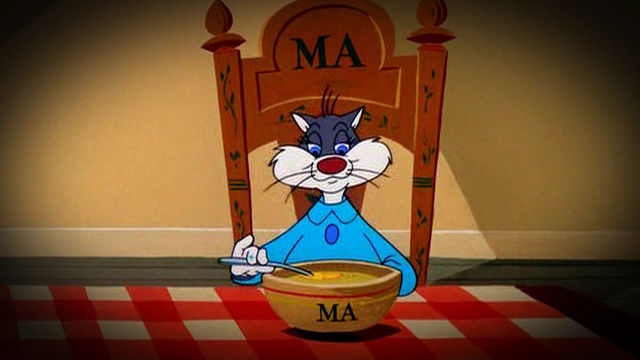

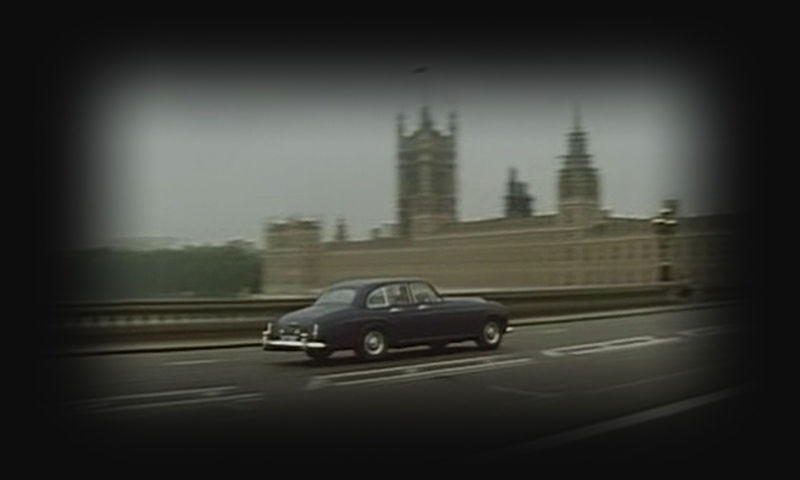

  12. If it can be a solid color that'd be a different story. When you overlay a solid color on the picture it'll be stable.
    I downloaded a vignette mask and fiddled with it a bit, then made a blue copy to use as the solid color. There's quite a few vignette masks on the internet if you search for them. A little bit of tweaking and contrast adjustment and I ended up with an effect I'm sure I've seen in an old Doctor Who episode from the 70s. : )
    [Attachment 62510 - Click to enlarge]
    The feathering wasn't really designed for this, but maybe with a bit of tweaking it could produce a better vignette look. Once again, it's fine overlaying a solid color. I made the picture wider than 4:3 before adding borders as using the feathering it seemed to work better if the borders weren't too wide.
    CropResize(760,468)
    FrostyBorders(832,468, Plain=true, Feather=56, BColor=Color_Gray10, Bright=-10)
    [Attachment 62511 - Click to enlarge]
    Just for fun.
    CropResize(760,468)
    FrostyBorders(800,480, Plain=true, Feather=56, BColor=Color_Gray10, Bright=-10)
    [Attachment 62512 - Click to enlarge]

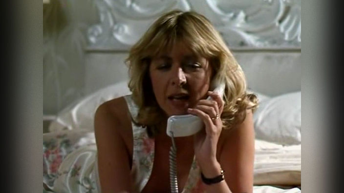

  14. I haven't tried the image overlay thingy you linked to yet as it doesn't play nice with XP. I'm guessing this is what you're after though. I think it'll slot into the ffdshow function without too much hassle.
    Video = ColorBars().KillAudio().CropResize(960,540).ConvertToYV24()
    Image = ImageSource("D:\test.png", pixel_type="RGB32")
    Image = Image.BilinearResize(960,540)
    Mask = Image.ShowAlpha("Y8")
    Image = Image.ConvertToYV24()
    Overlay(Video, Image, mask=Mask)
    ConvertToYV12()
    [Attachment 62643 - Click to enlarge]
    Let me know if that's correct, and if it is I'll update the ffdshow function.

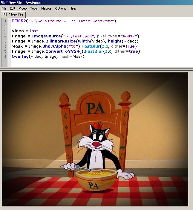

  17. Capturing Memories dellsam34's Avatar
    Jan 2016
    Can this be input in AvsPmod?

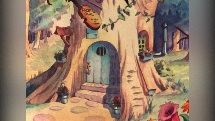

  18. Yes. You need a vignette image with an alpha channel to create the overlay mask. There's probably lots on the internet, or you can download the one thebib62 attached to post #103. Other than setting the correct path to the image, you can just add the stuff above to a script.
    [Attachment 63065 - Click to enlarge]
    PS Because the vignette image is resized to match the video resolution, you don't have to worry about the aspect ratio of the one you use. Just find one you like. I cropped the video to 16:9 first, but it's the same image here as above.
    [Attachment 63066 - Click to enlarge]

  25. The best aspect ratio is stretch video to fullscrImage
    [Attachment 71086 - Click to enlarge]
    een and shrink the sides . like this
    Can anyone make a just aspect ratio like the one on Panasonic tvs , pixel shader hsl that works with potplayer / mpc
    Can you make a just aspect ratio like the one on Panasonic tvs
    It stretches only the edges , the center of the image remains fullscreen in correct aspect ratio and you view the entire image without losing parts of the picture as in your stretch by keeping aspect ratio
    Format JUST - Justifies the image by stretching it to the four corners on the screen. The middle of the image stays almost the same shape, however the sides of the image are stretched or shrunk more. This is recommended when you do not want to have black bars.
  26. I believe the ForstyBoarders script can already do what you want.
    FrostyBorders(832,468, Clone=1, blur=0, texture=0, tsoft=0)
    Let me know if that is what you're asking for.
    Also, I am curious, could you provide a model number of the panasonic TV's you are referring to? I want to look into those TV's if they offer such an option for what you described.

  29. Originally Posted by thebib62 View Post
    I saw it on a Panasonic CT-34WX54, but many othr models had it.
    you can see it here
    https://www.youtube.com/watch?v=qJHxrAA1HYQ
