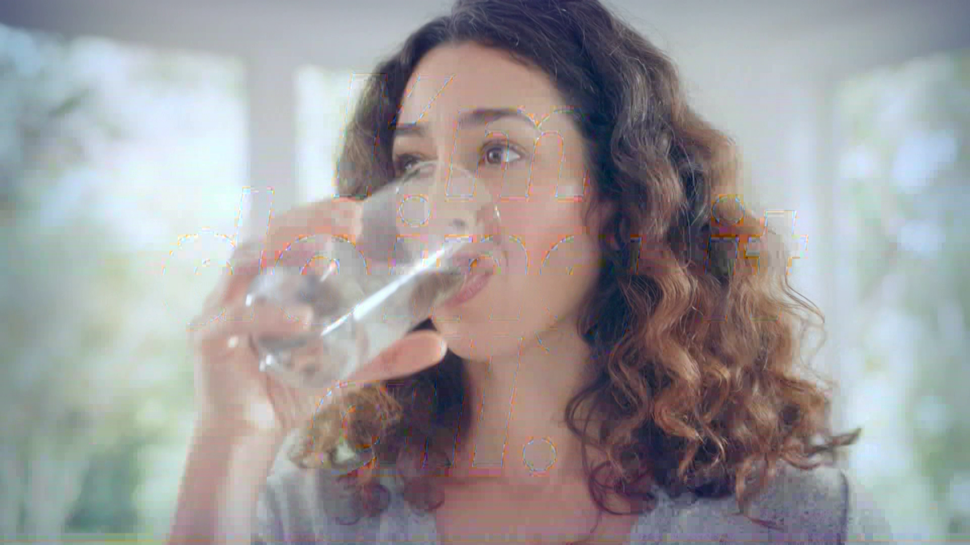

    I'm recording my Spectrum TV with my Elgato HD60s through HDMI with Amarec.

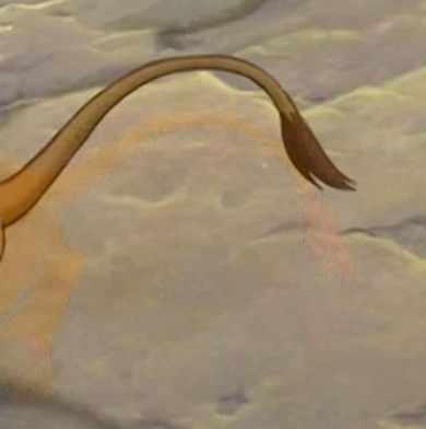

    I found that whenever there's a scene cut or whatever its called it seems to have some sort of trailing or something.
    [Attachment 49557 - Click to enlarge]
    It's more obvious when there's a 24fps source playing.
    [Attachment 49558 - Click to enlarge]

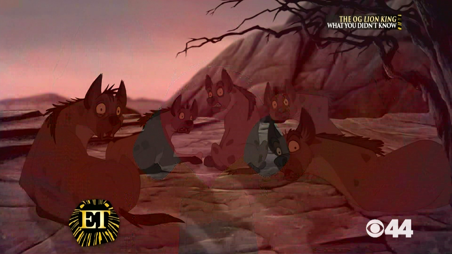

    I've noticed in one file that it feels like its doing motion interpolation (even though its not the case). (example should be attached, albeit trimmed with vlc since the original file is like 8gb. if its not let me know).

    That clip is totally messed up. First, the bitrate is way too low for the material. Second, interlaced video was encoded progressive. Both of those problems may be responsible for the problem in the first image. The progressive encoding is responsible for the problem in the second image.

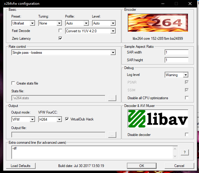

    thats...interesting. i have x264vfw set to --tff so it shouldn't have to encode in progressive.
    [Attachment 49560 - Click to enlarge]
    The bitrate on the original video file is pretty high, looks like VLC screwed it up when i was trimming it then. :P
    Actually I do admit Spectrum doesn't do a good job on some channels when there's high motion imo, hence all the blockiness.
    [Attachment 49561 - Click to enlarge]
    Any way to fix that encoding problem?

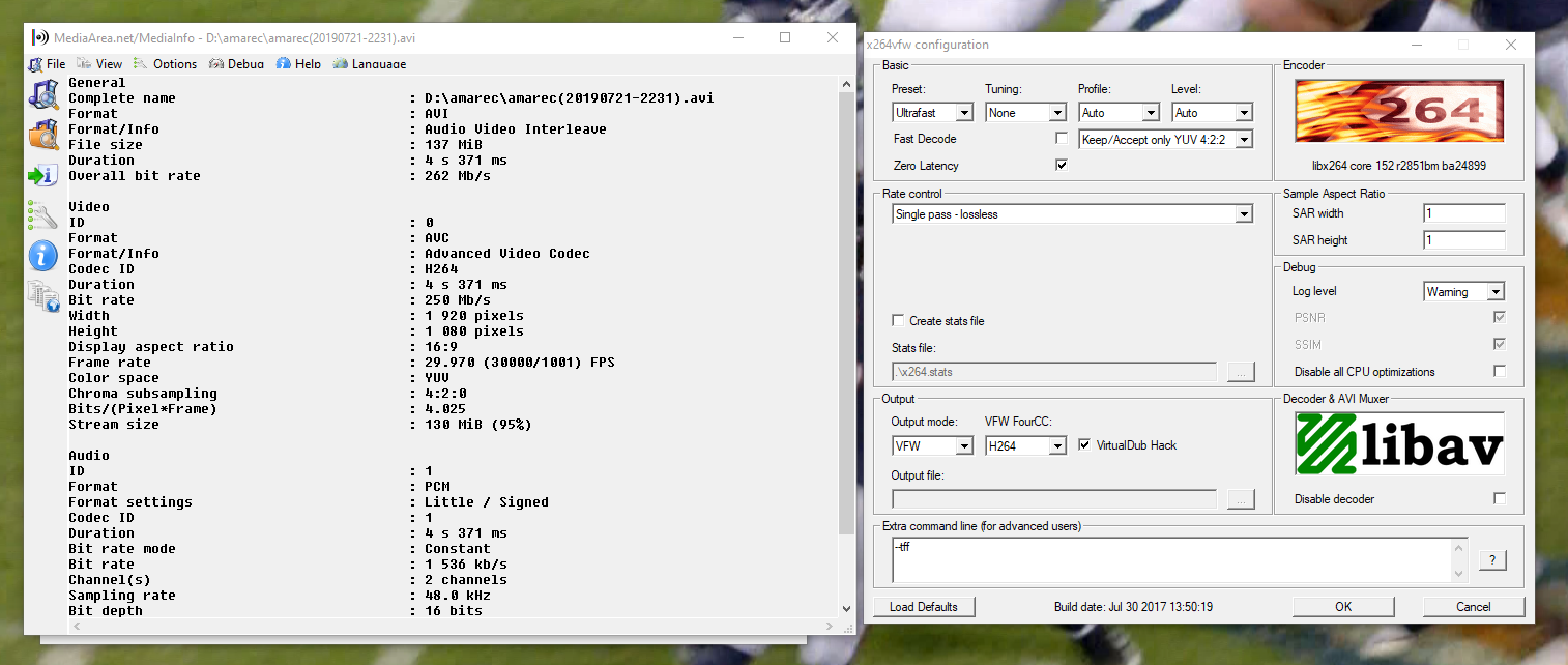

    i could care less about the blocking tbh. im just trying to figure out whats causing it to encode in progressive.
    i use the exact same settings when capturing vhs with my gv-usb2 in virtualdub and its actually encoded interlaced.

    maybe amarec is causing the problem or something? hmmm.
    also it looks like there's still color ghosting dispite it being encoded in interlaced

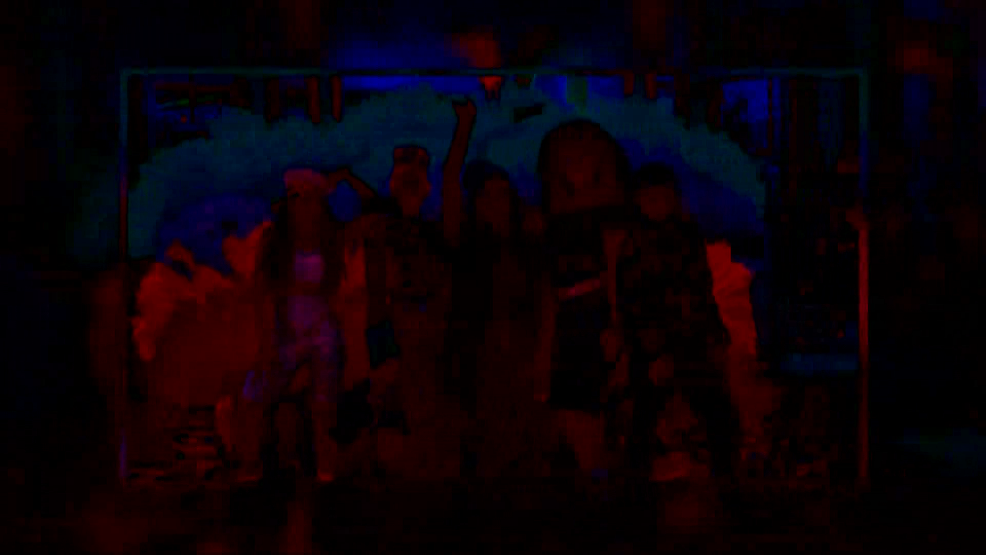

    [Attachment 49564 - Click to enlarge]
    [Attachment 49565 - Click to enlarge]

  10. I remember I had similar problems with Amarec recordings (UTvideo codec used) if I recorded in 4:2:0. What's weird I didn't have that problem in VirtualDub. When I started to use 4:2:2 in Amarec, recordings were without blended chroma.
  11. Be careful, VirtualDub has a similar chroma blending problem with interlaced YV12 (YUV 4:2:0). So if you're using it to produce those images they may not be indicative of what's in the video. I use AviSynth to process the video it before feeding it to VirtualDub so I know it's handled properly.
    And yes, recording in YUY2 (and not letting VirtualDub or the codec convert toYV12) can work around these problems.

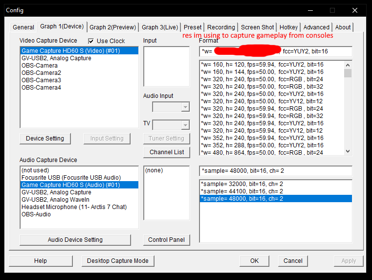

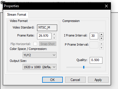

  12. Yes, I learned that the hard way The proper capture should be in YUY2. After that, you process captured file in AviSynth.
    Mar 2019
    Henderson, KY, USA
    my elgato's been set to YUY2 all this time :/

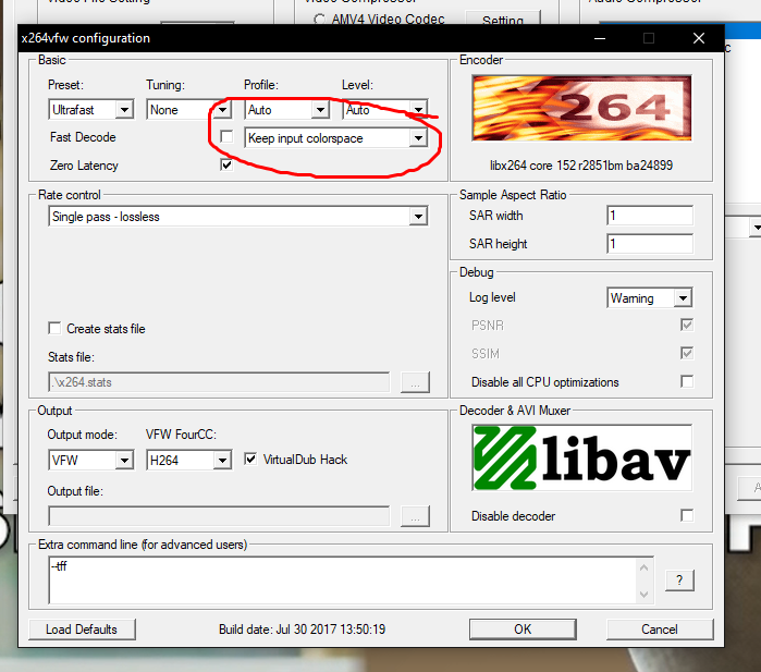

    [Attachment 49573 - Click to enlarge]
    [Attachment 49574 - Click to enlarge]
    edit: i might have fixed the problem. setting the circled option to keep input colorspace seems to fix the issue and i don't notice any ghosting. test file is attached
    [Attachment 49575 - Click to enlarge]
    Well that's good news.

    yeah it has been fixed but on some recordings it looks like it didn't do anything even when other recordings show that it has been fixed (see attached files)
    otherwise it looks like everything's fine. i would check and see if the artifacts show up on a tv but its really really really really hard to tell.

    Did you use x264vfw's "Keep/Accept only YUV 4:2:2" option?
    Originally Posted by ENunn View Post
    Looks like using Utvideo's ULH2 codec seems to fix the 4:2:2 problem, but I'd really like to have a tff flag in it so my recordings are smoother.
    You can always force the field order in an editor/player.
    Mar 2019
    Henderson, KY, USA
    Yep. Still records in 4:2:0.
    How do you do it in VLC? Whenever I force deinterlacing it's really jumpy.
  21. Originally Posted by ENunn View Post
    I don't have anything to capture from. But at the main interface I can set x264vfw to accept/keep YUY 4:2:2 and encode TFF -- the resulting AVI files shows up as 4:2:2 interlaced:
    Standard                                 : NTSC
    Chroma subsampling                       : 4:2:2
    Scan type                                : MBAFF
    Scan type, store method                  : Interleaved fields
    Scan order                               : Top Field First
    I tried that and it still records in 4:2:0.
    [Attachment 49608 - Click to enlarge]

    I have an update. It IS apparently recording in 4:2:2 after all. Mediainfo was displaying the wrong color space apparently.
    I don't notice any color ghosting either, so I guess that's a good sign :P
  24. It's a little hard to tell if there's any color ghosting because everything is the same color and the chroma is very blocky. But I think it's ok. There is some temporal blending in the chroma but that may be because of the over-compression (not by you, but earlier). Definitely better than before.
