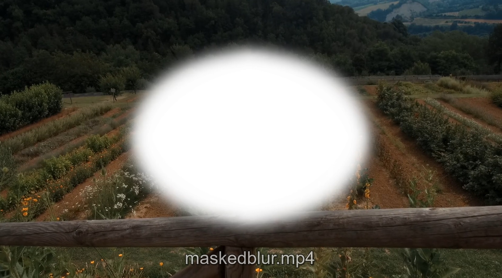

  13. Image
    [Attachment 49588 - Click to enlarge]
    thanks seems to works

    I try to get the blur only on the white zone of the mask file using this ffmpeg commandline:
    ffmpeg.exe -i v:\casola\DJI_0001.MP4 -i d:\bluR4.jpg -filter_complex "[1:v][1:v]alphamerge,boxblur=10[alf];[0:v][alf]overlay[v]" -map "[v]" -an -c:v libx264 maskedblur.mp4
    I get this wrong result:
    [Attachment 49593 - Click to enlarge]
    where is the error in the ffmpeg commandline? and how can I tell to ffmpeg that, possibly, it have to apply the equivalent blur of avisynth B=Blur(0.1,0.5)

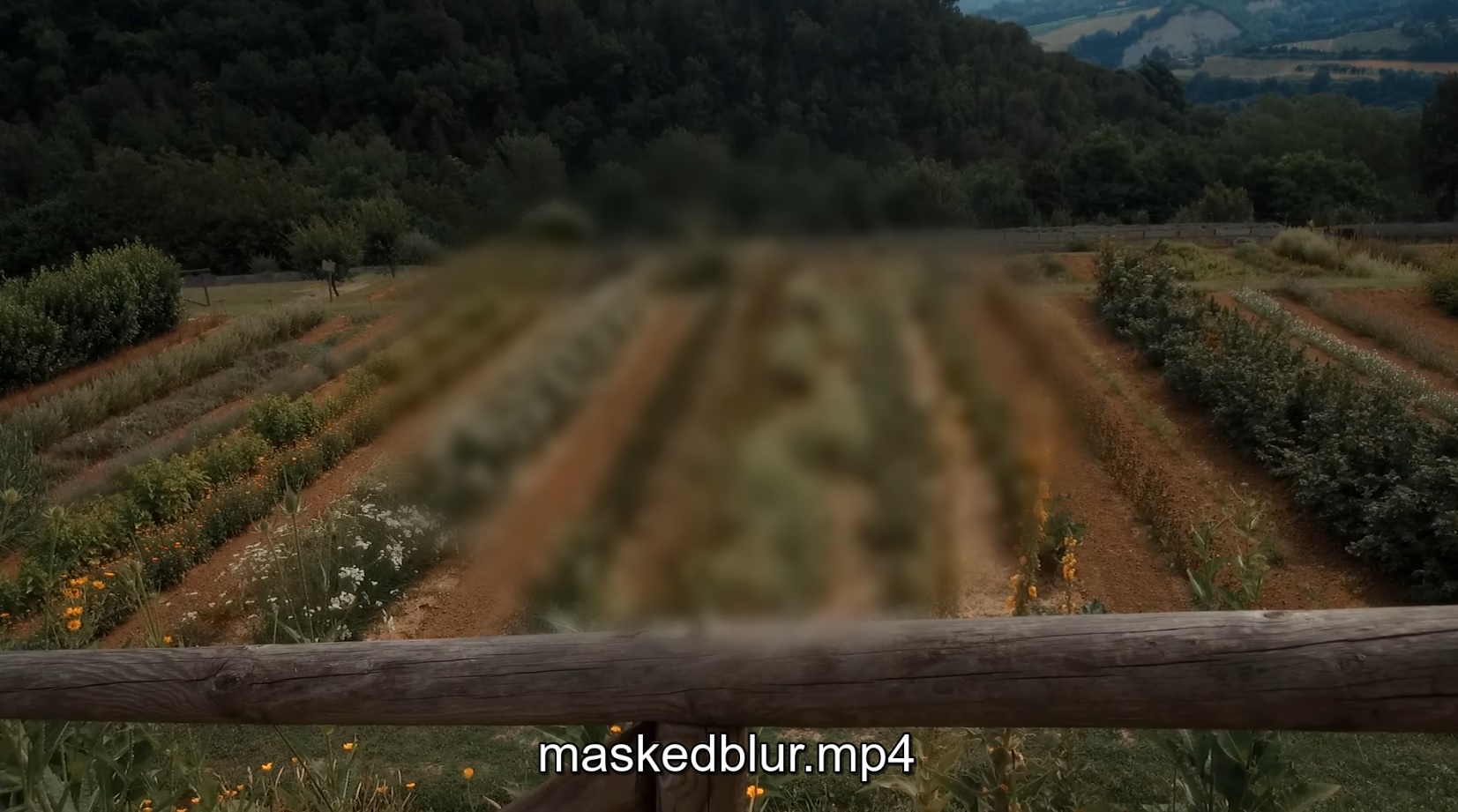

  16. I try this:
    ffmpeg64bit_2019.exe -y -threads auto -i DJI_0001.MP4 -i d:\bluR4.jpg -loop 1 -filter_complex "[0:v][1:v]alphamerge,boxblur=10[alf];[0:v][alf]overlay[v]" -map "[v]" -pix_fmt yuv420p -c:v libx264 -profile:v main -level:v 4.2 -g 33 -bf 2 -crf 22 -flags +ildct+ilme -top 1 -c:a aac -strict -2 -b:a 256k -ar 48000 maskedBlur.mp4
    I get this result:
    [Attachment 49594 - Click to enlarge]
    but the output stream is alwais 50 FPS, at this point I need to apply blur as avisynth (like B=Blur(0.1,0.5)) and interlace using something like
    -vf interlace=lowpass=0:scan=tff
    but where I can intergrate the interlace command in the commandline?

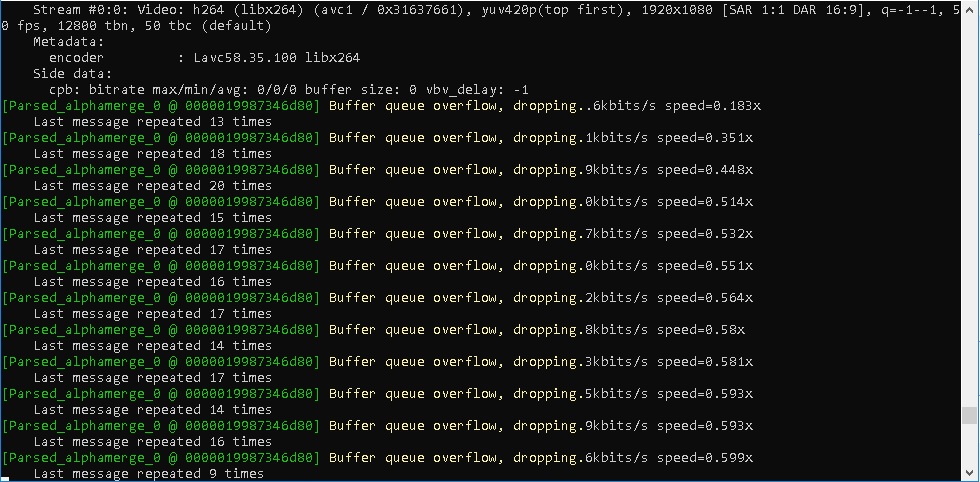

    and why during encoding I get "buffer queue overflow" error?
    [Attachment 49595 - Click to enlarge]
