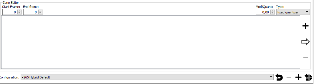

  4. Member Bernix's Avatar
    Apr 2016
    Europe
    Hi,
    i am using hybrid, and there you choose start and end of zone. In chapters i believe you choose just and only start. Noticed zones are in hybrid only at x265, probably overlooked something.
    So without end zone seems to me be weird, but of course can work.
