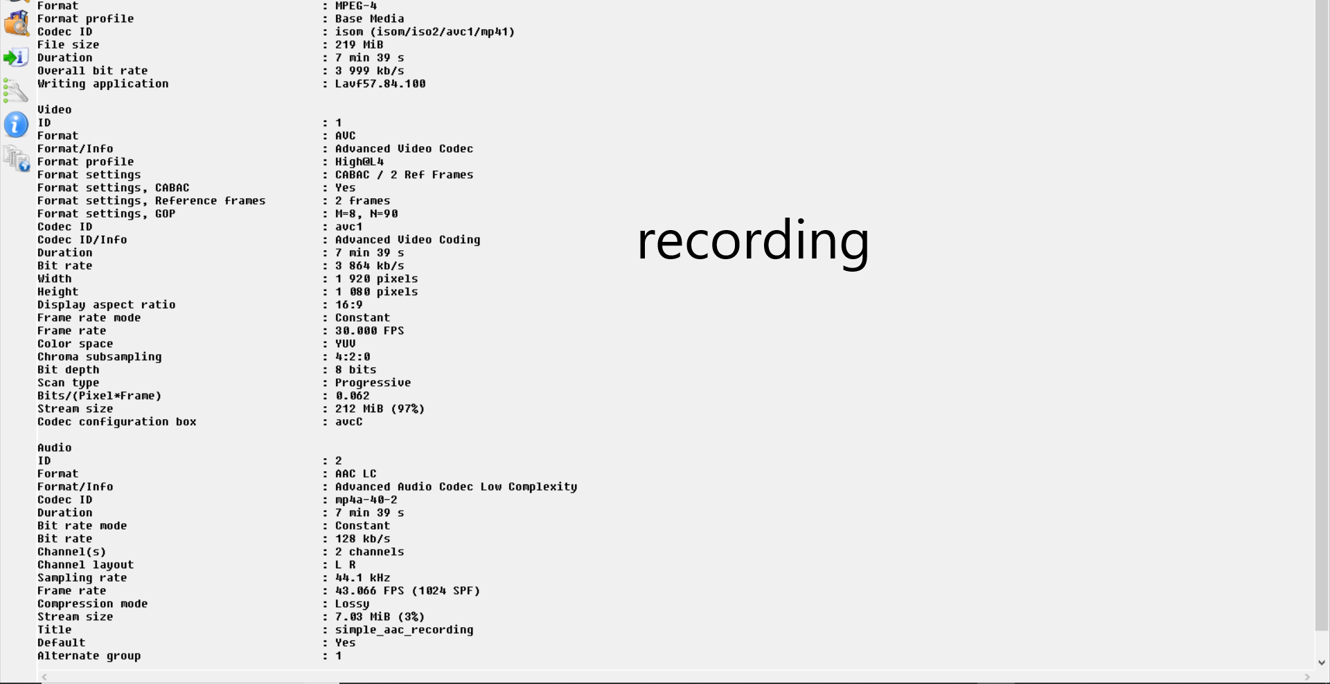

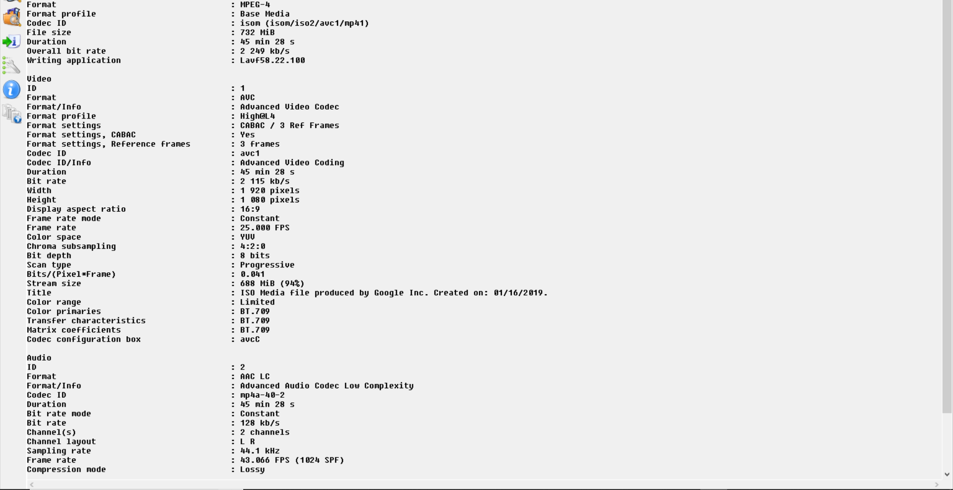

    first is original video info, second is my recording. Audio components can be ignored--I only need the video to work.

    So I guess you are encoding with Intel QuickSync, based on your hardware and the recording mediainfo. The only thing I can think to do is reduce the size of the GOP, as you currently have it set to N=90 which @30fps is 3 seconds per GOP. I learned the hard way that Adobe PP doesn't like HEVC GOPs large than 2 seconds, but I would never expect any modern programs to have an trouble with H.264 content (which you are using). So maybe have a GOP of 2 second or 1 second. Also check your toubled video files in a different media to look for these errors, like VLC or MPC-HC.

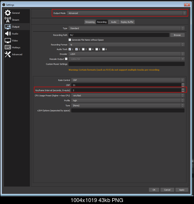

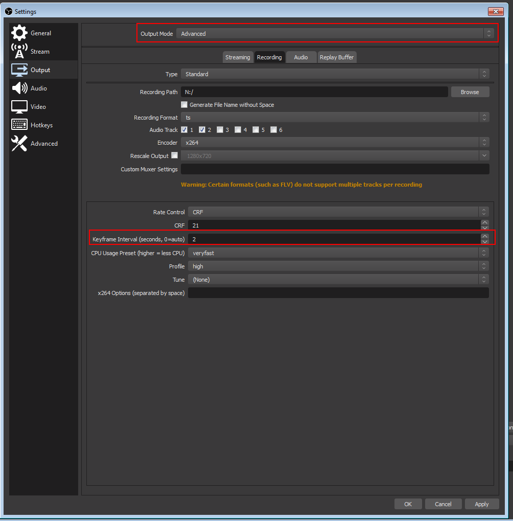

    In the encoding settings menu, in OBS, you can change how many second between GOPs. Maybe try 2 seconds.

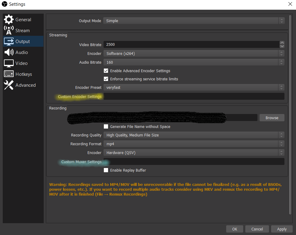

    [Attachment 49604 - Click to enlarge]
    Do you mean what's highlighted in yellow (not blue)? If so, what would I type in?

    Change it to advanced view, and change the Keyframe interval.
