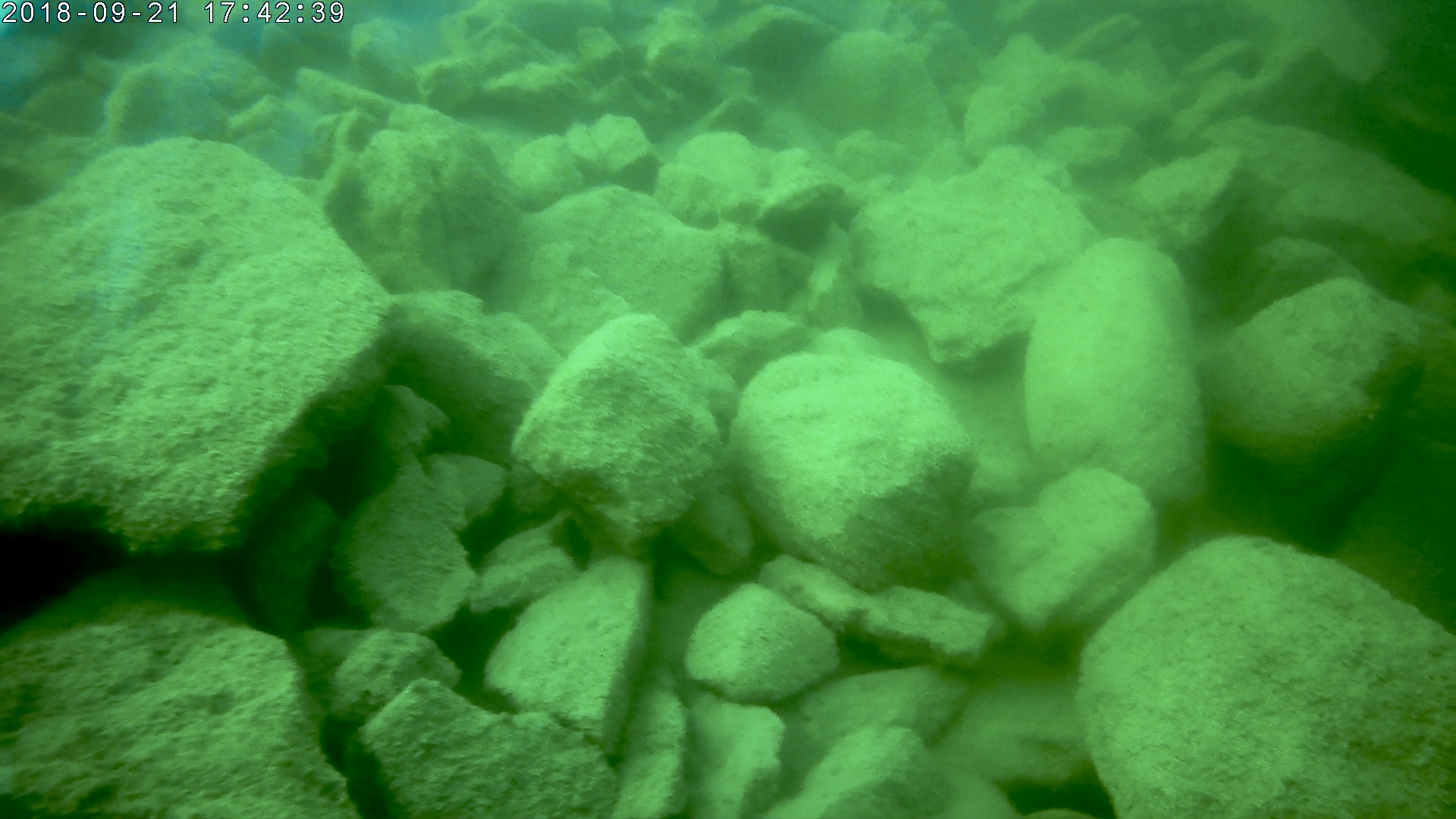

  1. So, I do a lot of green water diving. (Basically in lakes instead of oceans) and I record all my dives with an inexpensive action camera. The quality is really awesome for the price. The issue is (And I am sure it would be the same issue with a more expensive one, save for those specifically built for diving) is the video is very, well, green.
    I have tried a magenta filter, with little success. So I am looking for a software editing solution. When I put a still frame in photoshop and auto correct color and tone, they come out pretty nice. So i am looking for an "Autocorrect" solutions for video. Suggestions?
    I have provided a sample of what i am up against, so you can take a look.

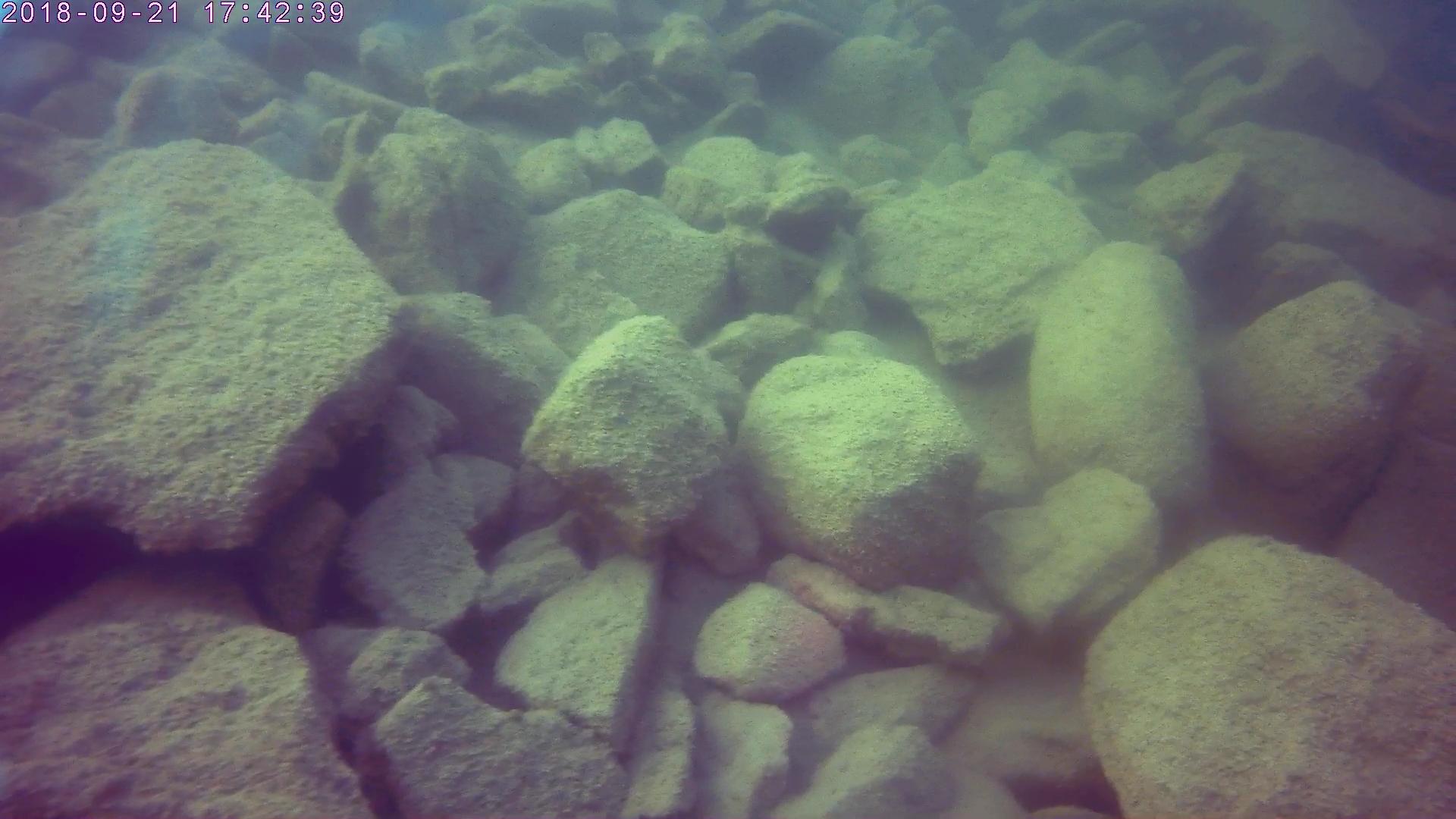

    i wouldn't try to change green to blue, then any thing white will be red. i'd try to soften it a bit and bring out more detail and contrast like this.
    [Attachment 49526 - Click to enlarge]
    vs.
    original
    [Attachment 49527 - Click to enlarge]
