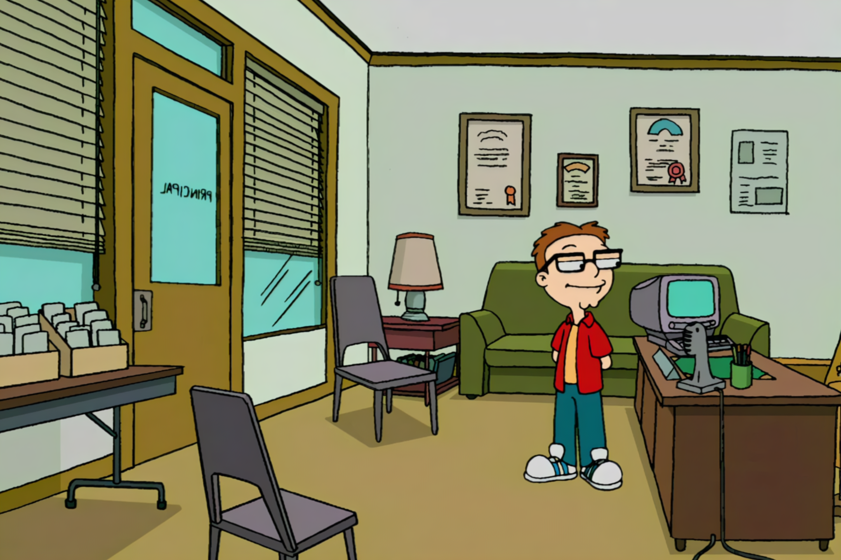

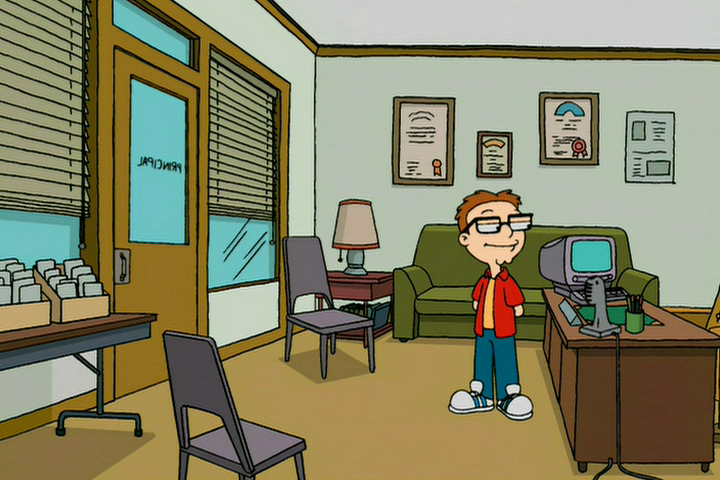

    [Attachment 49506 - Click to enlarge]
    So im trying to efficiently encode these resulting files into x265
    The model trains in a x4 configuration (i can do x2 instead, but its less efficient), so with the resulting 2880x1920, I simply downscale it to 1620x1080 (3:2 ratio here as it seems it was animated in 3:2, it looks way better in 3:2 than 4:3, looks more like the latest seasons.)
    So yeah, its going very well so far

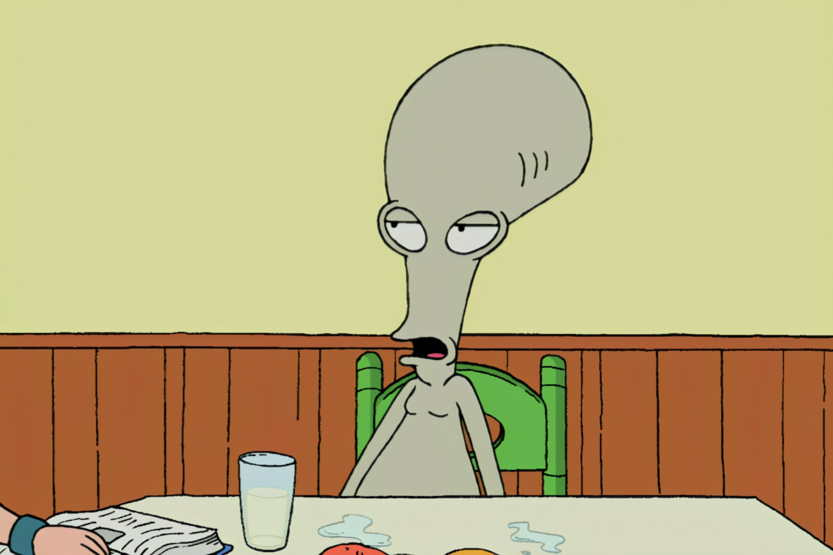

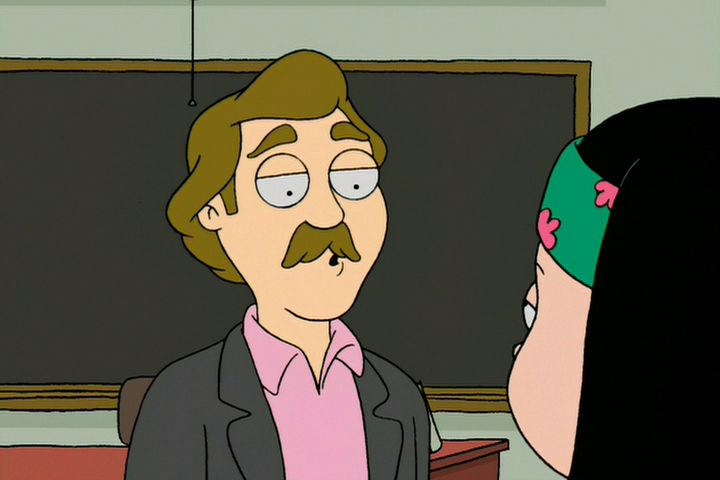

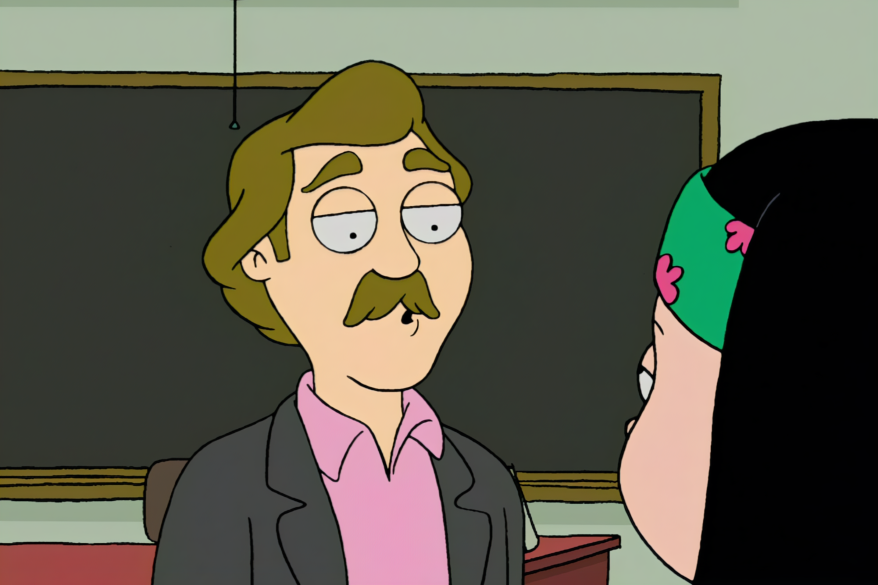

    I trained ESRGAN (using SRRDB Net), and I used BasicSR to do so.
    My setup is a GTX 1080ti running off of CUDA 10.
    It took weeks because I left it training for a long time on purpose to be more efficient.
    And sure,
    [Attachment 49507 - Click to enlarge]
    [Attachment 49508 - Click to enlarge]
    [Attachment 49510 - Click to enlarge]
    [Attachment 49509 - Click to enlarge]
  25. It does a good job - especially on the halos , ringing, edge artifacts
  26. Originally Posted by poisondeathray View Post
    Yes, the cleanup was spectacular.
