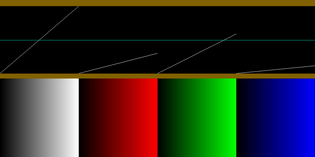

    Then use a higher value. Or use further masking to protect the dark blues. Protecting dark blues will be hard because blue contributes very little to luma. RGB ramps, luma graph at top:
    [Attachment 49500 - Click to enlarge]
    And purifying the blacks and whites won't help at the border between red and yellow for example.
    like I said, you'll always have this problem with VHS caps. Nobody bothers "fixing" it.
