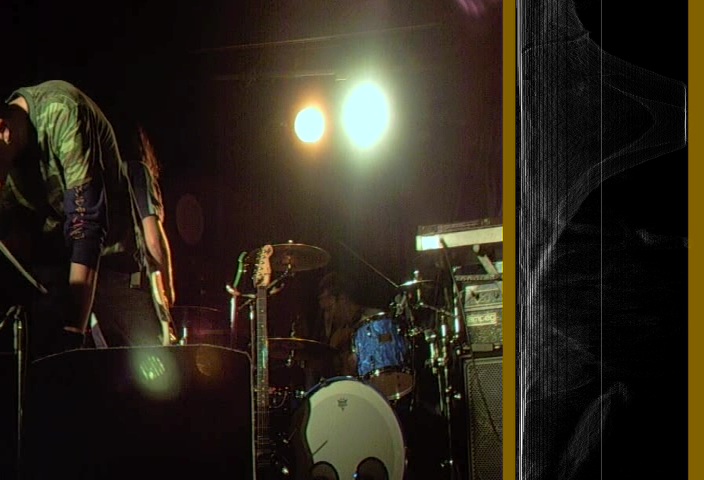

    Looks like i'm having banding issues (note- did't used the depan plugin, only Coloryuv)
    and i went back to LWLibavVideoSource , FFmpegSource2 gave big blocks on occasions
Name:	Sans titre.png
  23. Originally Posted by smartel View Post
    Looks like i'm having banding issues (...Coloryuv)
    Yes, the strong gamma adjustment brings out banding in dark areas. You don't have to use ColorYUV if you don't want. Of you can use less gamma adjustment. Or use SmoothLevels() or SmoothTweak().
