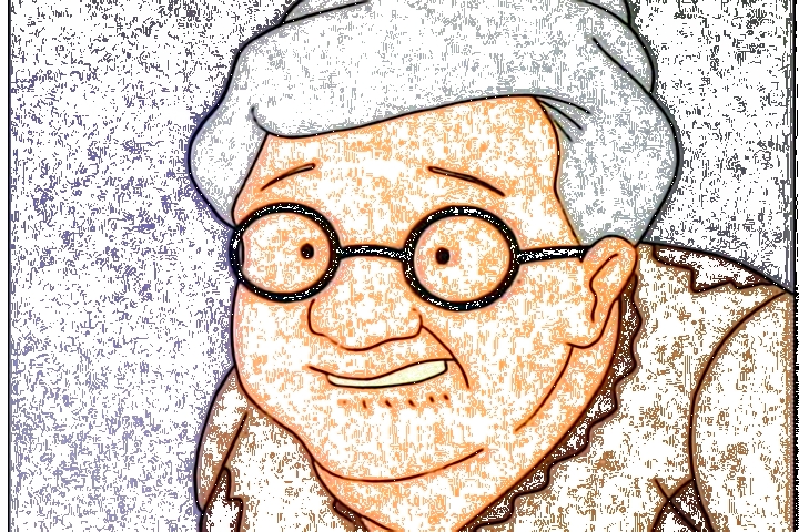

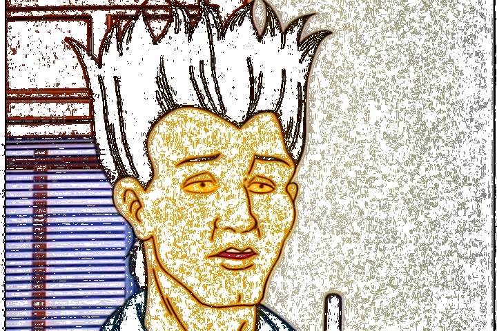

  1. Hello. I'm working with animated content and am trying to do some prefiltering with McTemporalDenoise. I am trying to avoid all lines and edges, which my current script seems to be doing quite well. I am using mt_edge("prewitt). My problem is that, as you can see in my sample images, although it seems like I have the right idea with my current script, the filter does not seem to cover 100% of the image (which, as I stated, I wish to filter minus the lines). Please see my image samples---I used white as a color test for a visual of what I'm trying to do here. Is there any way I can tweak this to cover the entire area but still avoiding the lines?
    [Attachment 49472 - Click to enlarge]
    [Attachment 49473 - Click to enlarge]
    I am using the following script:
    MPEG2Source("blah.d2v", cpu=0)
    TFM(d2v="blah.d2v")
    TDecimate(mode=1)
    #Include a sharpener FIRST so that your lines can be very dark, thus the mask protecting them.
    Toonlite()
    Santiag(). TurnRight(). Santiag().TurnLeft()
    a=last
    g=blankclip(a, color=color_white)
    #mask:
    mask = mt_edge("prewitt"). mt_invert()
    # Overlay of clip, filter, and mask
    Overlay(a,g,mask=mask)
    Attached also is a sample video.
    Thanks.
  2. Use mt_expand() to thicken the edges, mt_inpand() to thin them. Something like:
    mask = mt_edge("prewitt").mt_inpand().mt_expand().mt_expa nd().mt_inpand().mt_invert()
    The first mt_inpand() eliminates a lot of the noise areas (or use a noise reduction filter before building the mask). mt_expand() expands the edges to fill in the "holes". The final mt_inpand() thins the edges. You'll probably want to soften the edges of the mask with a blur.
    Or use a noise reduction filter that's better at retaining edges, like TemporalDegrain2().

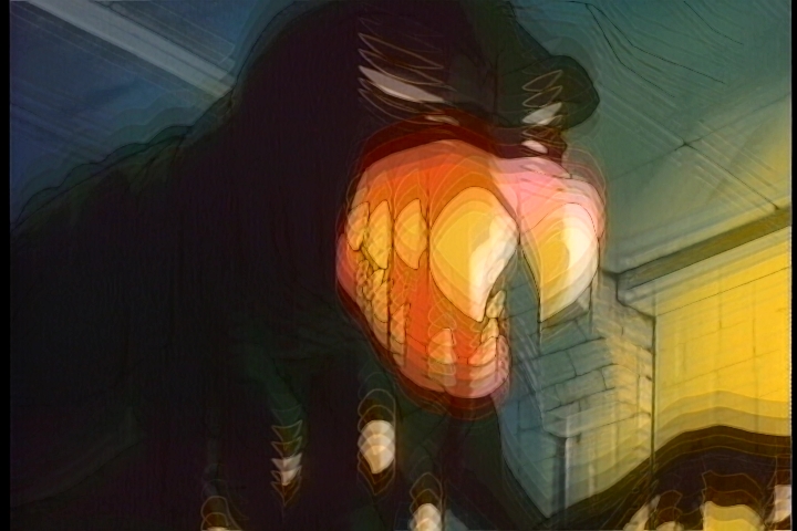

  4. Or use a noise reduction filter that's better at retaining edges, like TemporalDegrain2()
    I just tried it. I notice that yes, it does retain the edges but it blurs the image like crazy. My eyes hurt just looking at it. Take a look. I've dealt with this filter before and have tried to tweak it with no success. Is there something I'm missing?
    [Attachment 49475 - Click to enlarge]
  5. Never seen it do anything like that. That shot isn't in your video sample.
  6. Is there something in my script order that shouldn't be there that's probably making it do that?
    I use crop(), addborders(), then I IVTC and then do some color tweaking. Then I add temporaldegrain2().
  7. It's not, but it's still part of the clip. Nevertheless, temporaldegrain2() is still causing that type of result in the whole clip. Maybe I have an old version? Do you have an updated script that perhaps I can use? I'd appreciate it.
