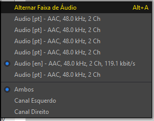

    Hello guys! I would like to know, somehow it is possible to capture m3u8/vod with multiply audio options??
    Does anyone know of any method or code??
    I'm trying to record a livestreming that has two audio options. When I open m3u8 with PotPlayer, I can select which audio I want to watch, but when I download with some method that I found as the livestreamer or ffmpeg, i only get the video with only one of these two options... I wanted to be able to capture the video with all audios.

  13. Member Emeritus
    May 2014
    streamlink 1.1.1 will also mux multiple hls audio streams. See stream.hls: change --hls-audio-select to take a list and wildcard #1591
    Example command line using --hls-audio-select with wildcard:
    streamlink "hlsvariant://h..ps://content.uplynk.com/channel/8790953821a540c78eceafc3e1b7ae7c.m3u8?<auth params>" best --hls-audio-select * -o output.ts
    Edit: Above streamlink command line works perfectly with OP's content.
    While ffmpeg may occasionally skip segments or otherwise produce an inferior output file.
    Sorry my late guys. Yes!! This one worked!!! But... the second audio (Ensligh) have delay Is that common ??
