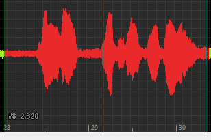

I am editing SRt files, and they go by timestamps and not framerates. Sometimes I am required to set the In-time of the subtitle 5 frames before the Shot Change, but the audiowave is showing timing in seconds and not frames. So How can I define them please?
[Attachment 49469 - Click to enlarge]
This is screenshot is a subtitle and the white line is the SC. So in case I need to set the In-time of a subtitle 5 frames before SC, how can I do that? Or how can I know to set it please?

I'll assume this is for PAL 25fps video. 5 frames is 20% of the 25fps. Therefore 5 frames before the scene change is 20% of a second or 200ms. Set it 200ms before the scene change
Seems like kind of a lot to me. If I were doing it I'd only make sure it doesn't go into the next scene.

In your earlier reply I asked to set 5 frames before SC and you said that 5 frames is 20% so 200 Ms is the correct value for 5 frames before SC
Let's say that I want to define 7 frames before or after SC, should the same thing apply please?
Please help me in this, I am weak somehow in calcutations. -
The example I gave earlier was a way to convert absolute frame number to time. The same equation works for relative calculations. If you have at an event at time SC but need to know the time 7 frames earlier just subtract the result of the equation:
Code:New Time = SC - (7 * 0.04) New Time = SC - 0.28. for example, if SC = 1:23.45, New Time = 1:23.17
OK, I got this point, thanks.
So far I get you, but where does that value of frame number (12345) comes from please? How to define it?
Also, guys, assuming now that I have defined that 7 frames equal 280 Ms. How can I define that 280 Ms on Subtitle Edit? Any ideas about this please?
Thank very much for your help so far. I really appreciate it. -
It's just a random frame number I picked to use as an example. Frame number 12345 of a 25 fps video starts at 8 m 13.8 s into the video (assuming the video starts at 0).
You haven't defined 7 frames as equal to 280 ms. You've determined that 7 frames is 280ms using the given equation.
You subtract 280 ms from your reference time.
