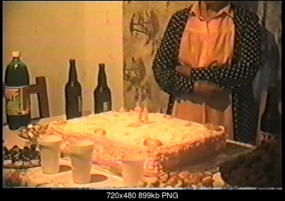

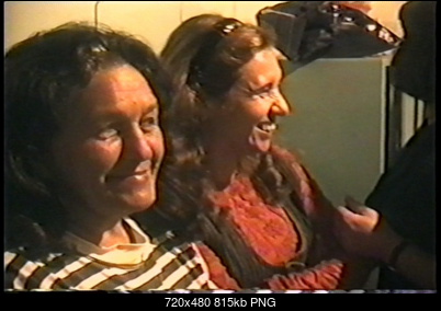

    I'm capturing an old VHS to a friend, and bellow is an example how the quality of this VHS is:
    I don't have so much experience with avisynth, and I'm having difficult to do some adjusts.
    Do you have some tips, for avisynth, that can help me adjusts the colous of this VHS?
    Maybe some way to reduce theese "orange" colours, and increase others.
    (I think that this orange is much because of an ambient with incandescent illumination).
    I already make somes atempts with RGBAdjust, but, dont reach goods results
    If you need more images, or some video sample, let me know.

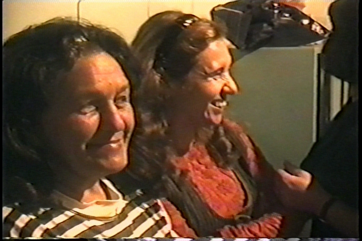

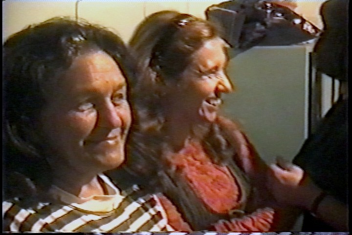

  6. Here's what I got from the video, ~same frame as the first image in the original post:
    [Attachment 49470 - Click to enlarge]
    AviSource("sample(1).avi")  # YUY2 source
    AssumetFF()
    ConvertToRGB(matrix="rec601")
    RGBAdjust(rb=-14, gb=-18, bb=-17) # blacks to ~0
    RGBAdjust(r=0.87, b=1.25) # white balance
    RGBAdjust(rg=1.3, gg=1.3, bg=1.3) # gamma to lighten the shadows a bit
    ConvertToYUY2(matrix="rec601")  # back to YUY2

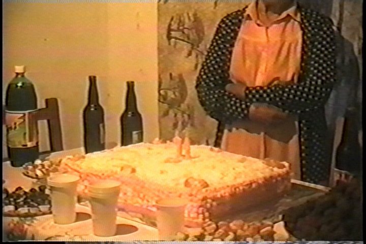

    The earlier portion with the cake is still very yellow though.

    Thank You jagabo! I think that this will help. Maybe somes adjusts here and there, and will be good.
    My problem with ColorYUV(autowhite=true) is most because I can't make adjusts.
