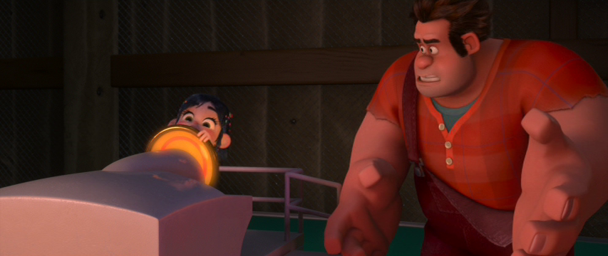

    Original Source screenshot:
    [Attachment 49433 - Click to enlarge]
    Handbrake encode screenshot:
    [Attachment 49434 - Click to enlarge]

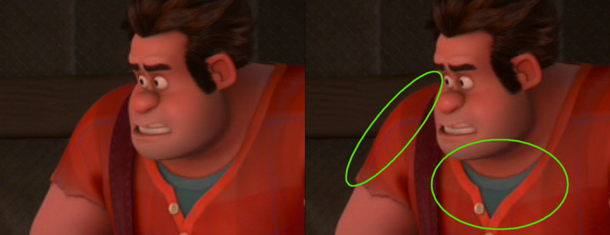

    Zoomed Side-by-side:
    [Attachment 49436 - Click to enlarge]

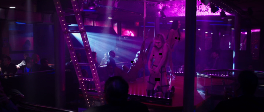

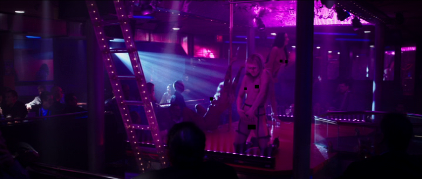

    Second Sample:
    Deadpool
    WARNING:Censored, but screenshots may be NSFW for some viewers
    Encode settings in Handbrake:
    Video:
    Video Codec: H.264 (x264)
    Framerate (FPS): Same as source
    Variable Framerate
    Avg Bitrate (kbps): 6271
    Encoder preset: VerySlow
    Encoder Tune: None
    Encoder Profile: High
    Encoder Level: Auto
    Filters:
    Detelecine: Off
    Interlace Detection: Off
    Deinterlace: Off
    Denoise: Off
    Sharpen: Off
    Deblock: Off
    Original Source MediaInfo:
    Format                                   : MPEG Video
    Bit rate                                 : 6 271 kb/s
    Frame rate                               : 23.976 (24000/1001) FPS
    Handbrake encode MediaInfo:
    Encoding settings                        : cabac=1 / ref=16 / deblock=1:0:0 / analyse=0x3:0x133 / me=umh / subme=10 / psy=1 / psy_rd=1.00:0.00 / mixed_ref=1 / me_range=24 / chroma_me=1 / trellis=2 / 8x8dct=1 / cqm=0 / deadzone=21,11 / fast_pskip=1 / chroma_qp_offset=-2 / threads=11 / lookahead_threads=1 / sliced_threads=0 / nr=0 / decimate=1 / interlaced=0 / bluray_compat=0 / constrained_intra=0 / bframes=8 / b_pyramid=2 / b_adapt=2 / b_bias=0 / direct=3 / weightb=1 / open_gop=0 / weightp=2 / keyint=240 / keyint_min=24 / scenecut=40 / intra_refresh=0 / rc_lookahead=60 / rc=2pass / mbtree=1 / bitrate=6271 / ratetol=1.0 / qcomp=0.60 / qpmin=0 / qpmax=69 / qpstep=4 / cplxblur=20.0 / qblur=0.5 / ip_ratio=1.40 / aq=1:1.00
    [Attachment 49437 - Click to enlarge]
    [Attachment 49438 - Click to enlarge]

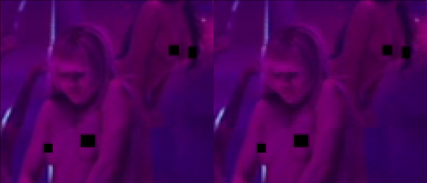

    [Attachment 49439 - Click to enlarge]

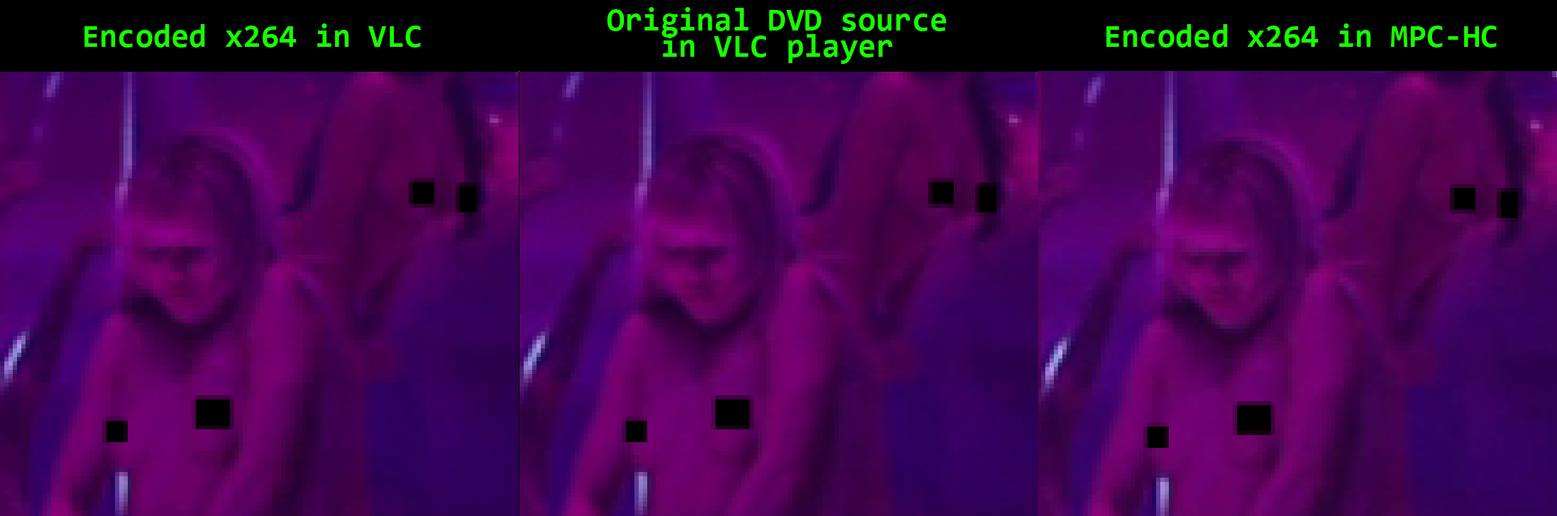

  2. Any chance VLC is messing up making the screenshots? Try a "second opinion" (e.g. MPC-HC+madvr) for the screenshots. Or cut an identical scene from both using mkvmerge and upload here for us to reproduce. Show HandBrake activity log.
  3. What's the frame size of the h.264 videos? Use MediaInfo in text mode to get full stats.

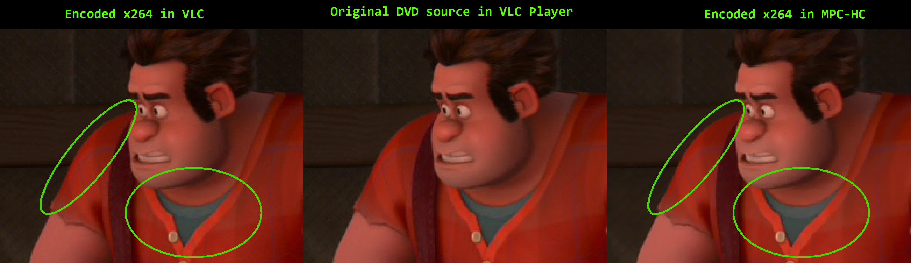

  4. I've extracted screenshots from MPC-HC. The issue is not as pronounced in MPC-HC as it is in VLC, however it is still there. As I said in the original post, once I start moving down the bitrate / quality settings, the blocky or pixelated grouping is far more pronounced. I also have posted below the full Handbrake activity log from both encodes as well as the MediaInfo output of the x264 encoded files. I am unsure of what you mean and how to
    Wreck It Ralph

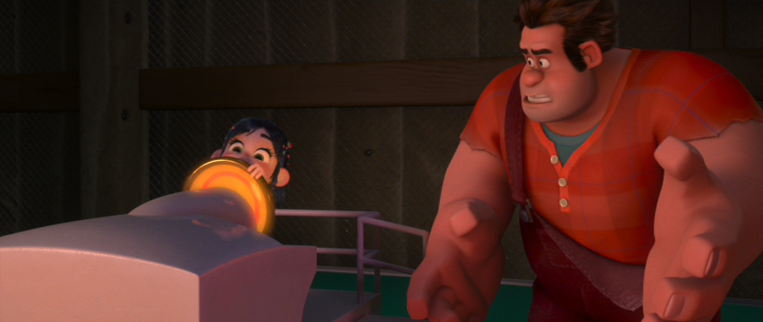

    Handbrake encode screenshot in MPC-HC:
    [Attachment 49455 - Click to enlarge]
    [Attachment 49456 - Click to enlarge]

    File size                                : 118 MiB
    Duration                                 : 2 min 51 s
    Overall bit rate                         : 5 780 kb/s
    Movie name                               : WRECK_IT_RALPH
    Encoded date                             : UTC 2019-06-23 04:32:12
    Writing application                      : HandBrake 1.2.2 2019022300
    Writing library                          : Lavf58.20.100
    ErrorDetectionType                       : Per level 1
    Video
    Format profile                           : High@L3.1
    Format settings                          : CABAC / 16 Ref Frames
    Format settings, Reference frames        : 16 frames
    Codec ID                                 : V_MPEG4/ISO/AVC
    Bit rate                                 : 4 996 kb/s
    Width                                    : 720 pixels
    Height                                   : 360 pixels
    Display aspect ratio                     : 2.40:1
    Frame rate mode                          : Constant
    Bits/(Pixel*Frame)                       : 0.804
    Stream size                              : 99.8 MiB (85%)
    Writing library                          : x264 core 157 r2935 545de2f
    Encoding settings                        : cabac=1 / ref=16 / deblock=1:0:0 / analyse=0x3:0x133 / me=umh / subme=10 / psy=1 / psy_rd=1.00:0.00 / mixed_ref=1 / me_range=24 / chroma_me=1 / trellis=2 / 8x8dct=1 / cqm=0 / deadzone=21,11 / fast_pskip=1 / chroma_qp_offset=-2 / threads=11 / lookahead_threads=1 / sliced_threads=0 / nr=0 / decimate=1 / interlaced=0 / bluray_compat=0 / constrained_intra=0 / bframes=8 / b_pyramid=2 / b_adapt=2 / b_bias=0 / direct=3 / weightb=1 / open_gop=0 / weightp=2 / keyint=240 / keyint_min=24 / scenecut=40 / intra_refresh=0 / rc_lookahead=60 / rc=2pass / mbtree=1 / bitrate=4996 / ratetol=1.0 / qcomp=0.60 / qpmin=0 / qpmax=69 / qpstep=4 / cplxblur=20.0 / qblur=0.5 / ip_ratio=1.40 / aq=1:1.00
    Default                                  : Yes
    Forced                                   : No
    Color range                              : Limited
    Color primaries                          : BT.601 NTSC
    Transfer characteristics                 : BT.709
    Matrix coefficients                      : BT.601
    Audio #1
    Format                                   : AC-3
    Format/Info                              : Audio Coding 3
    Commercial name                          : Dolby Digital
    Codec ID                                 : A_AC3
    Duration                                 : 2 min 50 s
    Bit rate mode                            : Constant
    Bit rate                                 : 384 kb/s
    Channel(s)                               : 6 channels
    Channel layout                           : L R C LFE Ls Rs
    Sampling rate                            : 48.0 kHz
    Frame rate                               : 31.250 FPS (1536 SPF)
    Bit depth                                : 16 bits
    Delay relative to video                  : 25 ms
    Stream size                              : 7.82 MiB (7%)
    Title                                    : Surround
    Language                                 : English
    Service kind                             : Complete Main
    Default                                  : Yes
    Forced                                   : No
    Audio #2
    Format                                   : AC-3
    Codec ID                                 : A_AC3
    Bit rate                                 : 384 kb/s
    Bit depth                                : 16 bits
    Title                                    : Stereo
    Language                                 : English
    Default                                  : No
    Forced                                   : No
    Text #1
    Format                                   : VobSub
    Codec ID                                 : S_VOBSUB
    Codec ID/Info                            : Picture based subtitle format used on DVDs
    Duration                                 : 2 min 49 s
    Language                                 : English
    Default                                  : No
    Forced                                   : No
    Text #2
    Format                                   : VobSub
    Codec ID                                 : S_VOBSUB
    Language                                 : English
    Default                                  : No
    Forced                                   : No
    Text #3
    Format                                   : VobSub
    Codec ID                                 : S_VOBSUB
    Language                                 : Spanish
    Default                                  : No
    Forced                                   : No
    Text #4
    Format                                   : VobSub
    Codec ID                                 : S_VOBSUB
    Duration                                 : 1 min 41 s
    Language                                 : Spanish
    Default                                  : No
    Forced                                   : No
    Text #5
    Format                                   : ASS
    Codec ID                                 : S_TEXT/ASS
    Codec ID/Info                            : Advanced Sub Station Alpha
    Compression mode                         : Lossless
    Language                                 : English
    Default                                  : No
    Forced                                   : No
  5. And here is the requested info for the second sample as I was not able to have it in the post above due to post character limits:
    Deadpool
    [Attachment 49461 - Click to enlarge]
    [Attachment 49462 - Click to enlarge]

  6. I don't think the problem is with your encoding but rather with your graphics card's upscaling. In VLC, try switching Video -> Output to Windows GDI Video Output, and disable hardware decoding (Input/Codecs -> Hardware-accelrated Decoding -> Disable). Does that look better?
