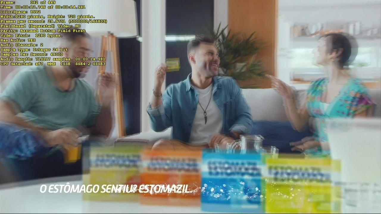

  1. I'm having problems converting some FTA sources from ISDB system captured as 1280x720@59.940, some sources has progressive video with some sort of interlaced text overlay, others has progressive text over interlaced video. In 90% of the cases the script bellow works like a charm, but this is not the case for this video, it generates a 47.952 fps video:
    ConvertToYV12(matrix="Rec709",interlaced=no)
    QTGMC().SelectEven()
    vInverse()
    TDecimate()
    Other options I tried:
    TFM().TDecimate(Mode=1)
    TFM(CThresh=10).TDecimate()
    This kind of works, but it's mess.
    AssumeBFF()
    SeparateFields()
    SelectEvery(4,0,3)
    Weave()
    vInverse()
    [Attachment 49432 - Click to enlarge]
    I don't know what else to try, here a sample with no audio.
    https://drive.google.com/file/d/11e2yPF8zJEhyeU4C_kzLp7bYKUxdkpP1/view?usp=sharing
    I'm new to avisynth, I've tried different options, other tools for two days but I can't get it done by myself, if I fix one thing it breaks the other.
    Thanks.
  2. If possible, you probably shouldn't capture in RGB32.
    The source is 59.94fps. You apply QTGMC you double the framerate. You apply SelectEven you bring it back to 59.94fps. You apply TDecimate you get 47.952fps. You don't need Vinverse. To do it right, one way is:
    SelectEven()
    TDecimate()
  3. That AVI file isn't interlaced. It's already been bob deinterlaced, poorly. You can restore the original film frames with TDecimate(Cycle=10, CycleR=6). But do yourself a favor and capture 1080i instead and use TFM().TDecimate(). And capture YUV, not RGB.
    It's not unusual for titles to be overlaid as interlace video onto telecined film. With such video you cannot decimate and get smooth motion of both the titles and the underlying film.

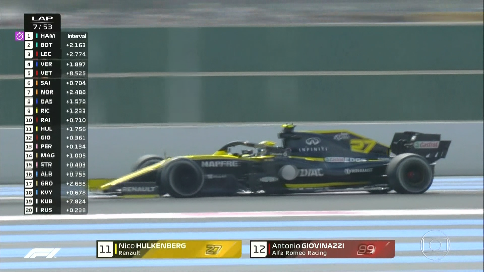

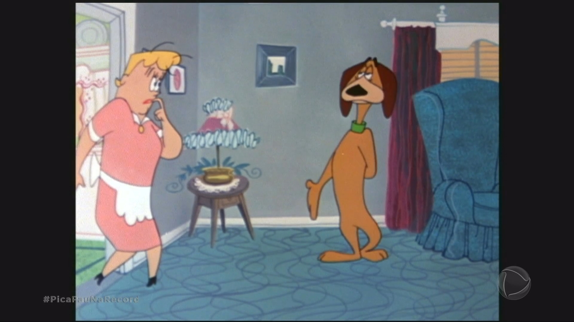

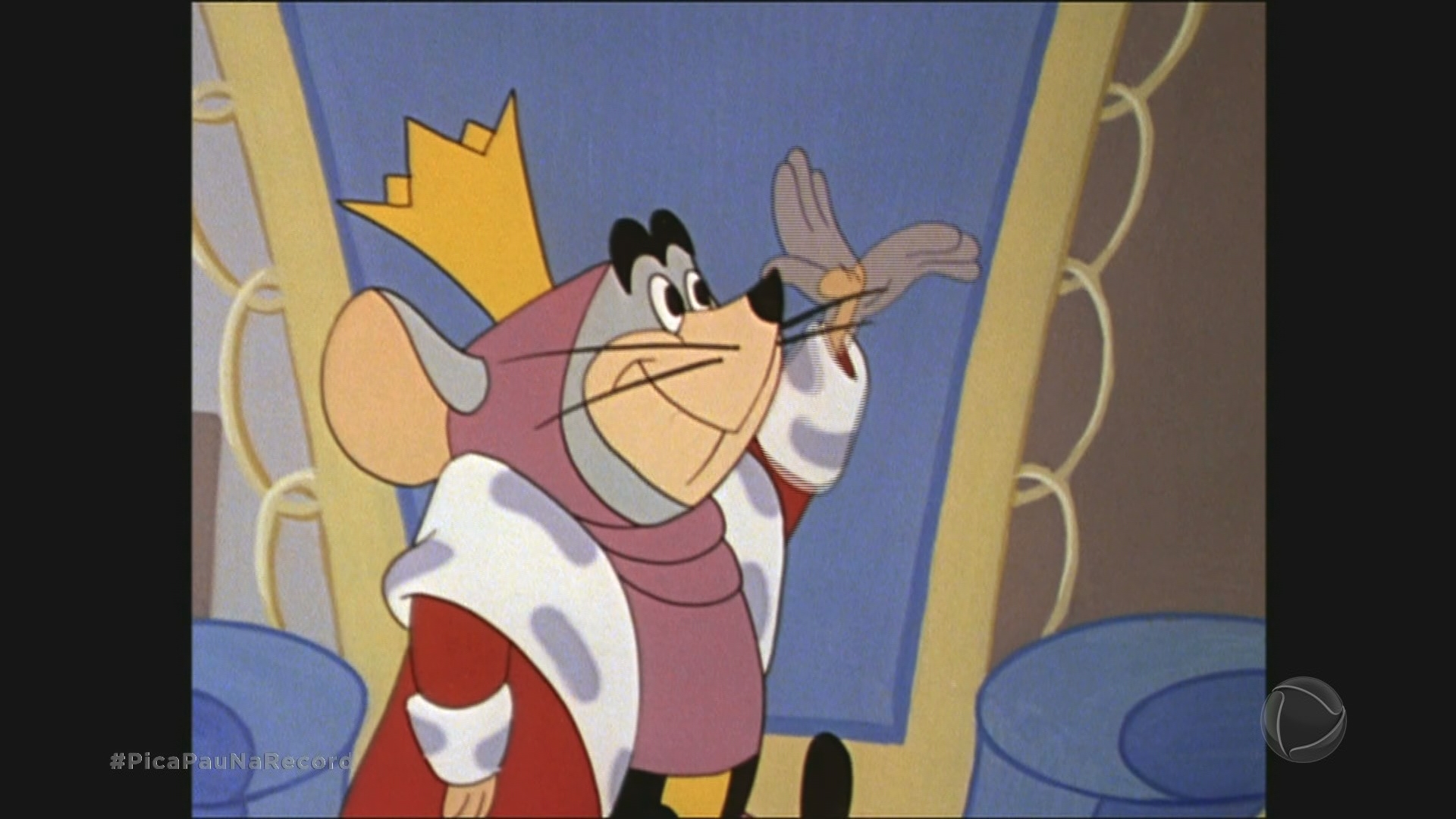

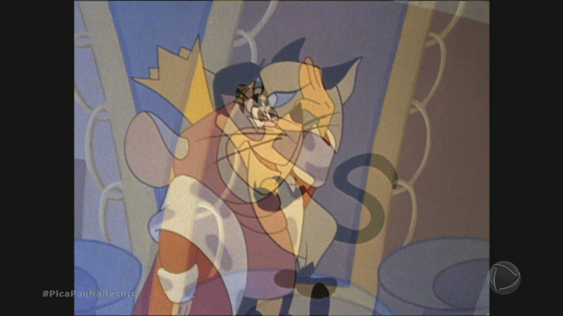

  7. I'm waiting for commercials but none so far, this is what I have for now, 1080i@29.970. Sorry for not sharing any YUV 8 bit capture because this is too much, the samples was converted to H264 4:2:2 instead:
    [Attachment 49443 - Click to enlarge]
    [Attachment 49440 - Click to enlarge]
    [Attachment 49441 - Click to enlarge]
    [Attachment 49442 - Click to enlarge]
    I see standard interlacing, nothing a basic QTGMC() can't handle in the F1 racing, but I would like some advice with the old cartoon.
  8. Sample2.avi is simple telecined film. Use AssumeTFF().TFM().TDecimate(). Sample3.avi is interlaced video. Use QTGMC or Yadif.
  9. Oh, I just noticed the fade to black at the end of sample2 is on a field by field basis. I don't think it's necessary to retain that so I'd just use TFM and TDecimate as I suggested before.
  10. Thank you jagabo!

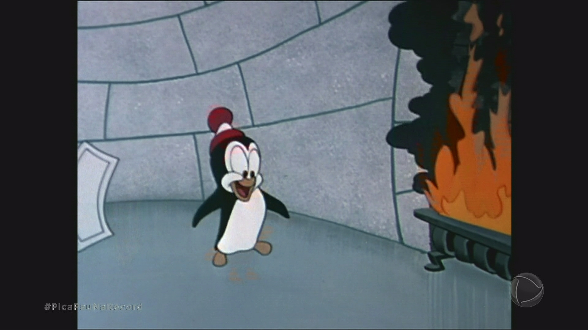

  11. I'm seeing this color issues around the fire, head and feet.
    [Attachment 49446 - Click to enlarge]
    I'm including the converted and original without "TFM().TDecimate()".
    Sorry for the trouble.
  12. Somewhere along the line interlaced YUY2 was converted to YV12 without consideration for the interlacing. If you did the conversion with ConvertToY12() use ConvertToYV12(interlaced=true) instead.
  13. Hey jagabo, sorry I'm late.
    That did the work, thanks!!!
