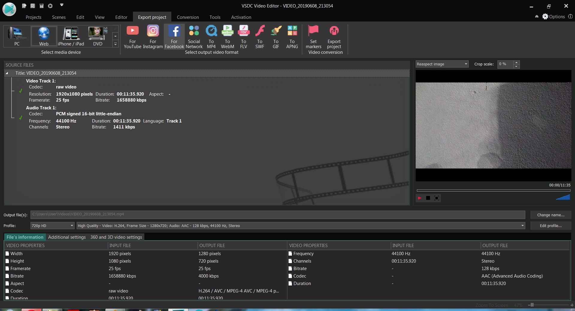

    Hello Sneaker, I should have mentioned that I am New to Editing! I'm using the VSDC Editing software, which I know is an amateur outfit, but still has many of the professional functions for Video & Audio. as far as your other questions I'm not sure about those settings! I uploaded an IMAGE of the Editor in Export Mode which may be of some help! VSDC allows me to export directly to Social Media configurations, and that is all I am now doing! Which in itself may be my Problem! ..I'm mainly trying to get fairly decent videos for posting on Social Media. Thanks

  5. It is exactly as poisondeathray says. With your video open in the timeline, import your new audio track, and with it un-linked move it to sync it up. Mute the original video's audio track and link everything. Now you can edit it as a single entity. If VSCD cannot do this simple task, I would suggest you edit with something else.
    If the quality of your exported video is worse than the original footage, you are probably using too low a bit rate.
