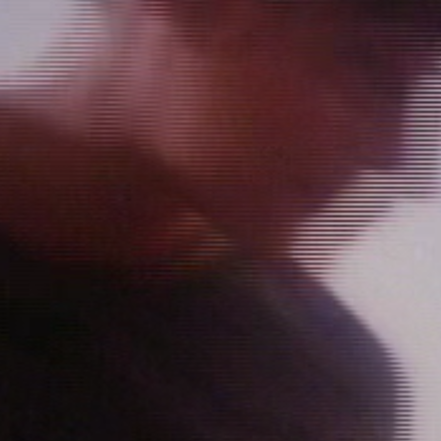

    I suppose this transition is what's causing this video to appear interlaced during the last scene even though it is progressive throughout (well it's 25i but there's zero combing or duplicate frames).
    But then again I'm not entirely convinced it's interlaced, it looks like it was deinterlaced very poorly, because I can see some weird square pattern... so it might be unrelated to the field transition. Especially since when using the fixed d2v the combing is untouched
    [Attachment 49391 - Click to enlarge]
  6. Oh, it's PAL so no IVTC. PAL can do about anything it likes because they're virtually all encoded as interlaced. A simple TFM (from TIVTC) should fix it but you might also post a sample showing the problem. You can easily cut a short sample using DGIndex.
  7. TFM does the trick, but is it safe to TFM the whole video, or should I encode both parts independently?
  8. TMF() can sometimes cause problems. It may see alternating thin horizontal lines (like window blinds) as comb artifacts and deinterlace the frame causing moire artifacts. TFM(pp=0) can usually alleviate that. But that may sometimes let interlaced frames through -- like when you have orphaned fields.
    There's no need to encode the parts separately though. You can just split the video within the script and filter the parts differently.
