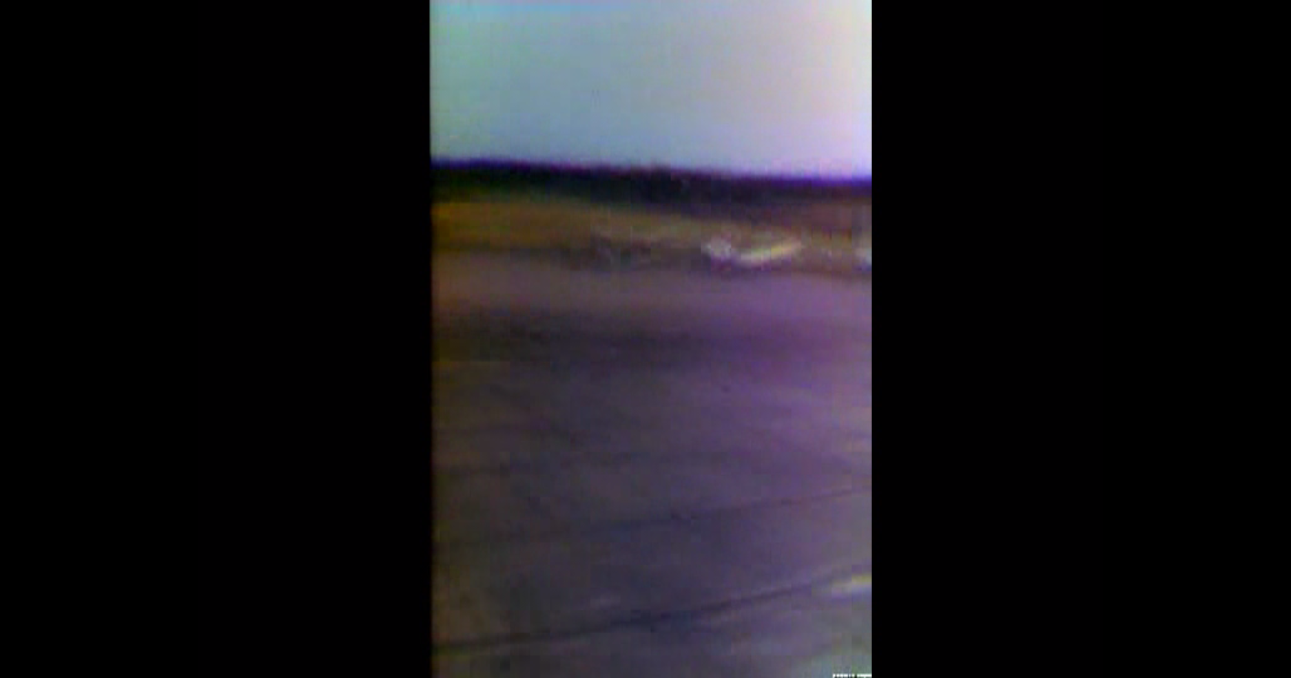

  1. I have a ripped dvd VOB and its aspect ratio is messed up, it is taller than it is wide, it's like reverse 16:9. I don't know how it got like that.
    I don't know anything about these things. What is the simplest way that I can fix this? If even possible?
    canada
    Upload a short clip of the file so we can see the problem.
  3. Probably Half D1, 352x480 or 352x576 (valid for DVD). Either the VOB or the IFO that referred to it should have the correct DAR. If not, remux with the correct DAR flat -- should be 4:3. Or encode with DAR/SAR flags. Or resize to the correct DAR and encode square pixel.
  4. Image
    [Attachment 49371 - Click to enlarge]
    This is what it looks like.
    I dont know what any of this means:
    Is there an app I can download and fix it?

    That's the way the video was recorded and there's nothing you can do to fix it.
  10. Originally Posted by EricBalir View Post
    In the DGIndex app it says the aspect ration is 4:3, but when I play , it's not.
    Yes it is. The black pillarbox bars are part of the 4:3 picture. Though, maybe it should be 16:9, not 4:3. Maybe even 2.21:1 (legal for MPEG 2 but not for DVD).
    Frame stretched to 2.21:1
    [Attachment 49374 - Click to enlarge]
    The wheels on the truck most round at this AR.

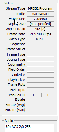

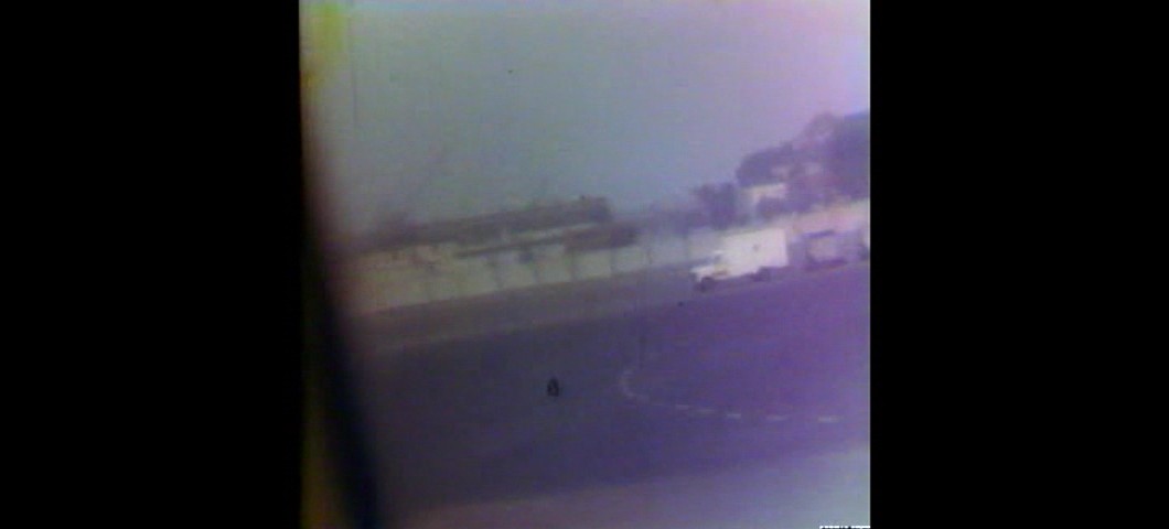

  16. Image
    [Attachment 49382 - Click to enlarge]
    I don't know what the original aspect ration was, all I know is that when I threw in the DVD, it filled out the whole screen wherever I watched it, and I saw it exactly as the original film. Normal.
    That's all I want to see it on the full screen and not distorted like before
    I have attached a new clip with a good view of the tires. But you can also see how the station wagon is compressed.
    Also see the attached image of the properties that DGIndex gives.
  17. There may be have been a Sequence Display Extension on the original DVD indicating the 4:3 DAR is from the inner 352x480 of the 720x480 frame.
