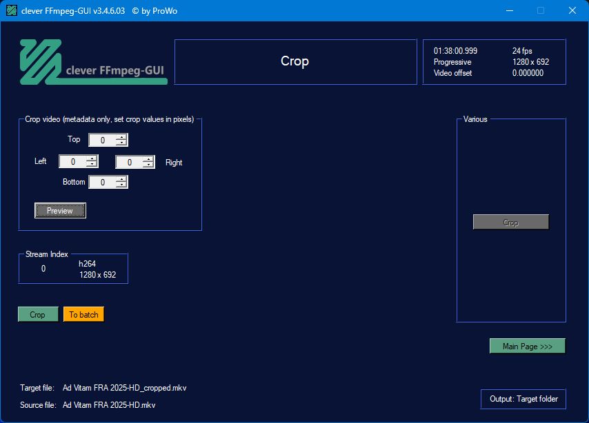

  18. You can use clever FFmpeg-GUI.
    It can change the metadata only for h264 and hevc videos.
    Not all video players honor the changed flags.
    Load your file, click main page, click various, click crop.
    Make your settings, check with preview, if it's fine, click crop.
    A new file is generated, with streamcopy, no quality loss.
    [Attachment 88949 - Click to enlarge]
