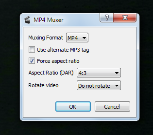

    Hi... I have tried Avidemux for the job, flagged the interlaced lossless AVI input footage as interlaced in Avidemux's x264 configuration... but the MediaInfo showed the MP4 output was progressive afterwards. Please tell me if you need any other info on the specific case. Or just to try another software maybe?
    Aug 2013
    Central Germany
    We would certainly like to see that MediaInfo report. Best in full mode which describes a possibly used interlacing mode more detailed.
    The x264 encoder is capable of encoding video in interlaced mode, it uses the MBAFF method. Avidemux may not reveal many details about conversion interna (except it writes a log file, what I don't know), we can only hope that it stores the x264 core parameter set in the video stream so MediaInfo can quote that.
    But if you use a converter which uses the separate x264 CLI encoder, it may log its full command line string as well. MeGUI / StaxRip / Hybrid may do that.
    Alternatively, you could even use VirtualDub2 as a most simple application.

    Though my input was huffyuv YUY2 and AviDemux converted to YV12 incorrectly resulting in the colors of the two field being blurred together. I didn't see any settings to correct that in AviDemux 2.7.1.

  6. Apparently you didn't specify interlaced. interlaced=tff or bff is not in your x264 encoder settings metadata like it is in mine.
    Even if you fix that avidemux will screw up your colors. I wouldn't use it.
    Mar 2014
    PALaland
    Thanks.. what do you suggest anyway? I need to have a software that has the option to set the enforced DAR for MP4/x264 and Avidemux has it (see the pic below). That was the only reason I ended up using it, for any other tool I've checked for the option, it's not (visually) present (VidCoder, Handbrake and more than half a dozen of others). Obviously I'm trying to find something that works with no need to use command line-like parameters.

  8. I use AviSynth scripts for processing (eg, convert YUY2 to YV12) and the x264 command line encoder. Sometimes QSVEncC or ffmpeg. But they're all command line encoders.
  9. I just tested with RipBot264 and it can do it:

    The only change from my usual settings was to specify interlaced:

    Thanks manono, gonna try it now. Meanwhile I also tried TMPGEnc Video Mastering Works (same input file) and thought it was excellent cause it had everything to set as I wanted, but alas the info file shows something unbelievable, that the output is NTSC and PAL now at the same moment (it is PAL avi, as seen in the post above)... oh dear. Browsing thru the app's settings to no avail, can't see anything where it could possibly have gone wrong.

  17. No, they work, they all have advanced options, setting interlaced encodings or setting SAR for a video stream, Ripbot, Staxrip, VirtualDub2 and pretty sure Hybrid as well
    In advanced sections as for "enforcing DAR". You cannot enforce DAR in a stream, you are enforcing SAR if encoding anamorphic video, that is how it operates in "manual mode", which is a fraction that multiplies fraction of your resolution and it gives you DAR while playing that stream on screen, for example:
    720/576 x SAR = DAR
    720/576 x 16/15 = 4/3 = 1.333
    So you'd add SAR in advanced x264 options as: --sar 16:15 , it is direct command line option with a argument
    Also x264 encoder (all above GUI's work with that one) has --tff or --bff option in advanced section for x264 encoder.
    MeGui has a dedicated button in settings for interlaced encoding and to set correct DAR it tries to figure out SAR itself. Which should not be a problem for 720x576.
    What could be done , is simple:
    I have this GUI encoder, how do I set up interlaced encoding or how do I force aspect ratio to have DAR xy while previewing and also provide your video resolution you had.
    Then you'd get answer for particular recommended software.
    As a note, you set these for video stream, in x264 video settings, NOT to mp4 muxer.

    Originally Posted by kodec View Post
    These are options for the MP4 container.
    But interlacing is not an attribute of the container. It is an attribute of the content. Try to configure the x264 codec, not the MP4 container, to find interlacing options.
    In the end I've learned how to do it command line in VDub2, also without changing the color depth in the process. Thanks everyone.
