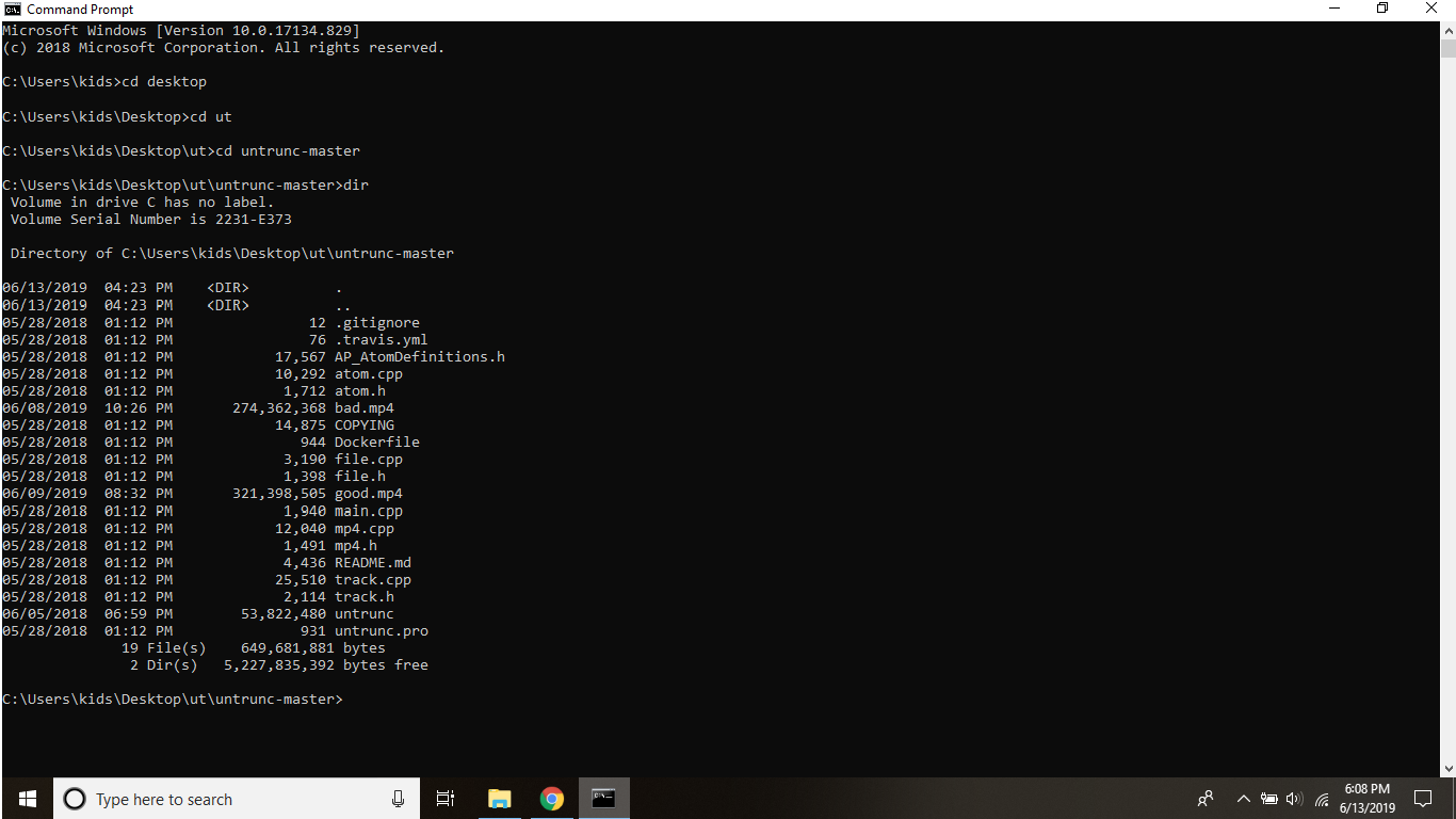

    ok ive tried exactly what you just said and this is the error message, '.' is not recognized as an internal or external command, operable program or batch file. what does this mean and how do i fix it assuming u might know.
    Mar 2008
    See this screen shot for some help in navigating around the folders, perhaps it will help.
    I used the "dir" command to display the folder contents. You can see the executable
    as well as some media files
    If not, produce your own screen shot showing the command window as I have done.
    I used the program "shutter" to create and save the screen shot,not sure what your distribution has...
    you can always resort to a photo from your phone if you need to
    Did I mention I'm also a Linux novice?

    so this is what i get. the dir command works, tell me what to do from here.

  22. Member
    Mar 2008
    Are you running it in Windows 10 ? I don't think that will work
    unless you found a Windows version of untrunc
  23. Member
    Jun 2019
    Illinois, United States
    well im trying to use windows.. dont think its really working out. dont want to install linux just for a couple mp4's but i also really want these mp4s.
