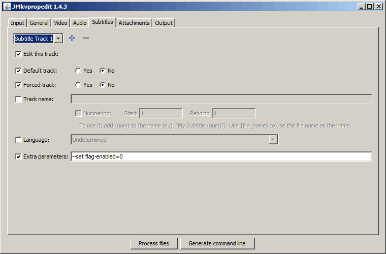

  12. MKVToolNix 19.0.0 is the last version compatible with MKVBatch.
    Though batching "by hand" isn't that complicated:
    for %%a in (*.mkv) do mkvmerge -o "output\%%~a" --no-subtitles "%%~a"
    You could also try to disable the tracks instead of removing them. It is very fast (in-place) and you can re-enable them at a later time. I don't know if Plex obeys this flag, though. There's even a GUI (jmkvpropedit).
    [Attachment 49352 - Click to enlarge]

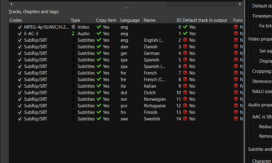

  15. Member lordhutt's Avatar
    Jun 2004
    Originally Posted by butterw View Post
    With mkvtoolnixGUI: you just open the mkv (drag and drop one file at a time) and manually unselect the subs you don't want to keep and then remux (Start multiplexing).
    You want to be make sure you've removed the right subs: check the output before deleting the source file.
    It may be possible to do this with a batch script.
    Hey... sorry, I should have been more specific. I know how to do it manually... I do it with single files on a regular basic.
    But for this particular situation I may have a couple hundred to do it with... each with about a dozen subs each.
    I was hoping there was a more automatic way... keeping only the English ones.

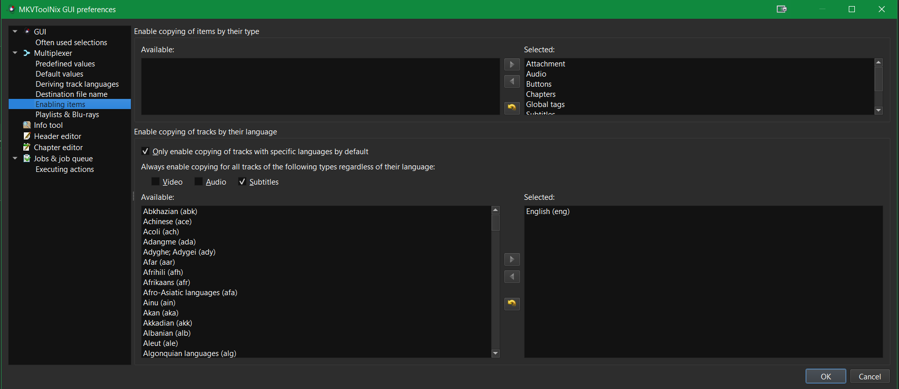

  16. Originally Posted by lordhutt View Post
    I'm not even sure how to start on the adding or appending files popup
    Do I select
    'add as new source files to the current multiplex settings'
    No. That's the setting for combining files, e.g. you want to combine video from file 1 with audio from file 2.
    Maybe you want something like this:
    1. Preferences>Multiplexer>When dropping files>Create one new ... for each file
    2. Preferences>Multiplexer>Destination file name. Set an output directory. (optional)
    3. Preferences>Multiplexer>enabling items. Tick "only enable copying ...". Then in the bottom move English from the left to the right field.
    4. Drag&Drop all your mkv files
    5. Multiplexer>Actions for all tabs> Start multiplexing
    Or with CLI:
    for %%a in (*.mkv) do mkvmerge -o "output\%%~a" --subtitle-tracks eng "%%~a"
  17. Member lordhutt's Avatar
    Jun 2004
    Definitely seemed like that would work but when dragging over a couple test files... everything is still selected.
    [Attachment 56016 - Click to enlarge]
    [Attachment 56017 - Click to enlarge]
  18. You ticked the wrong options. Should be e.g.:
    [x] Video [ ] Audio [ ] Subtitles
    An "[x]" means to ALWAYS copy, ingoring the language selection below.
  19. Member lordhutt's Avatar
    Jun 2004
    Haha, yep, that got her!!
    A million thank yous. Like I said... I've wanted to know how to do this for a long time.
    Take care, and thanks again!!
