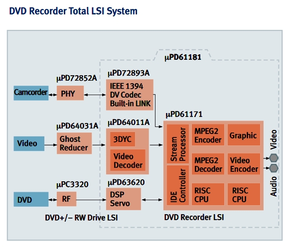

    AFA the XS series Toshibas, I own a working XS-35 Toshiba(don't know who made the silicon) and it makes fabulous recordings, basically the best DVDR I've used(as far as picture quality) and like Citibear said it's editing features are second to none. Unfortunately, I don't really use it as I'm paranoid about the DVD burner failing, it already refuses to burn to RAM discs even though it's supposed to but it burns to R discs just fine, well the little I've ever used it. I agree that if you don't already have such a recorder, trying to purchase one at this point of time is probably not the best thing to do unless again you plan on using the methods he mentioned about trying to bypass the built-in burner, something I'm not really interested in.
    Feb 2018
    College Station, TX, USA
    RD-XS32 / XS52 uPD61171F1 10-Bit 4:2:2 w/Time Base Corrector
    RD-XS34 / XS54 uPD61181F1 10-Bit 4:2:2 w/Time Base Corrector
    RD-XS35 / XS55 uPD61181F1 10-Bit 4:2:2 w/Time Base Corrector
    All NEC chips
    The RD-XS32 used the µPD61171.
    The RD-XS34 used the µPD61181 based on the µPD61171.
    [Attachment 53285 - Click to enlarge]
    from the NEC Digital Consumer brochure
    2003 Press release for the uPD61171
    2004 Press release for the uPD61181
    MPEG2 Audio & Video Codec µPD61171
    MPEG2 Audio & Video Codec µPD61181
    Time Base Correction, Pg 17
    (3) Time base corrector (TBC) is a frame-type TBC. It is possible to make stable encodings of video with interruptions due to channel changing and unstable video signal sources such as VTR.
    (4) Noise reduction The noise reduction of the luminance signal and the color signal can be set separately to three levels each.
